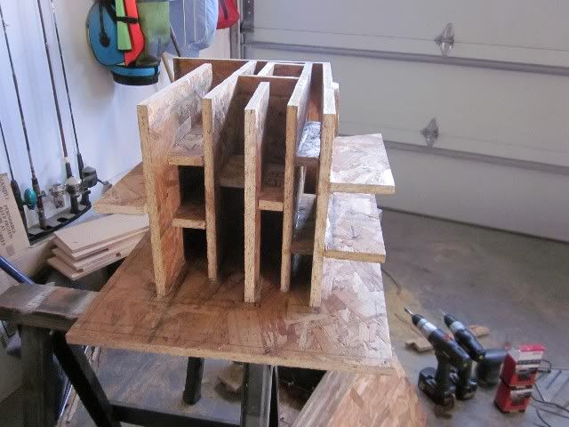

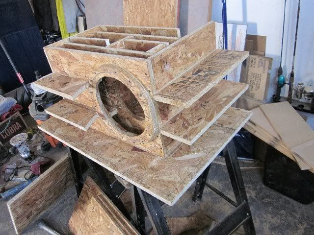

I'm currently building a modified one of these for a Dayton Titanic 10". Modified for 3/4" material and again to turn the driver the other way because the magnet end wont fit in the throat.
