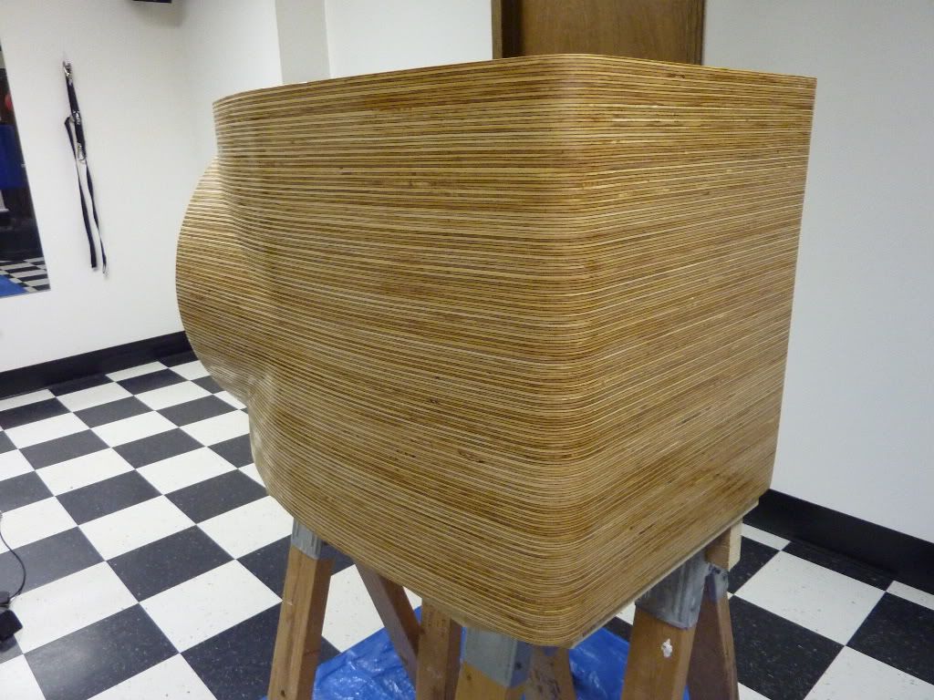

have you seen how plywood edges take stain? especially with all the wood filler on it.
I would drop this thing off at a local auto body shop and have them spray it and throw a clearcoat on top.
if you do stain it, I would pre treat it with wood conditioner.

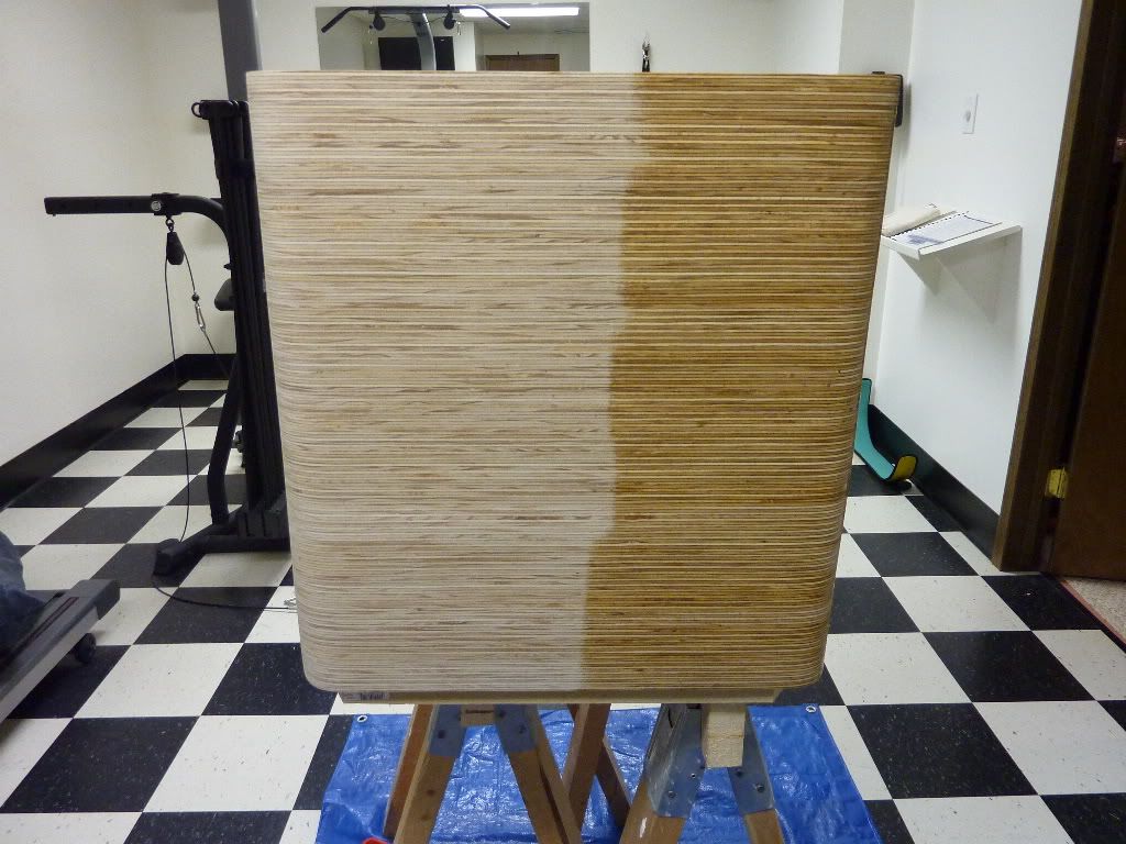

post #278 of 743 Old 05-11-2010, 08:20 PM - Thread Starter
corock's Avatar
Posts: 281
I'm going to seal it with epoxy. One coat of epoxy soaks right into the wood and gives it the color I want. Then its going to a local furniture builder to be sprayed with lacquer.
corock is offline
post #279 of 743 Old 05-11-2010, 10:10 PM - Thread Starter
corock's Avatar
Posts: 281
One coat of epoxy.
corock is offline
post #280 of 743 Old 05-11-2010, 10:30 PM
Ezcl's Avatar
Location: Oregon
Posts: 199
I like! The untreated ply looks so washed out compared to the epoxied version, hahah.
What is laquer? Just a clear, glossy coat? Orr...
"Measure twice, then measure again. Only then should you even THINK about cutting."
Ezcl is offline
post #281 of 743 Old 05-12-2010, 09:16 AM - Thread Starter
corock's Avatar
Posts: 281
lacquer is a type of varnish. It can be colored, clear, glossy, matte, whatever you want it to be. In my case it will be a clear gloss top coat.
corock is offline

post #283 of 743 Old 05-12-2010, 09:59 AM - Thread Starter
corock's Avatar
Posts: 281
the first coat of epoxy soaks right into the wood, then I squeegie off any left on the surface, so there is nothing for air bubble to form in. If I was to do a second top coat that would have bubbles in it. That's why I'm getting lacquer sprayed.
I've experimented extensively with epoxy and I can't defeat the bubble problem. I also tested a little with spray polyurethane and decided this is not the project I want to learn on.
The epoxy gives the wood the color I want, plus it will add some strength and moisture barrier to the plys. That's why I decided to just seal with epoxy instead of staining or tinting.
corock is offline

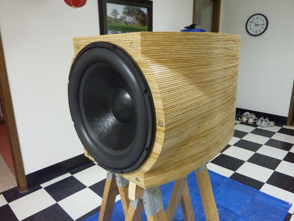

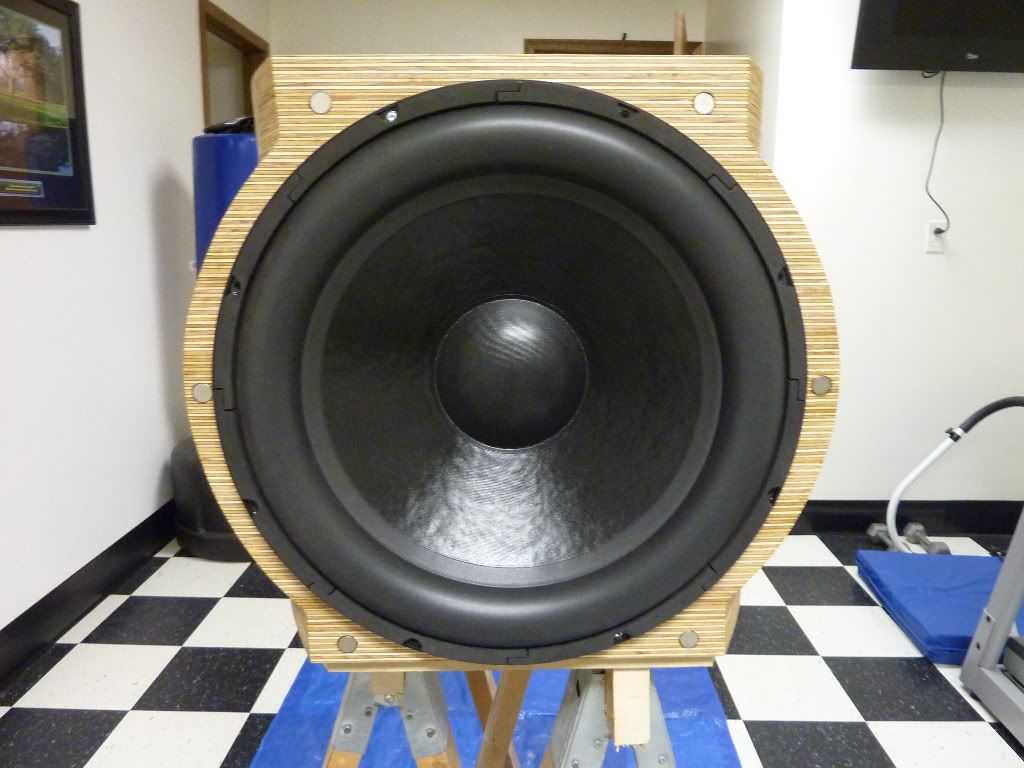

post #300 of 743 Old 05-13-2010, 10:49 PM - Thread Starter
corock's Avatar
Posts: 281

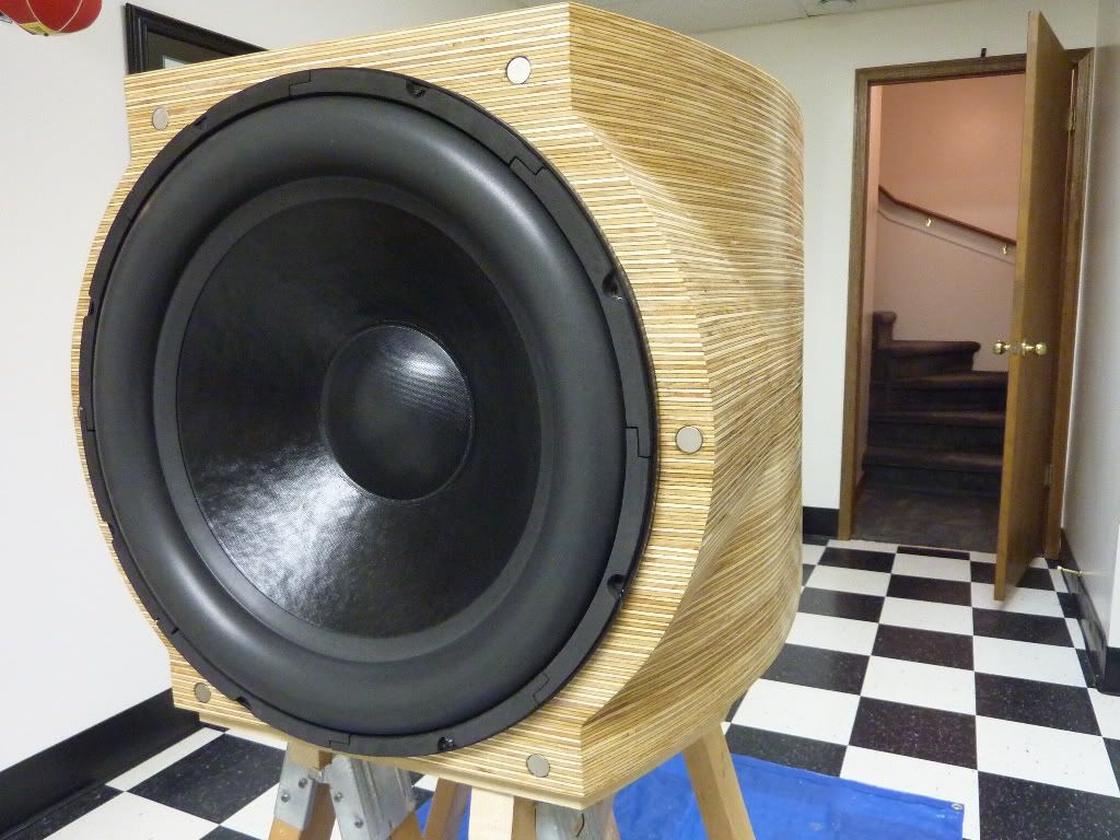

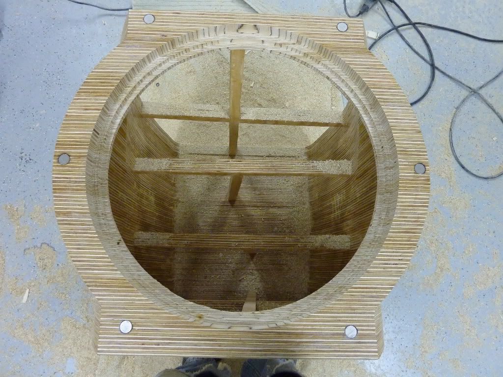

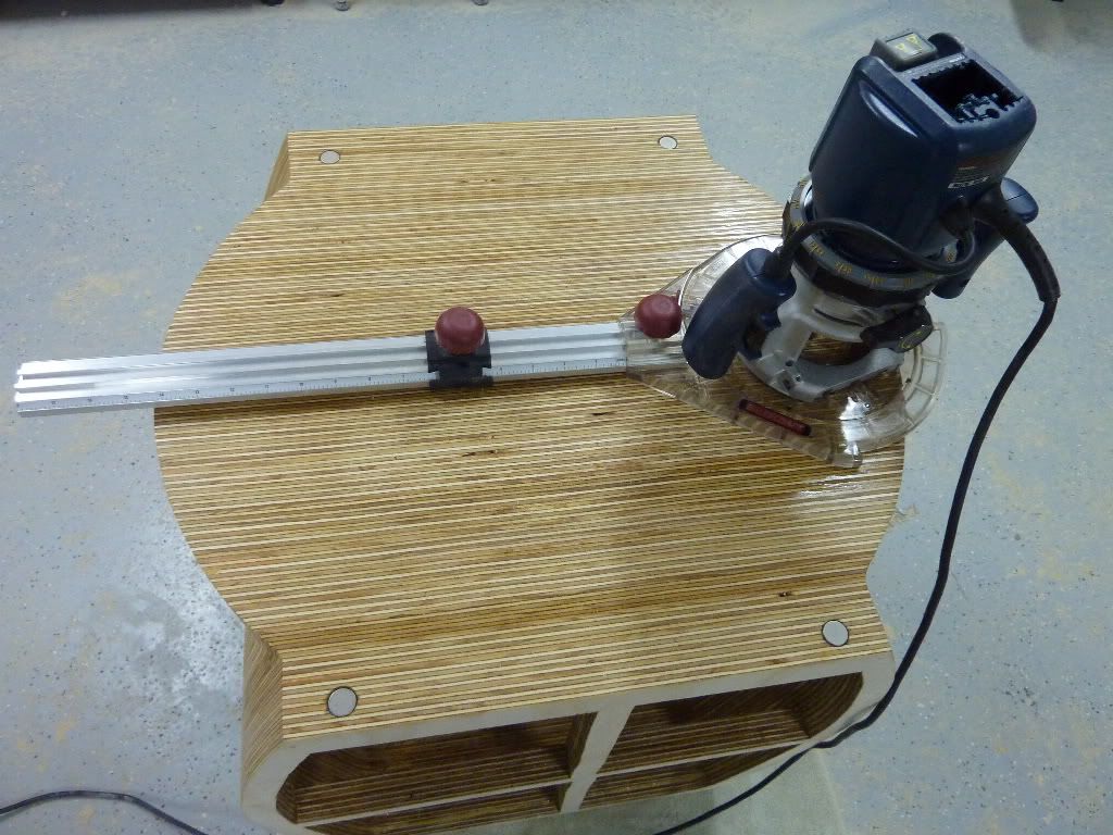

Nervous?...Who me?
I had to bring out the big guns to get down 2"
I was right, the cut out weighed 10lbs. The wood portion of the enclosure officially weighs 54lbs.
Here's the first glance at what it looks like with the driver installed.
corock is offline
