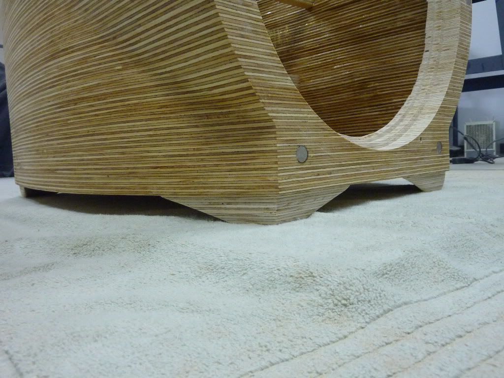

Those feet look really nice.
How did you shape them?
The only likely way to damage them that I can think of is if you were sliding them and hit a protrusion.

Thanks Noah,
I brad nailed a couple of squares of plywood into the base so that I could hold it in a vise. Then I carved it with an angle grinder with a sanding wheel.

Originally Posted by corock View Post
Thanks Noah,
You did it freehand?!
Good job, you're a craftsman, as opposed to a mere tool user like me.
Noah
noah katz is offline
post #364 of 743 Old 05-18-2010, 12:41 PM - Thread Starter
corock's Avatar
Posts: 281
Yes I did it freehand. That also means its not perfectly symetrical, so each foot will be "unique".

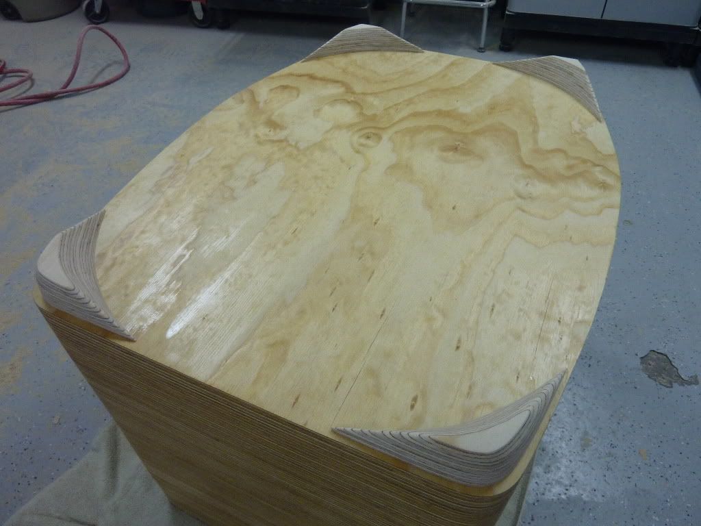

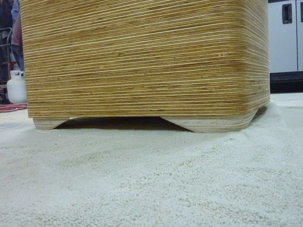

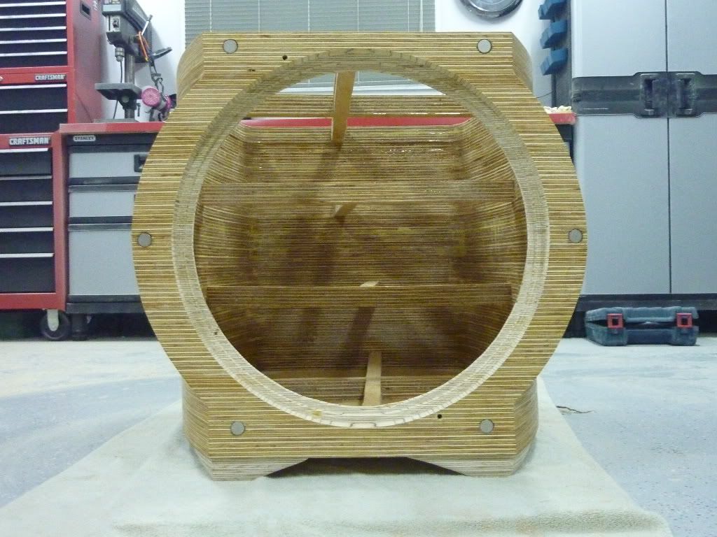

All 4 feet are done and I'm pretty happy with how they look.

You could not have picked a better design for the feet imo. Perfect.
Very nice. I like them as they are, but do wonder (as Detach50 hints at) if you tried them flush with the side / front / back edges and not inset?

I prefer them inset a little bit. I think it adds a little depth and had more visual interest.

I like them inset a bit too. Gives them extra style. Will they get epoxy on them or another color?

I like the feet, but my vote is that they be mounted flush with the edges of the sub.

"All 4 feet are done and I'm pretty happy with how they look."
They look great!
Nice as they look on their own, there's a visual synergy I didn't expect when under the cabs\\.
I also like them inset.

I am going to leave them inset. I thought about putting them flush but that would require mounting them then sanding 'em and the cab to make it like one. Since the cab is already sealed I have no interest in sanding it again. I'm also going to seal them with epoxy so that they are the same color as the cab.
The feet are not going to look quite that good in the front because there will be a face plate (you mave have noticed the magnets). So they'll be set back from that which will kill the symmetry a bit, but I don't think there is a way around that.
The granite top is going to be the hold up because I can't even make a template for it until I have the enclosure finished so that I have exact measurements. I personally don't see the point of hooking it up and driving it without the top plate because that's not what its going to be like in the end anyway.

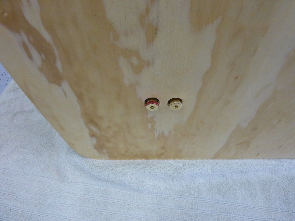

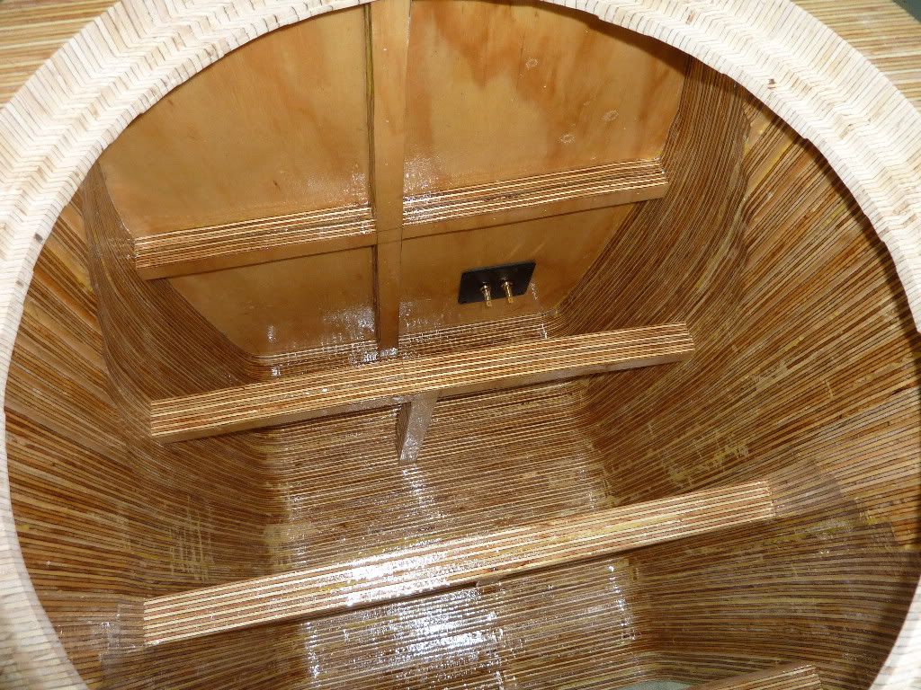

Posts: 281
I designed it with using just the granite as the top plate; the cabs dimensions are drawn up that way. I didn't even consider putting a full board underneath it. I was focused on maximizing the internal volume within certain specs and sometimes the obvious escapes me. I'll forge ahead as planned unless the granite guys tell me they can't get a seal between the granite and wood. I don't have any experience with it but I assume since granite is a flat surface and you can get a strong bond to it, that would create a seal. As well the giant hole in the front will give me enough room to epoxy the seam between the wood and granite.
The binding posts are ready to rock.

Did you put those posts on the top? I guess you'll have holes cut into the granit to match?
I'm guessing thats the bottom, since he doesn't have the top on yet.
no, he just took a picture of the enclosure upside down. If you look at the pic looking down into the sub you can see that it's open at the bottom of the picture

So the feet give it clearence. OK. I get it now.

The internal volume wouldn't change but the external dimensions would. I designed this from day one to maximze the interval volume while keeping within certain external dimensions. Adding another layer of plywood would increase the distance between the curvature of the cone and the top of the box. It wouldn't be as aestetically pleasing to the eye. I originally went from 34 layers of plywood to 32 just for this reason. I could remove the very top layer and replace it with a full board, but that would be a ridiculous amount of work.
It may seem like my only focus is aestetics, but that is not the case. I'm working on the principle that one 7 cu ft sealed cab will sound just like the next. When I decided that I had to go with a 7 cu ft sealed enclosure (the smallest you could go with the driver IMO), I was determined to make it the nicest 7 cu ft sealed enclosure I could.
Being able to take the granite off to move it would be a nice feature, but probably one I can live without. I'm hoping that sealing the inside seam between the box and granite with epoxy will prevent the silicone from being blown out. I wish I had thought of the full board on top to seal it earlier on but I think its too late now.
The posts are sticking out the bottom and the feet give me enough clearance for banana plugs
