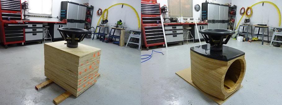

I took a few minutes away from working on the face plate to stage a before and after pic.

who ever cut that stone did a really nice job. you owe him one.
time to finish it up. this build is getting a little long in the tooth. ;-)

i feel like this is one of those double image games where you have to find the differences. Let's see. (1)the wood is different. (2)There is a clock on the wall. (3) the drawer is closed on the tool chest. I'll let others finish it. There isn't much left though.....very very organized lol.
Btw....i'm still in awe with this build. I only wish I had a sliver of your patience.
mike
p.s. what is the yellow rainbow looking thing on the wall?
mike
OH OH!! The yellow extension chord is wound a little tighter, and there is a blue air hose on the floor (it looks like an air hose...)

Also the miter saw is missing.
I think it's a net for practicing your short game.
Yes his patience and his works space are both incredible !!

You guys missed that I set my Pepsi down is a slightly different spot.
Mike, your input was greatly appreciated and implemented throughout the build.
The yellow semi circle is a golf driving net. I can use my irons in the garage during the winter, if I want to practice my woods though I gots to go outside.
