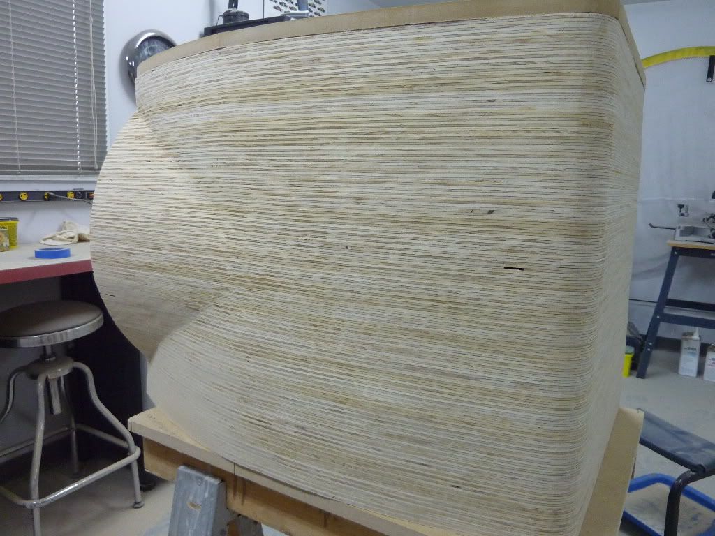

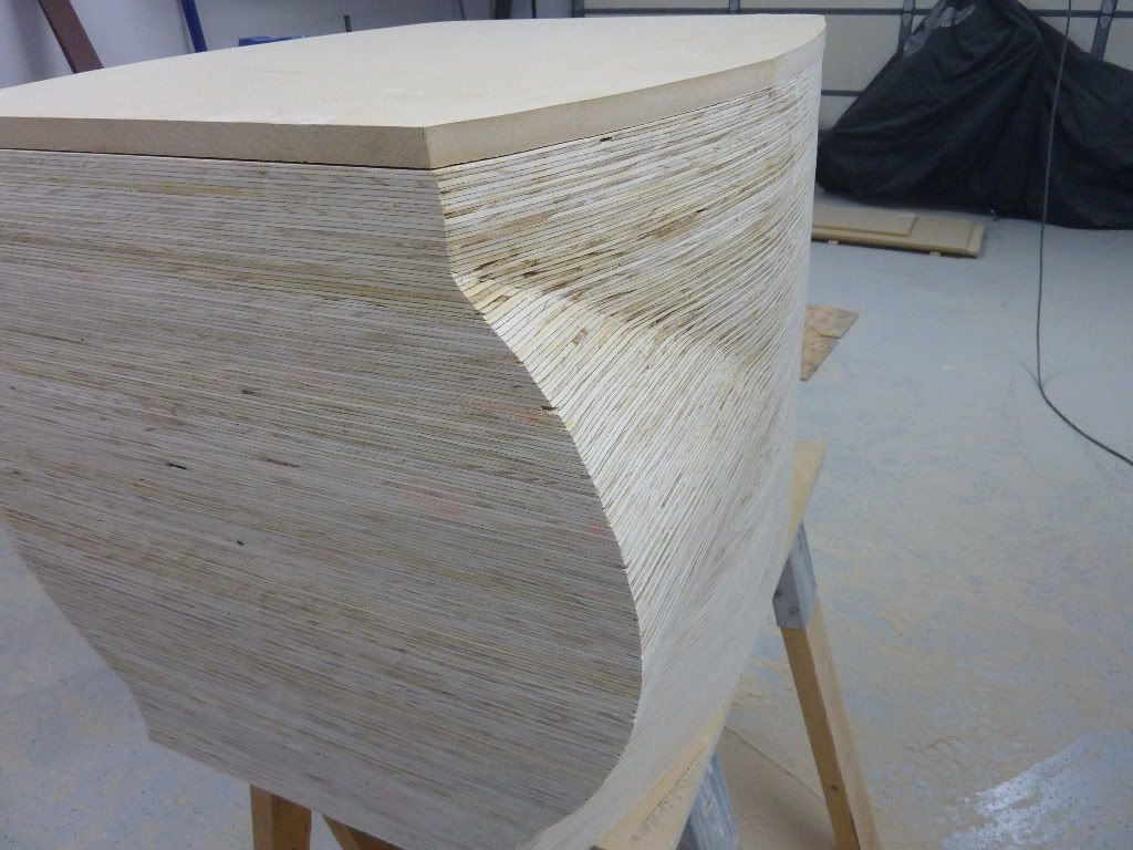

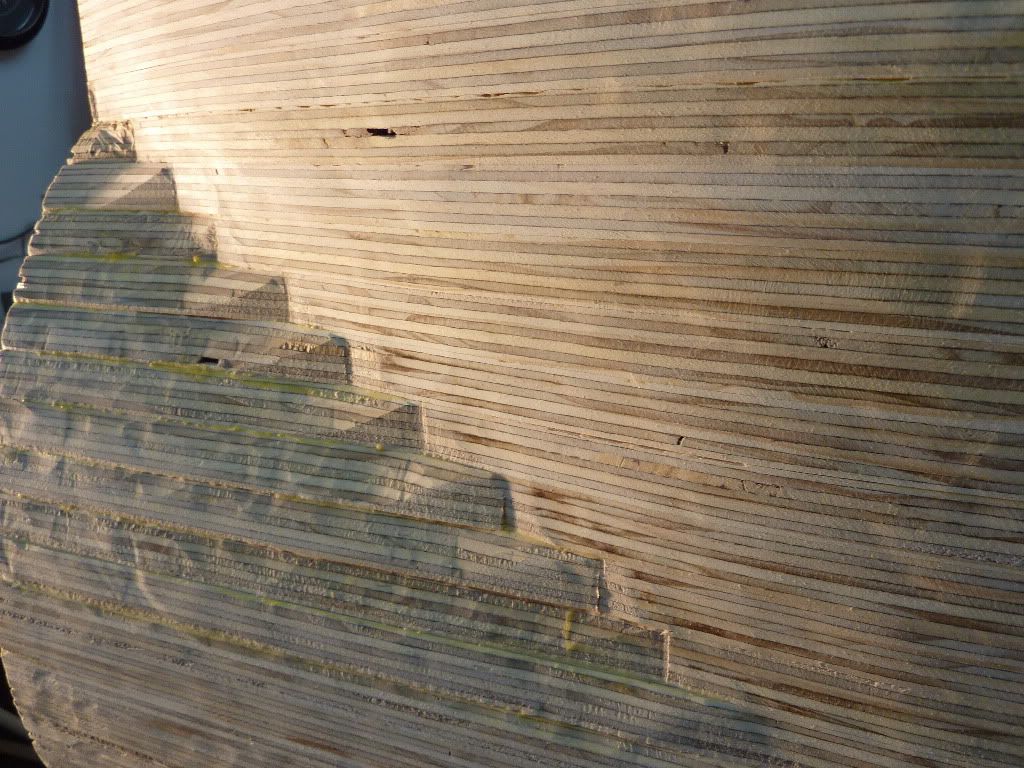

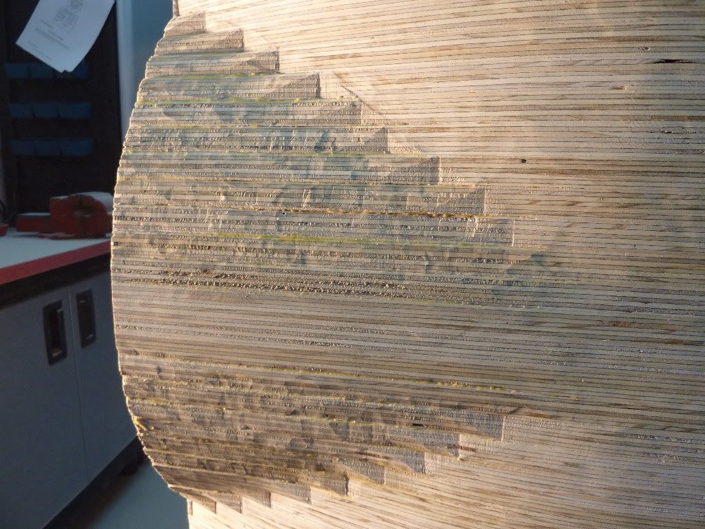

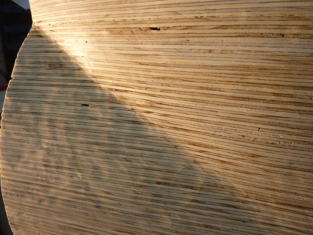

I made the necessary adjustments to allow a top plate of alternative material to be mounted onto the enclosure. I cut a couple new cross braces sans top plate and attached those to the box and epoxied them to complete the wood portion of my box.
It was time to start the sanding stage. The initial sand was like carpet bombing a city before sending in the ground forces; weapon of choice an angle grinder with a 60 grit sanding wheel. Getting rid of the excess wood where the cube and cylinder meet was way easier than I expected. I was able to do it with the angle grinder. I just kept blending the two shapes until they met and it naturally took shape.
BEFORE
AFTER
Now that the enclosure is closer to its finished state I have to admit it is a really beautiful shape; I'm quite happy with it.
