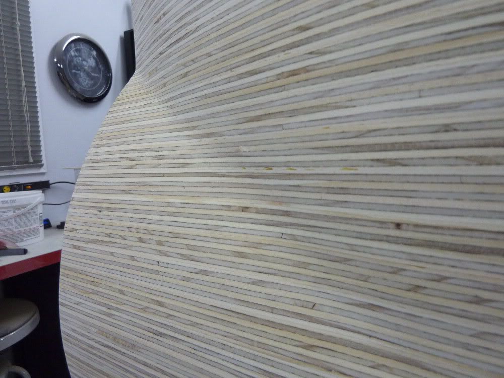

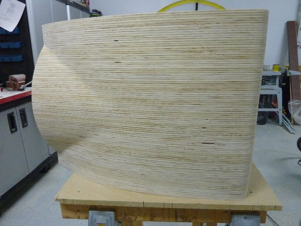

Finished pics? You either over estimate my ability and available time, or under estimate the work involved with this. I'm still a ways away from finishing, but here is where I'm at. I've finally finished shaping and contouring the enclosure. The trickiest parts was getting the line formed by the intersection of the cube and cylinder to be straight. As well getting the top and bottom lines to be mirror images of each other. Now I can do the fine sanding to remove the scratches and smooth the surface.
corock is offline
when I was cutting yet some more circles with my jigsaw on my wall today, I thought of this build. I've only cut 4 holes per wall board, 5 wall boards... 20 cuts... plus double cut one to make it counter sunk.. up to 25 now... cut out my front stage, 8 speakers, and again for a double baffle.. 16 total there.
But that ain't CRAP compared to this! I, my friend, do NOT underestimate your work and your progress here. I know full well what it's like to work for hours, take a few pics, post them, and it looks like not much got done.
PROPS! Lookin good man!

For you media junkies, here is a 360 deg walkaround of the enclosure. The mdf top plate is just a stand in for the granite.

Posts: 1,756
First off: Thanks for the video fix. I feel much better now.
Second: That sub is looking fracking impressive. Can’t wait to see the finished product.
Third: That’s one h.ll of a work room you have there. I kept playing the video over and over checking out all your equipment. Nice and clean too.
Fourth: I’ve decided not to post any pictures with my build thread. After this one, I’ll just feel embarrassed.
