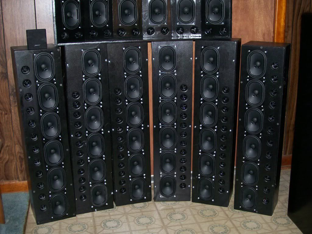

Yep they sound great and are cheap here are my SLAs
snickel is offline

Andreas and I have been talking with PMs. I think we should talk here it could help other people. Andreas I would just go ahead and build the TLAHs for surrounds and see what you think, they are cheap to build so just try them
snickel is offline
post #24 of 49 Old 05-29-2010, 12:06 PM
snickel's Avatar
Location: South central Kansas
Posts: 1,159
Cliff notes on Andreas and my conversations. We both have small home theaters, I find my SLAs are so directional for surrounds that they only work good at my seating position. I am single so they work good for me
snickel is offline

hmm the horizontal dispersion is the same as a single speaker? I have my SLAs pointing at me, maybe I should turn them more 2 the center of the room
That's what Bill said: http://www.avsforum.com/avs-vb/showt...n#post18022491
He said it elsewhere too if you look up dispersion. Let us know if aiming them differently helps. I know the vertical dispersion is less the longer the array. That and the fact that the surrounds are much closer make me think that a 4 speaker array might be what I want for surrounds.

They sound good to me but when i have friends over they can't hear the back 4 speakers cause they are aiming at me. I will move them and see what I think
