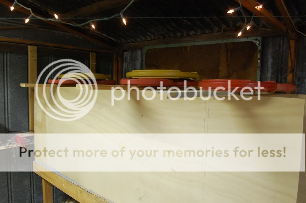

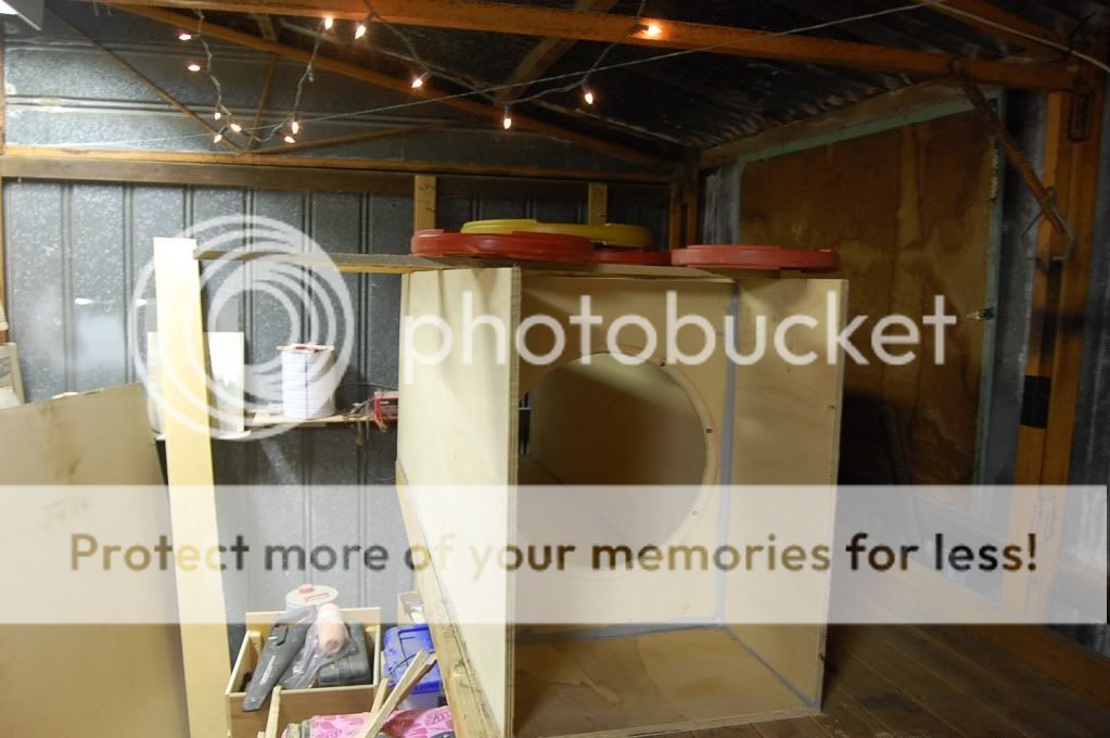

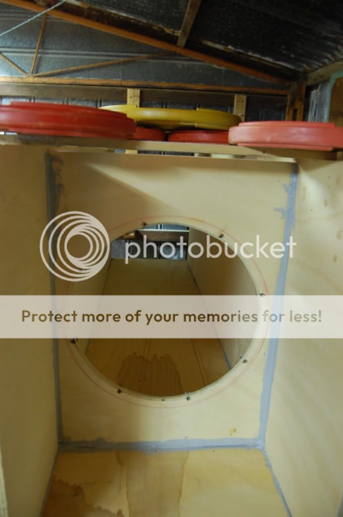

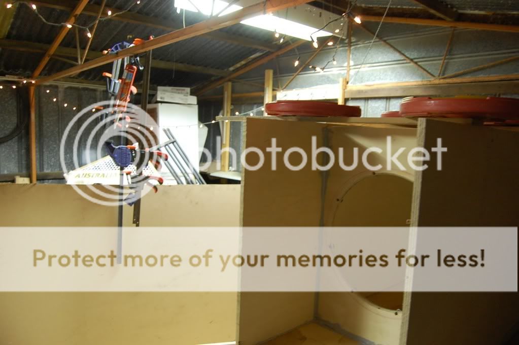

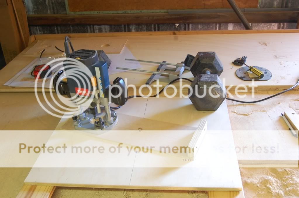

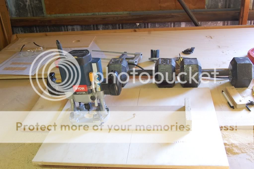

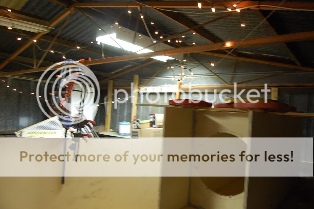

Well I finally was able to upload some pics.
Oh yah I forgot to mention when I was using my circular saw to cut my Sla's I cut alittle to much:
I was told by Brad I would need 13 7/8 hole cut out. So I measured 6 15/16 and used a bolt to hold my router in:
I was off because I measured from the very edge of the outside bolt to the outside of the router bit. And I forgot I was pivoting around the bolt which made my circle about a 1/2" short. So that was a fun episode of freehand routing a circle.
Anyways I got started o gluing the first panel and could never get the panel straight. It even fell over completely when I left for the glue to dry.
I ended up using panels 2/3 to hold panel 1 in place. I also used brad nails(finishing nails). I then only had a few clamps so I just used 3 guide boards to hold the panels 2/3 up and apart at the right distance
I have finally loaded the glued panels back into my shed/garage. and man that thing is heavy and very awkward. Especially with the guide boards hanging out further than the sides.
Here are some more pics of how it is now. I just used some weight s I have to help put some pressure down on the glued panels. We bought this house we live in now in January and the previous owner had these lights in the shed and I never felt like taking them down.
Well, done for now but cant wait to glue some more.

chrapladm,
You may want to double check the plans. The top edge of panel 1 should be flush with panels 2 & 3 (as should all of the vertical panels). The top of your panel 1 is shorter for same reason. Don't know if you have already cut the remaining vertical panels, but they either need to match the height of panel 1 so that the final side panel lays inside of panels 2 and 3, or you'll need to plug the gap at the top of panel 1 somehow.
-Darrell

Originally Posted by darrellh44 View Post
chrapladm,
-Darrell
There is a gap because of my 1/4 here or there off cuts with the circular saw. Most of the other pieces are all pretty close to 23.5". The worst off cut was panel 1. I was going to try and buy some more wood to try again but cant afford it. SO I was going to try and split the difference between the bottom and top to get rid of the gap but forgot to do so while getting eaten.
I have almost a 1/4" gap on the top. Probably a little less. I could wait till everything is placed in and when the last panel goes on I would just seal the gap with the poly glue and brads. Or I do have some scrap sections of plywood that I cutoff the baffle to make it fit in the "drawing." It might be 1/4" I will have to have a look.

micagreenmachine's Avatar
Posts: 79
Oh yah and another thing. It says to breakin the driver but honestly I dont have anything that will play 10-15hz. for 30 mins or whatever it is needed.
I haven't used it in a while, but if I remember correctly, REW will play test tones of any frequency. You should be able to use that to break it in...
micagreenmachine is offline
