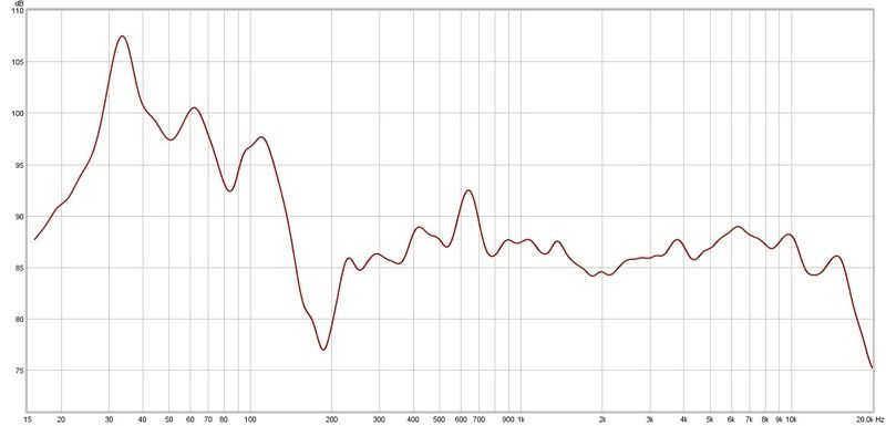

So I think I finally got REW and was able to get a graph so I can start using my minidsp to smooth out my bass response. Looks like I do have some serious issues with peaks and nulls. When I imported REW into my 2 way advanced it didnt seem to do much at all. Do I just need to adjust it manually or should REW & the minidsp being doing most of that automatically? How do I decide my target SPL? I am a super newbie when I comes to this. Thanks for any help
that's alot of bass :P that 200 dip is probably a reflection off the floor
Do you have any way to EQ the response above the bass region (i.e. Audyssey)?
You should be able to bring down the peaks in the bass region pretty easily with the MiniDSP + REW EQ tool, but that huge suckout at 200hz is your mains (if this measurement is subs+mains). You will have to move them in order to improve that. I would suggest pulling them away from the front wall a foot or two and re-measure.
I have the Umik set up on the center seat of the 2nd row at ear level.
Is that your MLP??

[QUOTE=neverfinished94;40749010]So I think I finally got REW and was able to get a graph so I can start using my minidsp to smooth out my bass response. Looks like I do have some serious issues with peaks and nulls. When I imported REW into my 2 way advanced it didnt seem to do much at all. Do I just need to adjust it manually or should REW & the minidsp being doing most of that automatically? How do I decide my target SPL? I am a super newbie when I comes to this. Thanks for any help
It is not clear from this post what you did with REW. There is a section in the 2x4 guide linked in my sig that describes how to use the REW EQ tool to create filters that can then be imported into the 2x4. If you didn't see any difference, then I am not sure you followed the procedure correctly.
Is that your MLP??
That measurement was with Audyssey. I will take a measurement without Audyssey to see the difference. Yes, that is my MLP.
The graph is without the change made by the minidsp. I will post the comparison graph pre & post minidsp hopefully tonight.
neverfinished94 is offline

Here is the graph. Green is with the minidsp & red is without. I didnt know what to set my target spl at so I set it at 102 db. Dont ask why
Wow, a 30dB difference between the level at 30Hz vs. the level at 200Hz? Not good. That must sound pretty bass-heavy. The difference between the two curves is insignificant. Are you sure you are running the REW EQ tool properly? Perhaps you could share some screenshots of REW with the settings you are using.

So I moved my mains about 10-12" forward and it helped the issue around 200hz. Green is before and black is after.
So I wanted to see what Audyssey was doing so I turned it off. Black is with Audyssey and purple is without Audyssey
I agree with Jerry...it looks like the EQ in the MiniDSP is basically doing nothing. Those three giant peaks in your bass response should have been pretty easy to flatten out. Show us a screenshot of the EQ window and filters you are using.
I also agree with Jerry that a 20dB boost for the subs is insane (and I really like bass)...where did Audyssey set your sub trim and where do you have it set now?? EDIT: Your subs are probably only running 10-12dB hot, but that huge spike at ~30hz makes it look like (and I'm sure sound like) more.
For the Target Level, you should just hit the Set Target Level button.
You're welcome.
I would try pulling them out even further to see if the response improves even more.
Are you certain this is Audyssey ON/OFF and not Audyssey REFERENCE/FLAT? That's what it looks like to me.
If it is indeed Audyssey ON/OFF, it seems that Audyssey isn't helping you much (or at all). What version of Audyssey are you using? Do you have any pics of your room (sorry if you've already posted pics, and if you did, point me to them)?
