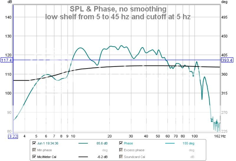

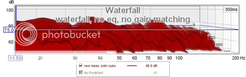

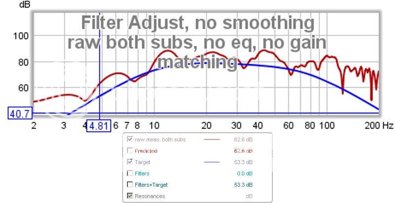

I finally got my IB sub going yesterday.
So far, without any tuning it sounds pretty amazing. Bottom end for days.
Here's the first graphs. Haven't done anything yet to tune (no gain matching, etc.)
I have a couple of questions though. When I go to gain match the two manifolds do I use the 0 degree calibration file?
My subs are in the ceiling, not perfectly horizontal.
Also, on my receiver do I need to have the master volume at whatever level I usually listen to movies and/or music (or do I set it to 0.0)?
My Sub trim is set to 0.0.

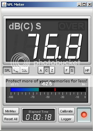

In your guide where you say to set level so that you get 75db at the MLP, do you mean -75db in the "Make a Measurement", then hit the "Check Levels" button?
If it's supposed to be 75db (and not -75 db) then this test tone is going to be super loud (mine is currently showing -35db and it's already pretty loud)!
Does this make sense?

No, it is not making sense to me. "-35" sounds like a setting on the AVR master volume. +75dB is a level measurement, taken with a SPL meter (either the REW SPL meter, or a hand-held meter). +75dB is not very loud. "Reference Level" is 105dB, which is pretty loud.
I am not sure which section of the guide refers to a level of 75dB. If I were to guess, I would say it is referring to the desired sub level measured at the MLP. It has nothing to do with REW measurement levels, which would typically be in the 75-100dB range, most often 80 or 90dB.
If I have't answered your questions, please re-state them and I will try again. BTW, I have no experience with the type of subs you have.

Thanks Jerry. I think I know now where the crossed wires are.
I think this is the ordering.
1) set the master volume of the AVR where I normally listen, -18 typically.
2) play the SW test tone from the AVR setup screen. In the speaker levels section.
3) using the SPL meter in REW, set the gain in the amp so that they are matched, as measured near field, and having a combined SPL of 75db at MLP.
I was looking initially in "check levels" in REW where you play the tone from within there. In that check levels screen you are seeing the db levels in FS.
Mr. Electric Wiz is offline
My AVR (Marantz) has speaker level-setting test tones. However, when the tones are played, the AVR master volume must be raised to zero in order for the tones to be loud enough to accurately produce 75dB at the MLP. Not sure why you are setting the AVR MV to -18, unless your AVR test tones operate differently than Marantz/Denon AVR's.
So, start the test tone, raise the AVR MV to zero, place the REW mic in the MLP at ear level pointed towards the ceiling, open the REW SPL meter, and then adjust the gain controls on the sub until the REW SPL meter shows 75dB.

Okay, I've just done that.
The master volume does not appear to do anything when the test tone is being played.
I guess maybe Pioneer just sets the volume to 0.0 when speaker level adjustments are happening.
This is a Pioneer receiver, which matters I guess.
The gain knobs on my iNuke amp are roughly the 9 o'clock position (which seems really low).
Yes, that is not unusual. Earlier versions of Marantz/Denon AVR's output the test ones automatically at zero MV. Only recently did they change by allowing the test tones to be produced at lower levels, why I don't know.
Sounds like you have the sub output levels set properly. Next step would be to run the room correction software, which should align sub levels with the mains.

What's strange is that when I set the MLP position to be 75db, I had to up the gain on the amp in order for my MCACC calibration to work.
I ended up moving both gain knobs up in the same increments so that when calibration ran my sub level was set at -2.0.
I hope this is correct.

Is this the correct settings to use for the REW SQL meter?
I think there might be a discrepancy, because I think MCACC needs the sub to be at 75db to run, but when I used the SPL meter to measure levels it had 75db much lower in volume.
Are you using a mic calibration file with a sensitivity parameter? To test this, click on the"calibrate" button. If there is a sensitivity parameter in use, you will get a pop-up message saying that a calibration is not required for your mic. If you don't get this message, then read the section on mic calibration files in the REW guide linked in my sig.
If the sensitivity parameter is in use, then there are no other settings associated with the SPL meter that are required. If no sensitivity parameter is configured, then the mic must be manually calibrated, also covered in the guide.

The mic is a Cross Spectrum UMIK-1, which has a sensitivity entry entered on the top row of the file.

Another graph, this time with the LF cutoff at 5 Hz and a rising shelf from 5 to 45 Hz.
Going to give it a listen now, but looking decent.
What do you guys think?

Kind of hard to tell with the limits you have on that graph, but you still have some pretty significant swings in the response (+/-5dB or more).
Can you re-post that graph with 5dB steps on the left side? Why are you measuring at such ear-splitting levels (120dB)? Or, is your SPL not calibrated??
No need to include Mic Cal or Phase on the graph.

I'm slowly starting to figure out how to use REW.
I was measuring with the MV on my receiver at 0.0.
If that's not necessary I will lower the volume.
I'm using the UMIK-1 usb mic, so I don't need to calibrate the SPL right?
Also, is it better to look at the frequency steps logarithmically or not?

MV at zero is likely to be way too loud. There is no need to measure at such high levels. 85dB is a perfectly good measurement level. To set the level:
1. Open the REW SPL tool.
2. Open the REW signal generator and set it for the center channel (HDMI3).
3. Select White Noise, Sub Cal, and set the output to -12dBFS.
4. Click the Play button to output the tone.
5. Click the red button in the SPL to observe the loudness of the tone.
6. Adjust AVR MV until the output level is 85dB. Make a note of the MV setting for future use.

Like Jerry said, no need to blow your eardrums to get accurate measurements.
If your UMIK has a sensitivity factor in the cal file, and you've loaded the cal file...no, there is no need to calibrate SPL. In fact, REW will not let you if you have a sens factor in your cal file.
You want Logarithmic not Linear.
