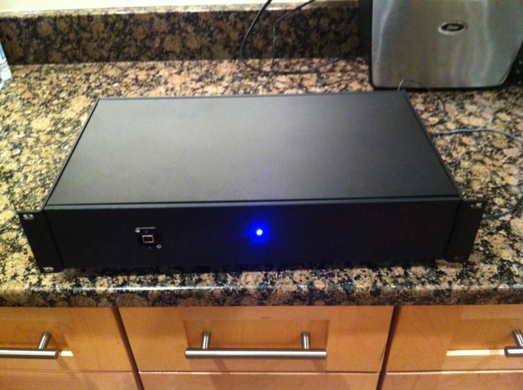

Ended up with a 2x8 board from ebay. Built a small box for it and got everything hooked up today. One question.. the power supply the seller sent works but the cord is short... anyone know a decent place to get them with about a 6 foot cord? Anyway my first Omnimic run with it... 4 subs and Denon 4311 doing the XT32 thing. This was a -3 on the receiver which is about as loud as I'll go.

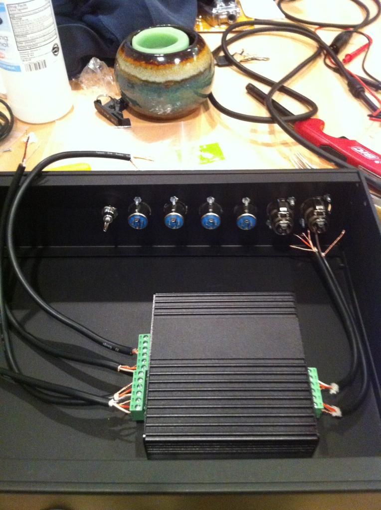

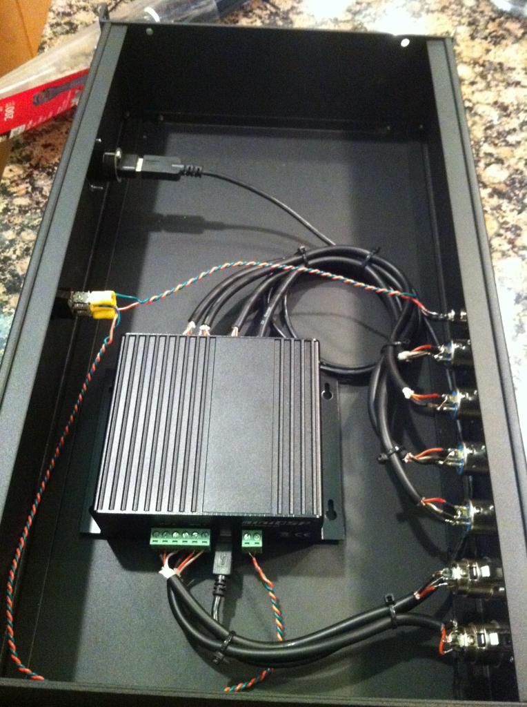

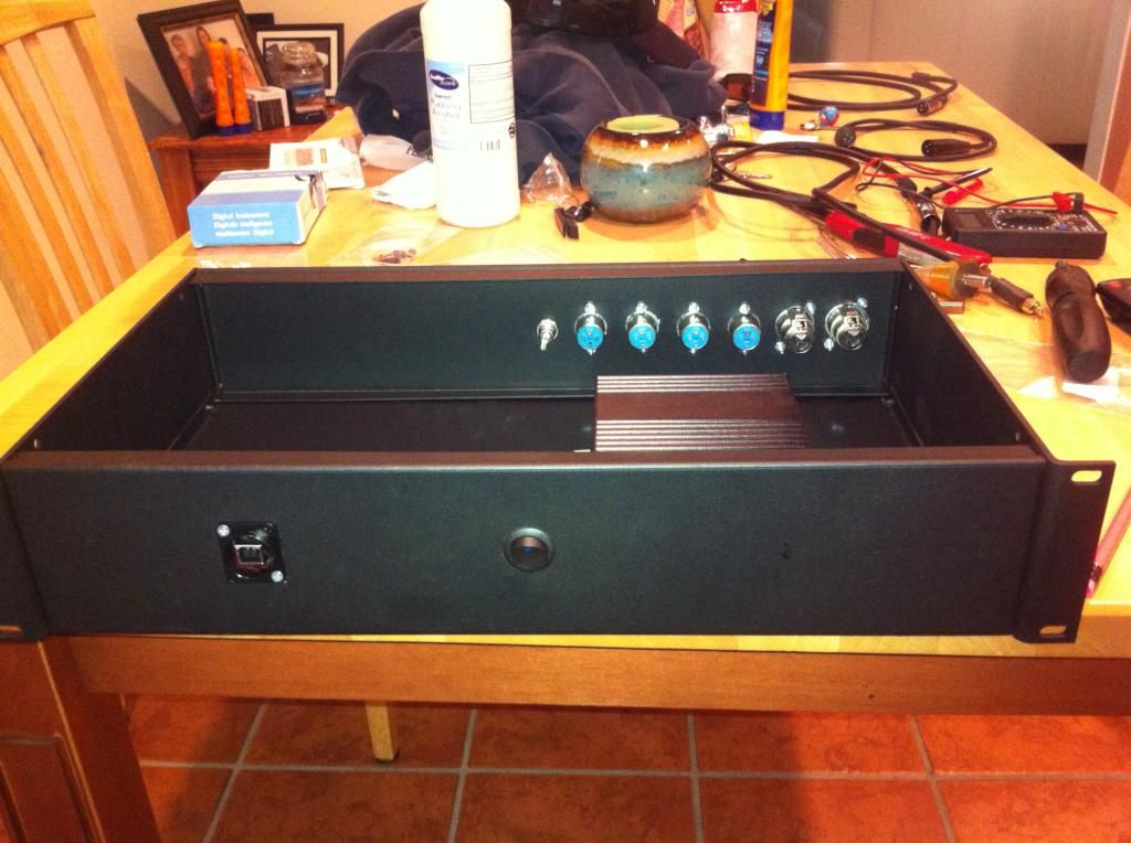

FWIW I mounted a Balanced 2X4 into a rack mount enclosure. I learned a lot on this project especially about interconnects and grounding.
DIY Rack Mount Minidsp Balanced 2x4 Enclosure
Here is how i handled grounding the shield(pin1) on each input and output:
One short jumper wire from pin1 to body pin.

Nick that case looks awesome. Great wiring job also.
Mfusick likes this.
