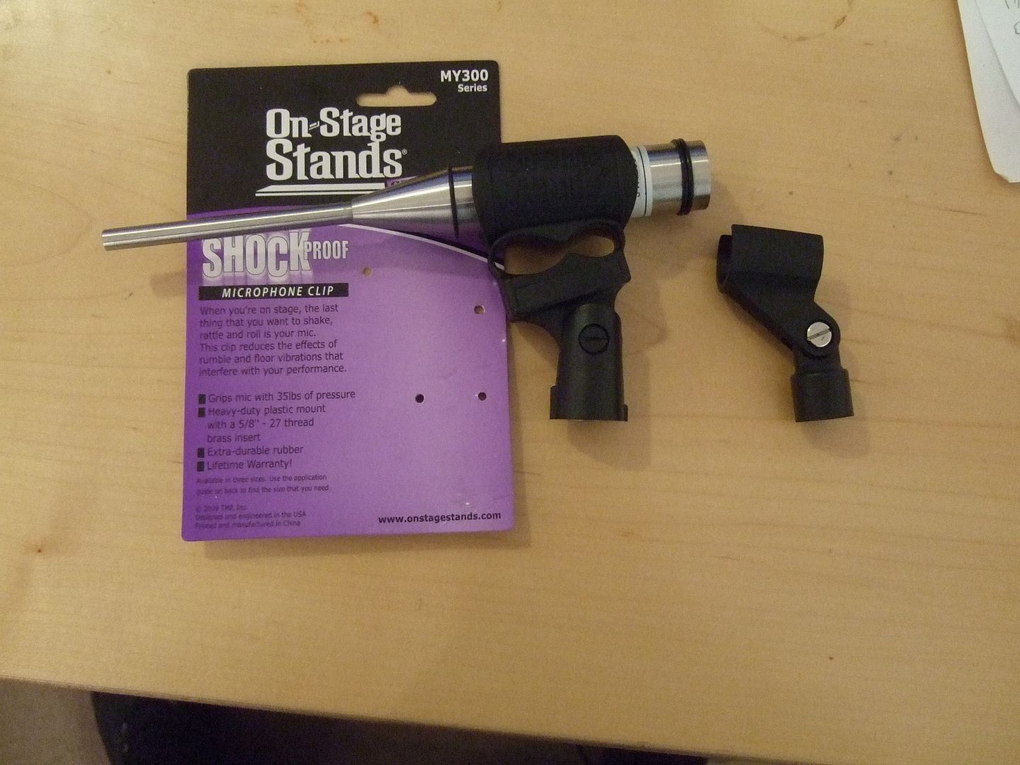

I don't know if anyone else thinks the microphone clip that came with the kit is a little lacking, rather than waiting for it to break I ordered an upgrade.
This one works:
http://www.amazon.com/Stage-MY325-Dy...7271239&sr=8-4
This one works:
I agree completely. Thanks for the tip.
