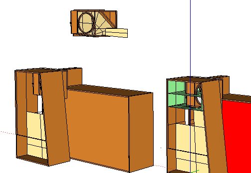

I'm having a problem figuring out how you are doing the pass through the wall. The Sketch-Up is missing that part, an I need it for the AkAbak script.
Looking at these two pictures you can see what I mean. You have the top section blocked off, but what about the bottom? Are you going to section some of it off, or leave it wide open boxed in by extending the bluish board in the first pick?

That is that little bit of on-the-fly engineering we need to do yet.
As I envision it, the wall will be plated with 3/4 material in the garage and the house. The garage cutout will match the garage side, the house cutout will match the house side. Then it is a matter of sealing the passage between the two holes. None of the pieces of wood for this will be square, but it sure looks to me like it can all be planar. Make sense?
Waiting for a few free minutes to get this actually drawn up, as well as final wall thickness measurements from dB when he cuts a HUGE hole through a perfectly good wall....
......Oh man - now you got me thinking on this......hmmmmmm
I know it will work, just scratching my head a bit.
....OK - panic is over..... I think.....
The sides and top will pass through, sealed to the garage side of the flare, the bottom of the sides and the bottom of the hole will mate up as described above, the top of the hole is simply sealed. Easier to draw than describe. I'll try to get it drawn up as soon as I can.....

We're working on cleaning up the transition where it comes through the wall from the garage into the room. dB came up with a few great ideas that should smooth things out, as well as asked a few questions that have caused me to have a bit of a re-think on the approach I initially drew up.
We've got a plan, I've just gotta get it onto paper so dB can cut some more wood. During the process of trying to get it drawn up so I can finalize the model and make sure we're OK, I've learned a lot about how not to work in Sketchup....
How to make a mess of your sketchup model in three easy steps.
Draw a big complicated model without using components.
Decrease the precision setting to "round" dimensions to the nearest 1/8"
Realize that your corners aren't where you put them, due to the "rounding" and that things don't meet at a single point any more.

Ok - so after a hiatus, famillial alterations, new additions, and other stuff - we're back at this.
Attached are a couple screenshots of Mikes cleaned up through wall transition - with reflectors. It's now buildable!
I'm pulling cut sheets and getting to work again. Expect more project photo's soon!
