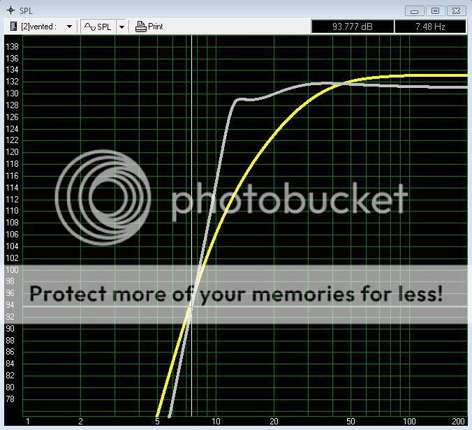

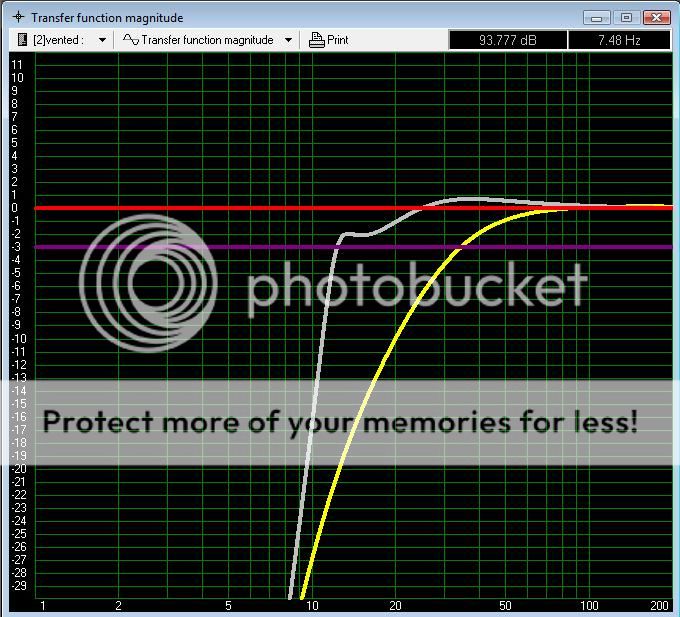

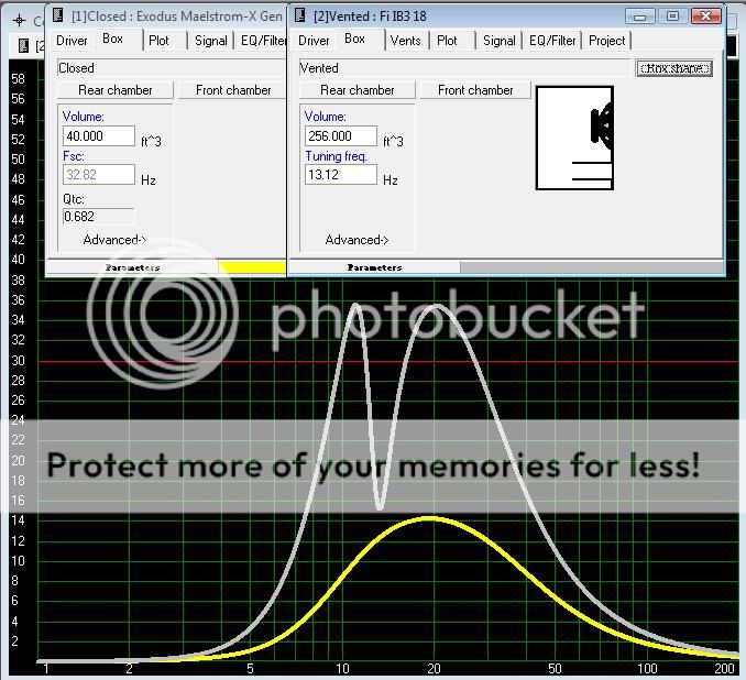

I'll be using Audyssey MultEQ XT. In the past it has EQ'd my sealed setups flat to single digits. If it cannot do it with this setup, I'll pickup a MiniDSP to apply a Linkwitz Transformation.
Here is the modeling with two amps outputting 10,000 watts, eight drivers, and 40 cubic feet of enclosures.

I put all of that information in the first post, graphs and everything
I'm going to run 2ohm stereo on the amps, which should provide 1200 watts per channel, or 600 per driver. I modeled with 4400 watts total from the two amps to try to factor in some inefficiency of the amps. They'll each have their own 20a circuit.
I know the drivers can take more power, but an extra two amps will only provide +3db. Staying further from xmax should provide cleaner output as well. At 20hz with this setup, it will be hitting 16mm excursion, and goes up to 18mm at 10hz, and 20mm at 5hz. I think it will be able to reach painful levels with just two amps, but if it needs more, I have the available power to add the amps if necessary.
I decided to go with 8x18 due to more Vd. EP4000's are overrated relabeled EP2500s. How are you going to get 4000 watts out of a 20 amp circuit? 20a @ 120v is 2400 watts.

I'm not meaning to hijack your thread here, I completely dig what youre doing... Ive done my thing and so I am taking much interest in other large builds seeing how people are getting there in different ways. I completely get that I went the budget rout because I had to. Please don't be annoyd!
Are you going to Linkwitz Transform these flat to a specific frequency? Is EQing flat the same but different?
Just playing around I plotted yours vs mine with 4kW, yours is the perfect roll off, mine has it's peaks and valleys... and room gain not taken into consideration. I'm sure I could EQ mine flat and we could end up with at least similar sounding but yours just much louder?
My FR vs yours
SPL though I expect much less power from my two amps since I don't have dedicated
my excursion is nuts, surpassing Xmax but still within Xmech. I have an untrained and unsophisticated ear, so as long as my spiders havent pulled tight, I can't even tell. But I expect if you EQ/LT flat, your excursion goes up as well?

Originally Posted by kryptonitewhite View Post
Does doing eight in 40 cubic feet jsut give you more headroom and less excursion than four in 20 cubic feet?
Yes.
I mean could you do the same thing with just four of them but then youre getting more excursion therefore more distortion, or would *only* four not be enough?
They hit xmax much faster, and run at higher excursion levels.
If you look at the excursion graph in the first post, with double the power, that's exactly what 4 drivers in half of the space with the same power looks like, however the SPL graph would be down 3db.
So, by going to 8 drivers over 4, you drop excursion by over 6mm, and gain 3db.

Originally Posted by notnyt View Post
Yes.
Got it. you hit Xmax at 3.5Hz with four, never hit Xmax with eight, and eight is always 6mm less so still sounds better all along. I'm guessing you audiophiles can still tell the difference between say 12mm and 24mm even when thats below the 32mm Xmax? Glad I can't
That's what I'm trying to avoid. You will gain some db down low, but then you have to deal with excursion and porting issues. I've used Audyssey MultEQ XT in the past and have gotten very flat response curves out of sealed enclosures. The sealed enclosures offer me the benefit of less space, and being able to stuff more drivers in my room to make up that db difference =]
This was 4 13av.2 drivers in small sealed enclosures corner loaded.
I don't consider myself an audiophile, but when I hear a driver bottoming out or making noise, it drives me crazy. I definitely suffer from OCD. That's the main reason I'm switching out my THTs. I don't need more output, but firing THT's directly into a corner and transferring all that energy directly into my walls rattles a bunch of stuff. I've already removed the springs and stuff from the windows near my HT Also, I just want to build something, and something big and ridiculous.
OK. I got it before, but I understand it even better now.
That is extremely flat to 10Hz.
