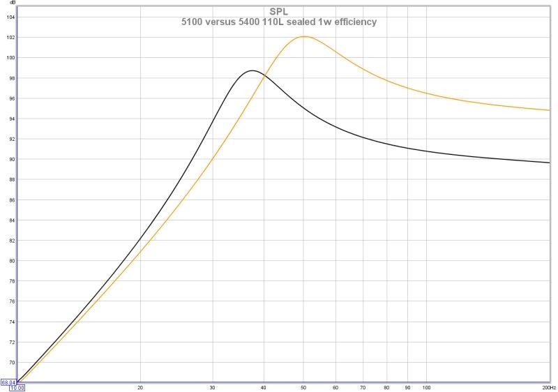

I think you guys are missing the point that the 5100 DOES NOT OFFER ANY SENSITIVITY GAINS OVER THE 5400 BELOW 80hz. There is no advantage to be had here, you will require just as much power and just as many amps. The disadvantage is that you cannot feed as much power to each driver. I push more power to my 5400s than a 5100 is rated for.
Again, Watt for Watt, output will be nearly identical up until about 80hz. Only at 100hz is a 3db sensitivity gain realized over the 5400.
Here is the graph with equal power to a 5100 and to a 5400.
http://i.imgur.com/aizTv.png
What benefit do you think running a 5100 will give you below 80hz? Maybe I'm missing something here, but I just don't see it. You guys are living in a fantasy world if you think the 5100 is going to give you +3db in the ranges down low watt for watt.
On this point you are correct, though oddly under-inclusive. In a sealed cabinet of a given (reasonably small) size, pretty much every driver will have the same efficiency. The box determines the LF efficiency far more than the drive-unit does!!! So one could say the exact same words about the Maelstrom-X, or for that matter the B&C 18SW115.

5100 versus 5400 both in 110L sealed with a true 1w of constant power applied to each. 5100 is Gold. Hint: This is not a constant voltage efficiency but a constant power efficiency. IOW how hard is your amp working driving each for a given output. (There is a little more to it than that but it's close enough.) Forget about voltage sensitivity graphs guys...Efficiency does vary even in the same enclosure size. It is the voltage sensitivity that doesn't vary much. More efficient drivers might have similar spl looking solely at the voltage drive level but if you start looking at current demanded from the amp and more importantly total power there are differences. Note that the 5100 and 5400 have very similar BL^2/RE ratings. The differences below are due to the different suspension stiffnesses, resonances, which will move the placement of the impedance peak where efficiency is highest, but mostly the difference is due to the fact that the 5100 has much less moving mass. The 5400 is an easier load on the amp below 40hz but the 5100 is WAY easier on the amp above 40hz. Obviously thermal compression comes into this as well when one driver needs so much less power over a certain range. Obviously real program material is usually complex and not limited to a specific narrow bass range too.
EDIT: BTW manufacturer power handling ratings for drivers is one of the most complex stats to quantify well and one of the least useful. It depends so much on the loading of the driver and the material fed to it that it is basically a worthless spec in many cases IMHO.
Im not sure I follow the 5100 is 94.5 dB for 1 Watt, the 5400 is 89.7 dB for 1 Watt. How can you say the 5100 does not offer any senstivity gains over the 5400?
Show me the models for both with 1000Watts?
I will bet you that you never push remotely close to full power into your 8 5400s. If you have 32000Watts, what do you REALLY think you use during any movie???
So I will say that you would never push more power into your 5400s then what the 5100s will handle.
How about you just say you don't not mind spending $3K more for BIG amps and move on

The amps and wall voltage pretty much run out at the same point. This happens before driver compression. There is a gain to be noticed with the 5100s above 60hz or so, but it isn't worth it as I can put out enough SPL in that range to physically hurt as it is. On my system, not speaking one driver to another, I have no issues with 60hz and up. I don't want to give up anything down low. As per Kyle, the 5100s will not perform as well there in a sealed enclosure. I think I'd go by what he's posted in this case
An expert would recommend 8x5100 over 8x5400 if the head room on both is 30% more then what is used in room only because the $$$ saved from amp/circuit differences is in the thousands already.
Circuits were maybe an extra $100 in materials? Amps were about $650 a piece.
I linked it in the thread you replied to. It definitely has a sensitivity bonus at upper frequencies, but down low it is irrelevant.
The clip lights say otherwise =]
It's an interesting discussion. I'm not trying to make it personal or anything. At $650 a piece the Marathons aren't so bad. People bringing electric bills into the discussion is hilarious though. I haven't seen any changes after switching to big amps. The amount of time that they're on and using that much power is trivial.
I'd love to see a head to head comparison between 5100s and 5400s. With 8 of them, you don't run into any compression or distortion, so it doesn't really matter which you go with. However, I am interested into how they would do pushed to the max with a smaller set of woofers. What kind of lunatic would run more than four of any of these in a room anyway? =]

hummmm this thread is a real eye opener. The 5100 in most aspects, would seem to be the ideal choice if your not planning on maxing out your xmax on your subs or gettign multiples. Same money with less power requirement.
The main "problem" with it is simply price. I don't think the question of whether one will be able to tell any difference between 8 TC 5400's and 8 TC 5100's in a room is that interesting. Why? Both of them are drivers with gobs of throw and presumably top-tier motors and suspensions. Moreover, either way you're talking about somewhere around 7000 USD in just drivers. (I assume PE will offer some quantity discount for purchases of 8 units upon request, though it's not on the website.)
What would be far more interesting to me is whether one would be able to tell any differences between a setup with those 8 $800 woofers, and a setup with 8 sealed B&C 18SW115's (a woofer that measured so well in Voice Coil that at first I did a double-take to make sure that was real-world data and not a simulation of an ideal) at a little bit more than half the price each.
Of, if one wants to use less EQ down low (and assuming Madisound has that many still in stock) eight Aura NS18's at probably around 6000 USD for the whole set. That would be interesting because it would compare two very different uses of the Aura NRT motor design.
Or for that matter 8 sealed Peavey Low Rider 18's at roughly a quarter the price of the TC setups (Don't laugh. That's a really good woofer regardless of price.)
The above all assumes EQ to equivalent FR.
For a single nearfield sub, or the ULF sub in a Geddes-style setup, the price of a single flagship TC driver is less daunting. If I didn't already have an Aura NS18, the TC 5100 would be at the top of my list for my nearfield/computer system subwoofer. But as a set of 8...that's a lot of cash. To put it in perspective, that's a JLC Reverso and a pair of Edward Greens made to order through their Top Drawer program!
It's not the electric bills that are the concern, you are talking pennies to run things for a movie.
But, running circuits is not always an easy endeavor depending on walls and locations. (ala the cabin side of my house).
The electricity savings of sorts comes into play if one can get the same output for half the power and half the amps.
However, that does not appear to be the case here, at least I think.
Maybe that is the better question altogether. If you have the space, cheaper low distortion drivers is probably the better option. No one would argue that the SQ is phenomenal with the LMS. Perhaps the B&C can be tested in the next round and see if it measures up (pun intended).
This is what I can't seem to wrap my mind around. I realize that small sealed enclosure is the most inefficient.
But, all other things being equal I can understand why there would not be a large difference there.
I agree. Down low, given the same 1kW amplifier, they should perform about the same. In the upper bass, the 5100 should have an advantage. With significantly more power, the 5400 should have an advantage down low. Especially if, like the Aura drivers on which it is based, the 5100 has a gently sloping BL(x) rather than a ruler-flat one.

For me to get 30 amp circuits is going to cost amost $400 for two (I do not do electrical work myself, just like I do not cut my own lawn either ). I have EP2500s already but 4000W amps (like Marathon) are $650 or more a piece so thats $1300 vs $400 (Ep2500s cost me $200 each).
total cost different of a 2 x LMS 5400 vs 2 x LMS5100 system for me is $1300.
Above 20Hz Im never hitting close to 2x LMS5100 peak SPL.
So is the 3dB difference at 20Hz, 10Hz worth it? That is the $1300 question for me if I was to start a project now. In the end I still may buy 2 LMS5100s and run two off the Crest amp I have. I have to check if they have the same diameter for fitting in a box.
