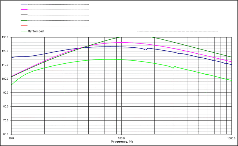

I was just modeling these last night in Unibox. If the Mal-x isn't around and neither is the RLp18, I may step it up to either of these. I very very very much would like to see Ricci compare these against themselves in his next round of tests. I know the newest LMS is included as will be the 5100. Looking forward to the results.
EDIT: Here is a Unibox graph of the 5100 and 5400 in a 185liter (dual opposed) sealed box with 1000w per driver. Also in the graph is my LLT's with 650w each and my older Tempest with 250w for reference.

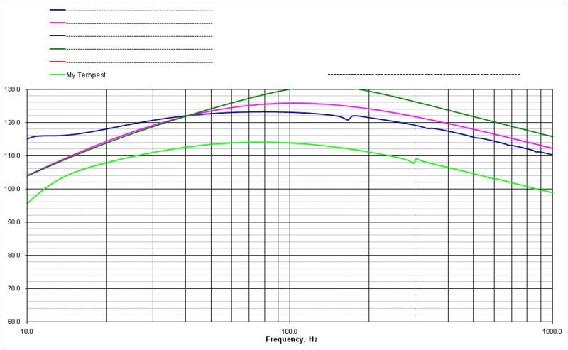

Okay. I remodeled at 300 liters dual opposed against my LLT's/OG Tempest. The power levels are not identical but arbitrary. There are all sorts of numbers I can enter if you want something specific. Btw, there is still a good amount of xmax left in the tank on both the 5100 and 5400 LMS.

The 5100 having more SPL above 50Hz only matters if you are maxing out with the 5400. If never even hit the 5400 limits then you will never use the 5100 to its full potential above 50Hz.

But does the 5100 essentially come with its own "house curve"? In a system with no EQ, would it accentuate the upper bass frequencies(which some enjoy, and some newer sub companies might use as a selling point )

Its just going to be a copper coil version with a 1+1 ohm coil. You can simulate the entire driver by taking the Re down to 2 ohms and re-calculating the new Qes. - more of a high motor version with a BL^2/Re of around 300. We're also hoping to get a 15" out too.
