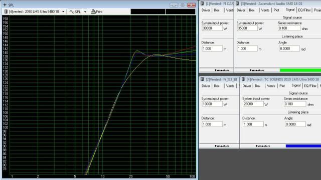

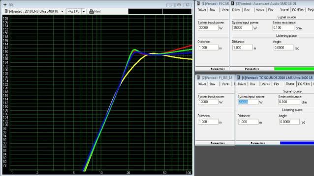

Holy crap! Those look sweet. I'm gonna model those up right now.
How the heck do you get custom drivers like that, how can I get some and how much are they?
Scott Simonian is offline
ib@ficaraudio.com email Scott!
Will you send me the driver data file when youre done? I can't enter them in ISD worth a hoot! Never had any trouble in Bass Box Pro

I played around with them a bit but the response changes A LOT with different Le specs. Like all them darn FiCar products... they never list the damn Le. Lol, seems kind of important.
why is that? I HATE that! At least most are given, incriminator has NONE!

Could someone pop a winisd file off that custom driver on here. I want to see how they compare to my Q18's and how winisd compares with bassboxpro. Bassboxpro lets you put the parameters in any order where as winisd doesn't and I can never remember which poxy order they go in.
cheers
Graham
