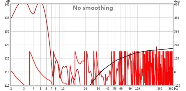

something's way off. I was going to just do them messed up thinking it would still show before/after just uncalibrated, but this is too messed up.

You're not getting input from your mic or have it set to the wrong channel or the input level is too low or you plugged it in after rew started.
Why you're destroying your house, I still don't understand.

That is just noise. Nothing meaningful there.
What notnyt said - something is wired up wrong.

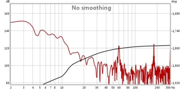

in and out were changed back to default for some reason in rew but the mic calibration file was still in there and C weighted was still checked.
When I reopened it it gave me a pop up to recalibrate, I have the door propped up so I have to walk around the house to get from the PC room to the HT room so I am waiting for Austin to get here so he can tell me "when" the needle is at -3dB on the mic with it set to 120dB. Thats assuming sealing it up didnt change the average SPL. I havent hubg the track to hang the door yet so I have to scoot that bastard by feet and arms. It's heavy.

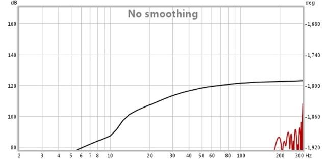

people give me crap for using all red power wire in my van, grounds too. wire is wire as long as you pay attention.
as long as you pay attention. when I first hooked RCA to RCA to RCA I hooked red and yellow, not red and white. When I grabbed the wires out today I thought "nah Ill do them right" and unplugged one end and plugged one in right
thanks guys

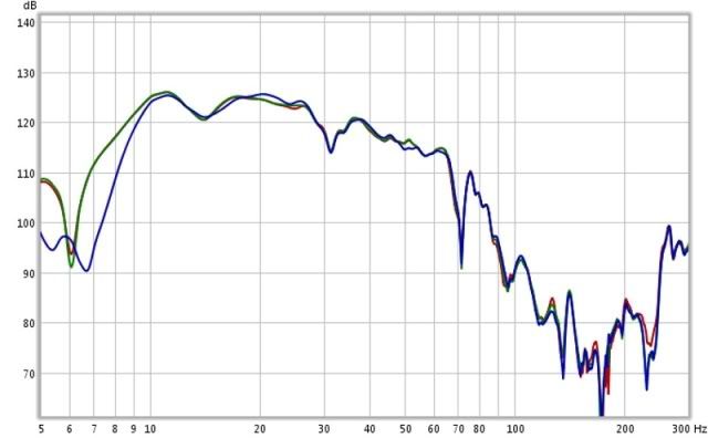

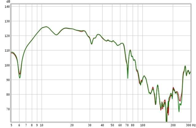

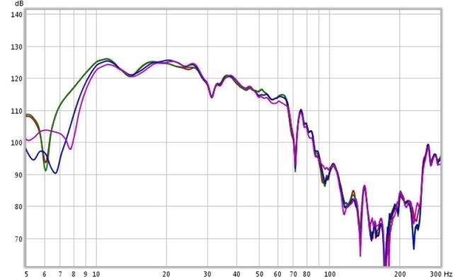

but that dang spare room door, I tell ya. "fixed" it... pulled the screws out and blocks off, done testing with them, huge difference down low in the single digits knew I should have left it caulked shut for-e-ver.
kryptonitewhite is offline
post #462 of 464 Old 04-05-2011, 04:17 PM - Thread Starter
kryptonitewhite's Avatar
Join Date: Aug 2008
Posts: 4,630
entry way door open as well.... so I gain a lot in the ULF department all sealed up

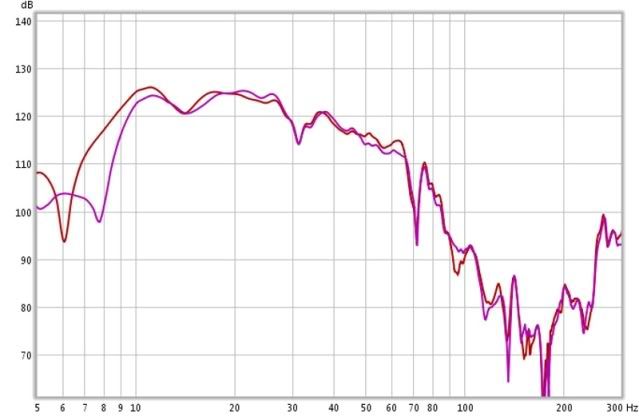

both doors shut, sealed up, vs both doors opened up
