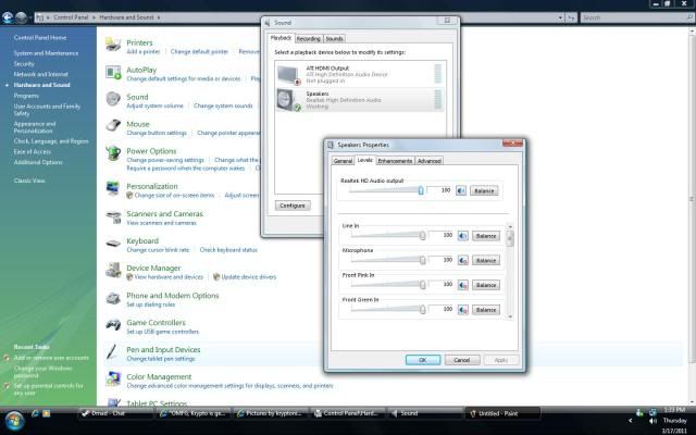

post #181 of 464 Old 03-17-2011, 09:48 AM - Thread Starter
kryptonitewhite's Avatar
Join Date: Aug 2008
Posts: 4,602
playback line in 100
recording line in 100
kryptonitewhite is offline
post #182 of 464 Old 03-17-2011, 09:53 AM
notnyt's Avatar
Location: Long Island, NY
Posts: 4,936
Mentioned: 23 Post(s)
Quoted: 491 Post(s)
Liked: 660
hook up the meter to mic input instead of line in. I'm pretty sure its higher sensitivity.

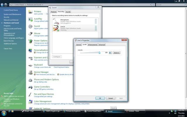

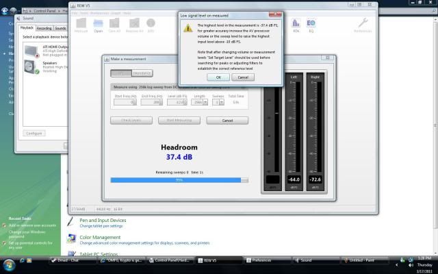

post #183 of 464 Old 03-17-2011, 11:28 AM - Thread Starter
Join Date: Aug 2008
Posts: 4,602
I havent hooked the mic up yet, just looped line in to line out trying to get 10dB headroom. Should I skip the loop and hook the mic up?

post #185 of 464 Old 03-17-2011, 11:34 AM
notnyt's Avatar
Posts: 4,936
Quoted: 491 Post(s)
Liked: 660

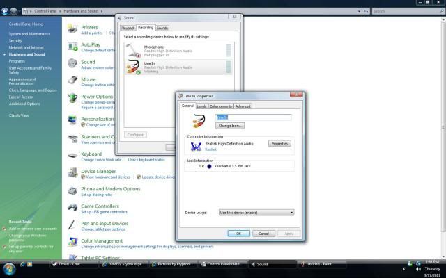

if line in to line out is presenting you with that much of a level difference, something probably isn't right.

What sound card do you have? Use those picture and video skills to post a picture of your soundcard. Is it an internal soundcard in your computer? Those almost never work right for REW or audio programs.
Start with the preferences main screen and make sure everything is working before going to anything else. You have a couple of things. Set the SC you are using as default in your control panel. Keep the control panel open while you try to figure this out. In REW you have a couple of things. You have the main measurement channel you can switch between right and left with a check box. You have the drop down box that should show all of your available inputs and outputs. Make sure those are set to what they should be. Try a few of them if you aren't getting a signal. Also you have your output level and your input level. Run the check levels routine until you can get the signal up into the green. You should be able to clip your input with a loopback. (Most any SC can put out more voltage than the input can handle. If you can't get up above -40 or so then something is wrong with the set-up. Did you turn up the output level in REW to the max?

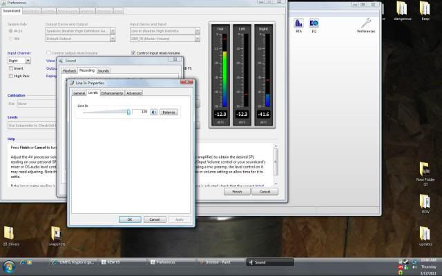

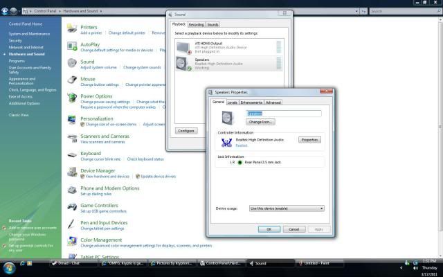

post #187 of 464 Old 03-17-2011, 12:19 PM - Thread Starter
Join Date: Aug 2008
Posts: 4,602
http://www.guru3d.com/article/ati-ra...-512mb-review/
http://www.newegg.com/Product/Produc...82E16814102819
HDMI is delivered on the rear bracket together with DVI and VGA out. So the white serial port lookin deal is DVI

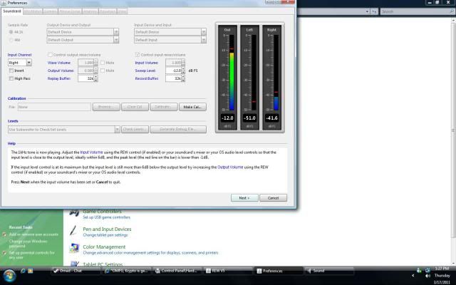

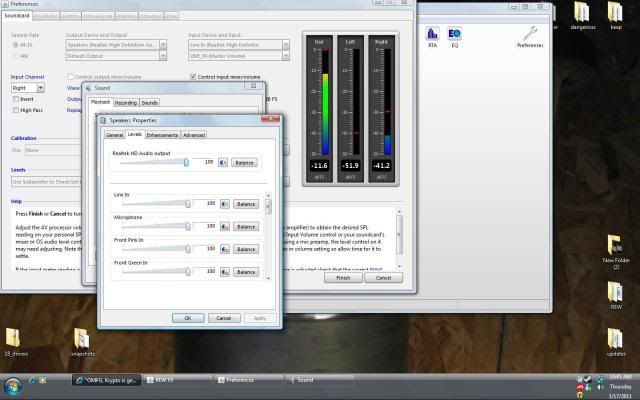

post #188 of 464 Old 03-17-2011, 12:30 PM - Thread Starter
Join Date: Aug 2008
Posts: 4,602

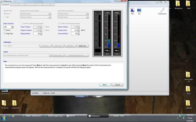

alright, i left the input volume from rew at 1, changed from realtek input and output to default input and output, appears the same or close

post #190 of 464 Old 03-17-2011, 12:42 PM
Bass Enabler
Scott Simonian's Avatar
Location: Clovis, CA
Posts: 14,749
Mentioned: 19 Post(s)
Quoted: 1170 Post(s)
Liked: 1197
Give that microphone input a try. See how that does.

post #191 of 464 Old 03-17-2011, 12:44 PM - Thread Starter
Join Date: Aug 2008
Posts: 4,602

Yeah, so try the loop using the mic input and not the line in. Might help. Might not. Let's find out.

oh, mic in, not the actual mic... I can do that? alright, after they fall asleep (watchin 24 ) Ill give it a run!

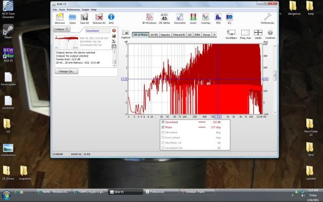

post #200 of 464 Old 03-18-2011, 12:22 AM - Thread Starter
Join Date: Aug 2008

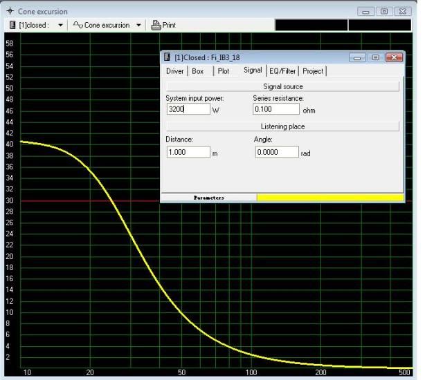

Posts: 4,602
not what I expected: I thought Id simulate 4 IB3 18s in 256 cubes sealed to mimic the tower excursion without port loading. First with 10Hz HP to simulate electronics roll off, took 4kW to get to 40mm, removed HP took 3200 to 40mm

post #201 of 464 Old 03-18-2011, 01:23 AM - Thread Starter
Join Date: Aug 2008
Posts: 4,602

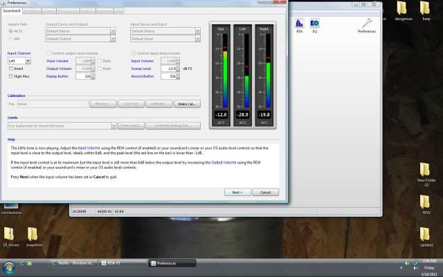

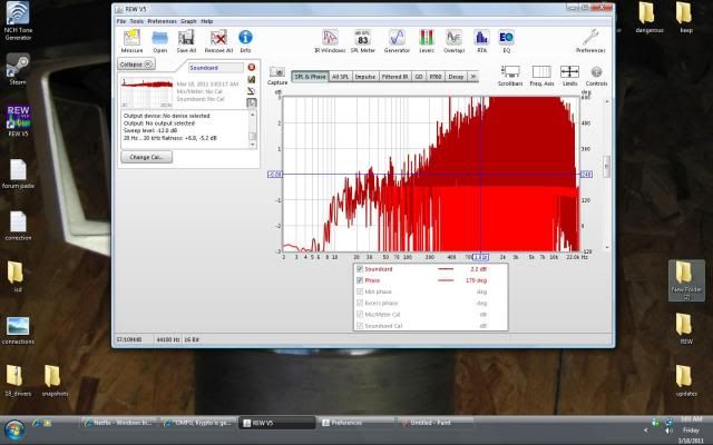

line out to mic
1st run (didnt get snapshot of headroom ran again after this, 2nd time came up green)
2nd run

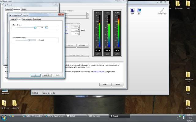

post #202 of 464 Old 03-18-2011, 01:25 AM - Thread Starter
Join Date: Aug 2008
Posts: 4,602

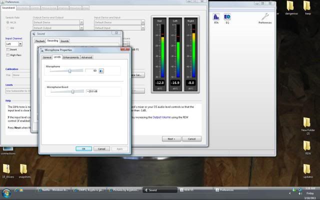

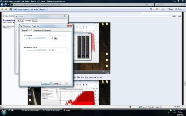

heres the mic level settings, 17 and 20dB boost

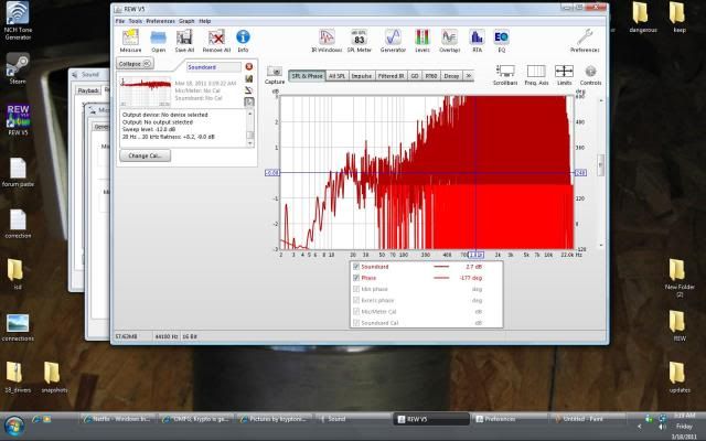

post #203 of 464 Old 03-18-2011, 01:35 AM
notnyt's Avatar
Posts: 4,936
Quoted: 491 Post(s)
Liked: 660
notnyt is online now

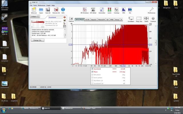

post #204 of 464 Old 03-18-2011, 01:59 AM - Thread Starter
Join Date: Aug 2008
Posts: 4,602
Originally Posted by notnyt View Post
dude, raise the input level, drop the boost.
I figured that, but I didnt want to until told to do so, especially after seeing the FR graph off the chart. I don't know that mic in can handle full power from line out. Now that I have it in black and white and can blame you, I'll do what was apparent

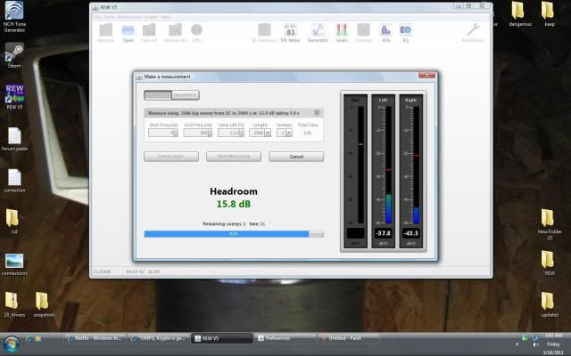

post #205 of 464 Old 03-18-2011, 02:07 AM - Thread Starter
Join Date: Aug 2008
Posts: 4,602

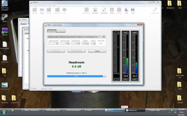

i brought right to red bar 2dB below line in as Help said, which meant 100 with 10dB boost
when I click next and everything falls, left and right still have "noise". is that induced (bad) noise?
15dB headroom, Ill raise boost to 15dB and shoot for 10dB
new fr

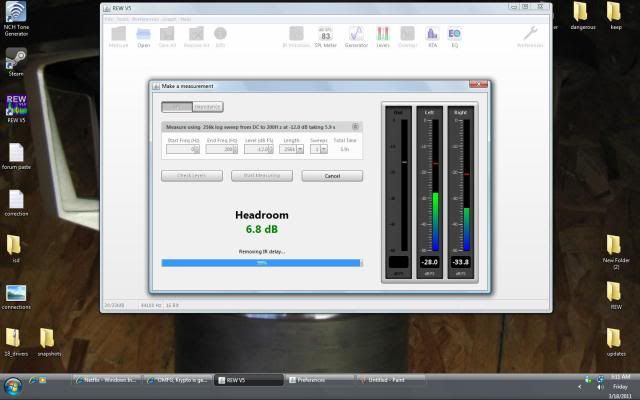

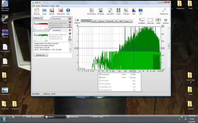

post #206 of 464 Old 03-18-2011, 02:13 AM - Thread Starter
Join Date: Aug 2008
Posts: 4,602
7dB headroom, too much (cant go to 15dB boost, only 10, 20, and 30...Ill lower 100 and try again for 10dB)
post #207 of 464 Old 03-18-2011, 02:20 AM - Thread Starter
Join Date: Aug 2008
Posts: 4,602
10db
60 +20dB boost
post #208 of 464 Old 03-18-2011, 02:29 AM
notnyt's Avatar
Posts: 4,936
Quoted: 491 Post(s)
Liked: 660
you generally want as little boost as possible, max the level before touching the boost.
Run the check input level stuff. The output level should be about the same as the input. It's ok if the input is a little lower. even 15db headroom is fine.
Still, something is wrong judging by the crazy graphs. That's not supposed to happen. It's either a feedback issue, or something else. Make sure you have any settings for the inputs checked not to play it back out the speakers.
Go to control panel, sound, recording, double click microphone
next, go to listening, make sure listen to this device is unchecked.
go to enhancements, uncheck everything except dc offset cancellation.
In advanced, set it to 2 channel 16 bit 44100hz. See if that helps.

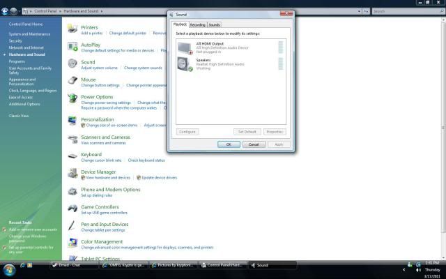

post #210 of 464 Old 03-18-2011, 03:34 AM
gperkins1973's Avatar
Join Date: May 2009
Posts: 1,520
Jordan,
I noticed that your input and output is set to default input. It should be set to the appropriate soundcard whether it be internal or external otherwise surely REW won't know what you are using.
cheers
Graham
gperkins1973 is offline
