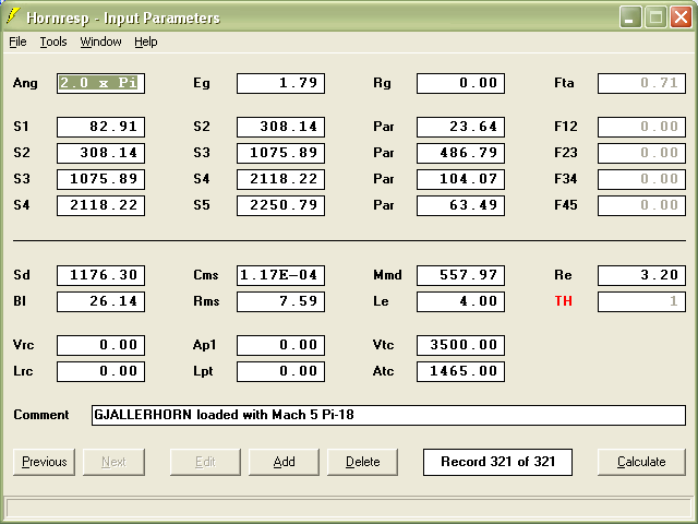

New Mach 5 Audio Pi-18, posted today.
http://www.istonline.ca/mach5_pi_18.html
Fs (Hz) 19.3
Re (Ohms) 3.2
Qes 0.33
Qms 9.29
Qts 0.32
Cms (mm/N) 0.118
Rms (kg/s) 7.49
Mms (grams) 573.5
BL (Tm) 25.93
VAS (L) 229.9
34mm Xmax
Sd (cm^2) \t1176.3
Lp (2.83v/1m) 92..9
1200 watts RMS power handling
WinISD driver file for anyone interested.

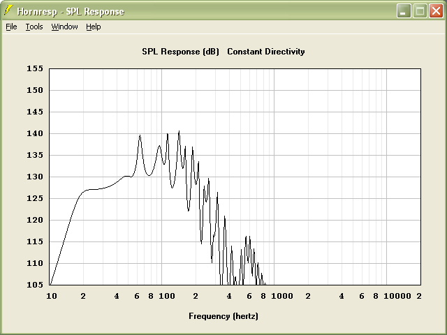

If it's priced right, it'll sell like crazy. Needs yo compete withe the inexpensive and efficient horn design offerings though. Or work well in a new, low knee horn design.

Yup. Been modelling around with it in Unibox since my last post.
This is one serious driver. Let's just hope the supply of these is as serious as the copious amounts of bass one of these will produce. Dayum.

Very close, although it appeared to model kind of closer to an LMS in a sealed box.. q = .5 in only 200L whereas a mal-X needed 450L to get q = .5
but the maelstrom had a bit more bottom end efficiency, a bit less top end efficiecny.
It almost seems as if this driver has been optimized to work with an EP2500 as it squeezes every watt out to get to xmax
