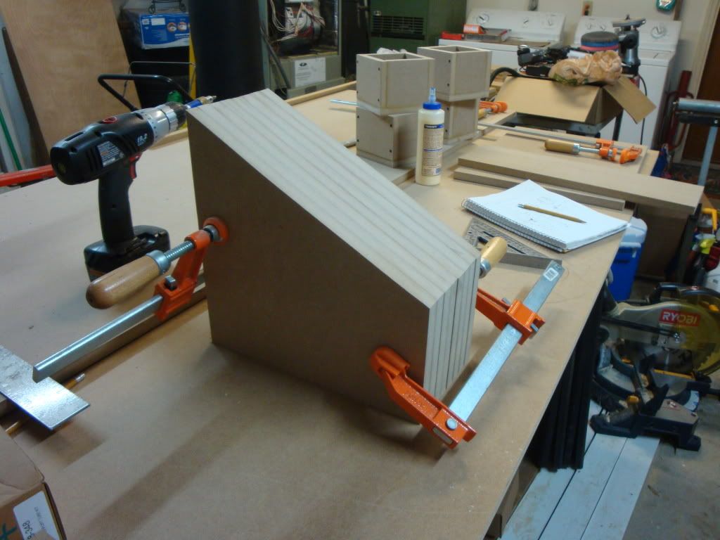

So I cut the angles in the side pieces free hand on the table saw. Got them all about 1/16" off and decided to clamp them together and sand them. My miter attachment will not accommodate the size of the side panels. I will end up eye balling the angles on the table saw and see how close I can get.
I would like to hear any suggestion you guys have about my methods if you have input you feel would help simplify the cuts I have left.

filtor1, those are pretty darn good for just eye balling it!
The remaining angles - on the ends of the boards I assume? You have a few options I suppose. Circular saw or jig saw set to the correct angle, then follow the board edge extremely closely and sand any imperfections. Or a router with the correct angled bit? If you use your table saw, make some quick and dirty jigs to hold the boards at the correct angle as you cut them.
I hope this helps....

I appreciate the advice. I ended up giving it a whirl. I got the angles almost dead on using the table saw and left 1/2 a blade width for wiggle room. It fits great less my eye ball cuts. They are off more than it appears. Since it is the back panel I am just going to use screws to pull it tight and let it be. I will experiment some tomorrow and see if I can duplicate it. If not, they will be square. I will only have to re-cut the 4 front panels and cut down the back and sides. Going to try and push through it first.

Originally Posted by filtor1 View Post
Mine will only be 6 panels, theirs is 7. I am already challenging myself there. lol I didn't want to tackle the 7 panel. I am going to fill the screw holes and paint these the color of the living room in an effort to mitigate their actual size. My background is in building boxes for automotive audio and very rarely were they ever this "small". But hanging in my living room, 1cf appears bigger than I thought.
Here are a couple of the boxes I built this past year:
The first one was (2-12" AA Havoc's) the last incarnation of many attempts at getting what I wanted in my car. Happened to be my favorite. 4cf tuned to 28. The second one (3-12" JL W6's) was for a friends clients Avalanche.
I gotta get motivated.
Edit: I found a couple pictures of the finished product from one of the boxes for my car.
Wow man! Those are very impressive!!! I did some car audio back in my younger years but I don't remember my stuff turning out that nice! Good Job!
