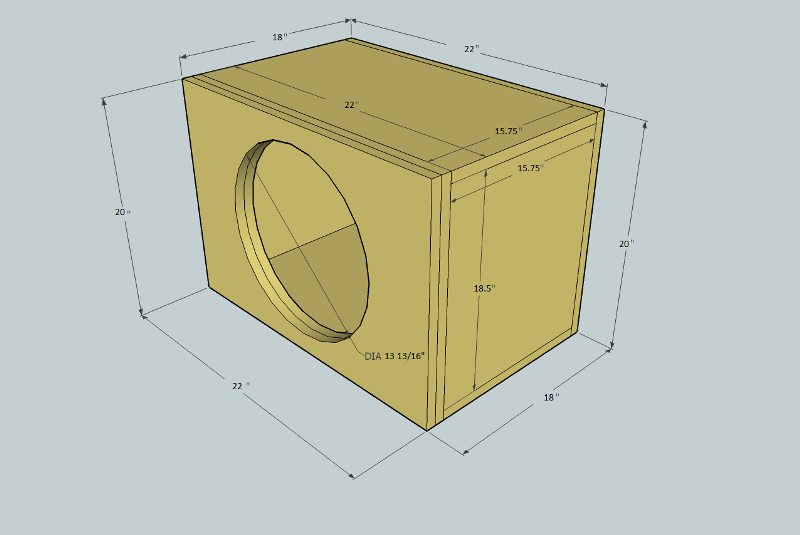

At the moment I'm leaning toward 2 sealed at about 3cuft. My question now is about box construction.
Is it necessary to double the front baffle? Also, how extensive should the bracing be? Would some strips of MDF (8-9" wide) top/bottom, front/back, and side/side be sufficient?

i won't be doing double baffle. i will have one piece of mdf with a big circle in the middle of the box for bracing.
smokarz is offline

Wembley has a PDF drawing of a single sealed box in his dual opposed MFW thread.

Here's my approx. 3cuft boxes I just finshed building.
