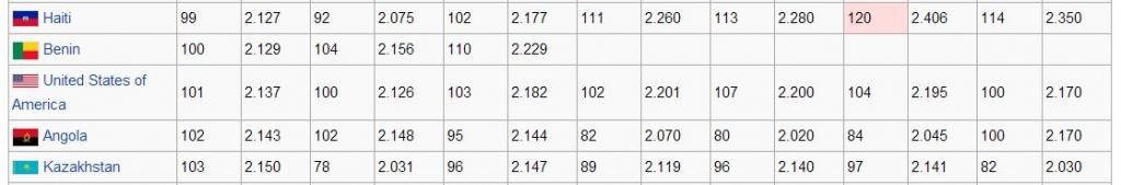

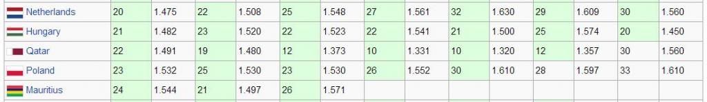

Originally Posted by BassThatHz View Post
Just remember they chop off your hands there if they catch you surfing a website that isn't government sponsored and controlled,
or pretty much for any reason really... they find such things entertaining and amusing there, like public beheadings.
Objective data from the Global Peace Index disagrees with your assessment.
Qatar
vs.
USA
Based on the GPI, Qatar is roughly 5x more safe than the good ol' USA. Now, considering that you can drive anywhere in Qatar within 90 min from Doha, that to me says it's a decently safe country!
