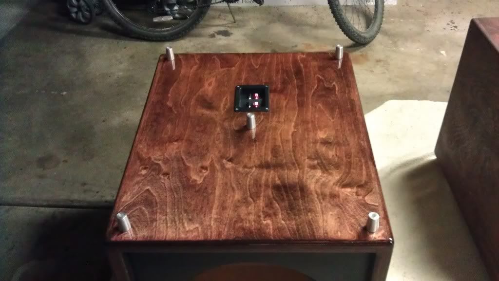

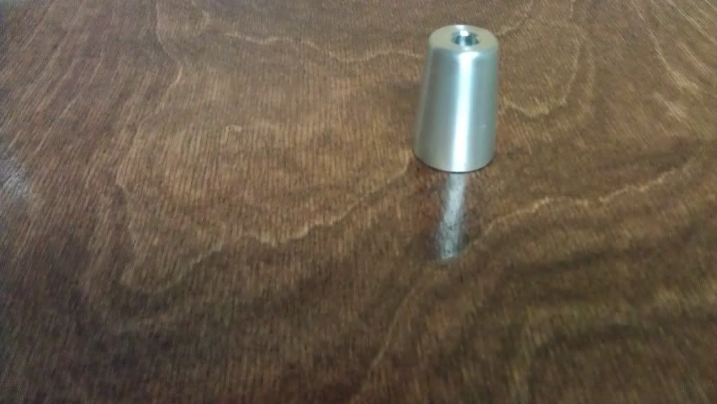

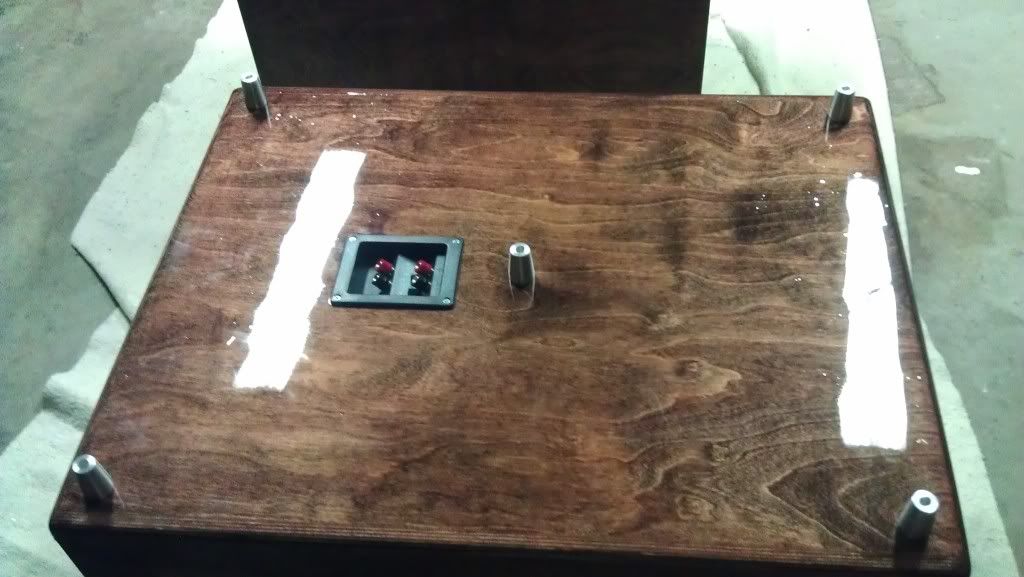

Just a quick pic of how my feet are going to look against the stained wood.
Yeah, I am super excited about how these things are looking, hopefully the wife will be as well..
My first DIY project. A dual, dual opposed setup

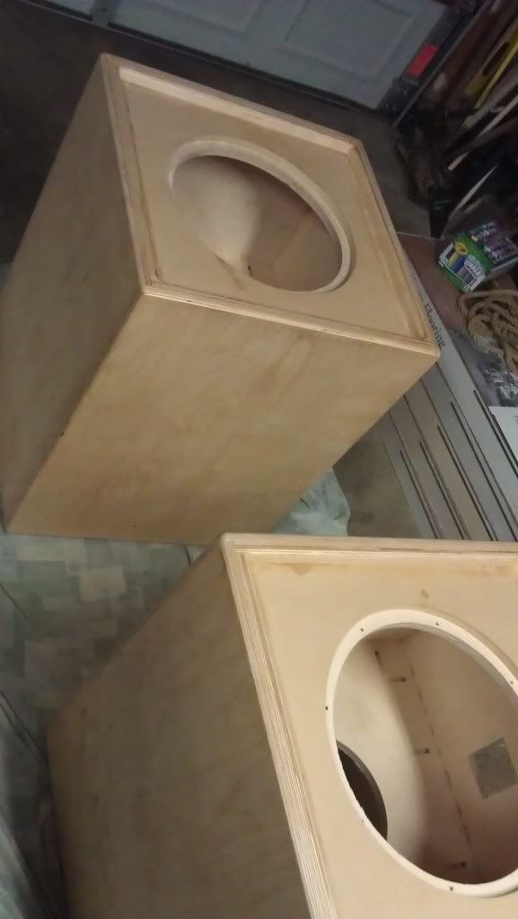

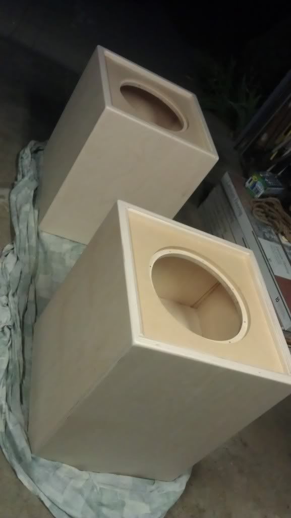

So I was able to get some time tonight to work on the cabinets..
I have been worried that my sealed boxes might not be sealed, so I got a tube of silicone and on all edges the inside of the box. Probably overkill, but hey that's how I roll..
I was able to rough sand, and finish sand both cabinets. Here is a shot of the done sanding cab.
Then a shot of both enclosures standing on end after rough and finish sand..

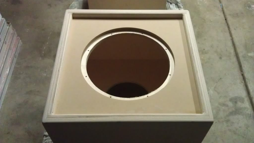

@ PBC Yeah I am going to be making a grill, that is why the frame around my outer baffel is there. I am planning on a interference fit, I hope that will be enough to keep them in place.
Anyway, I was able to get some work done today since I came home from work early cause the wife was thinking she was in labor. (that seems bad, I know that I came home for a possible labor, but ended up working on subs, buy hey, addicts are not normal people) False alarm on the labor, but progress on the subs!
Here is a pic of the fully stained cabinets.
In that pic you can see the little baby, (soon to be big sis) drinking her free slurpee.. And the cabinets. lol. As you can tell they are just stained no finish for now, waiting for the stain to dry 100 percent. Going to be using the bar top epoxy that eric h talked about on his build.
Here is another pic of just the grain on one side, I really like the way they are turning out.
And once the stain was dry enough, I figured, hell lets tape it off, and commence to spraying the outer baffels
In that shot you can see the tape, and the primer.. Once the primer was dry it was time to spray the black.
Now imagine the black and the stain covered in a high gloss outer protective fininsh. Thats the plan, but its going to take me awhile, so stay tuned!

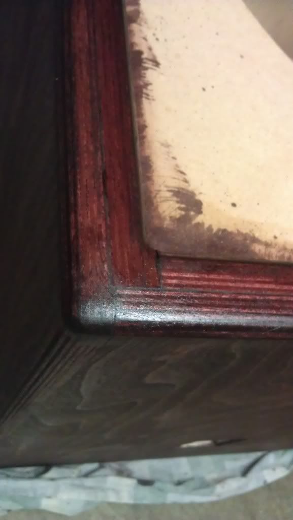

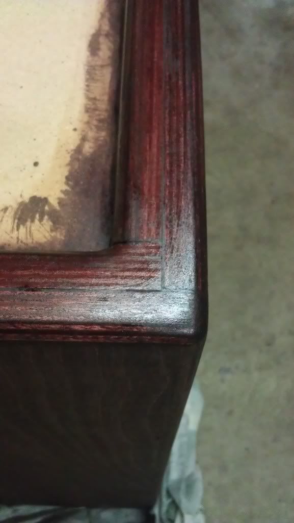

Can you do a closer pick of the rounded corner that is stained? I'm doing bb with the speakers I'm getting ready to build so want to see how the exposed edges work with stain.

Sure thing Maklar, you ask and you receive.
Here is one shot of one corner, and here is another..
As far as the stain looking blotchy, it was probably more due to my inexperiance rather than anything else. I got better with every application of stain. Which I kinda new I would, which is why I started staining the bottom.
But all in all, I am happy with the results, and really looking forward to my getting the clear epoxy on, and seeing that HIGH gloss finish! But its going to be awhile. I can only do one side a night, which means at the very least I am looking at six days....

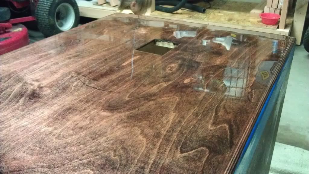

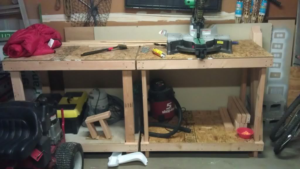

Well is been a while since I last updated this thread cause I have been super busy at work, and have not had a chance to do anything with the enclosures.

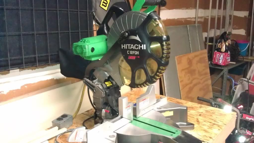

But wifey did give me the go ahead the other day to add to my tool collection. So here is a pic of the newest addition to the family, a miter saw.
With the new addition I was able to build a long needed addition to my garage, a work bench. (actually two)
Ok, ok I hear you, what's that have to do with dual opposed mfw's? So back on topic I go. As you already know, I am to the finishing phase of my build. So I picked up some parks super glaze, at home depot and went for it. Now I have refinished wood before, but I am no expert by any means. Most of my woodworking experience comes from eighth grade woodshop, that was twenty years ago, (god I am old) but I did refinish this

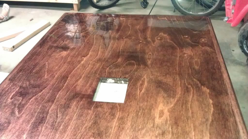

The lighter color is original, the darker is me.... Damn Add, anyway back on topic. Here is a couple of quick shots of the first side I used the epoxy resin on.
and
As you can tell, this sh*@ is shiny, cannot wait to get these done. so looking forward to seeing if they sound as good as I hope the end up looking.
I started finishing the bottom, that way I can learn tricks on the surface that no one is going to see.

The 2nd pic especially looks as if you had palced a thin glass top on that side of the enclosure. I love the look of it. Great work. Love the DIY sub feet as well.

Well the epoxy has dried on the one side that I was able to get it onto (bottom) so I figured what better time, than now to final build the bottom?
I placed the feet that I made into there respective places, and went to screw them into the wood when I discoverd that the clearance hole that I drilled was not big enough for the head of the wood screw. So I had to drill them bigger, luckily I had the proper size drill bit here at the house so it was not that big of a deal.
After redrilling the clearance holes in my feet, I again placed them into there places, and screwed them down, I also took the time to solder the wires to my speaker connection and screw that down as well. So here are the pics of the results.
And another veiw,
I found an issue, I made all my feet the same size, well, +/- .010 but I am tall in the center, I think its due to the fact that I placed my feet near the edges, thinking they would look good, not thinking that I removed stock from there to get everything smooth.
So I am undecided, do I just grind some off the center, or just remove the center foot completly.
The only problem I can see with removing the foot completly is that I would have a hole where it was mounted.
What do you guys think?
Tomarrow, I plan on coating the remaining sides with a sealer coat of poly, and maybe starting the speaker covers....

Sand the center one down or cut some off, or just remove it and fill the hole. It's not like you'll need a center leg anyway, should be fine with the four on the corners. Looks good though...

Agree, remove the center foot and plug the hole. You won't need it.
