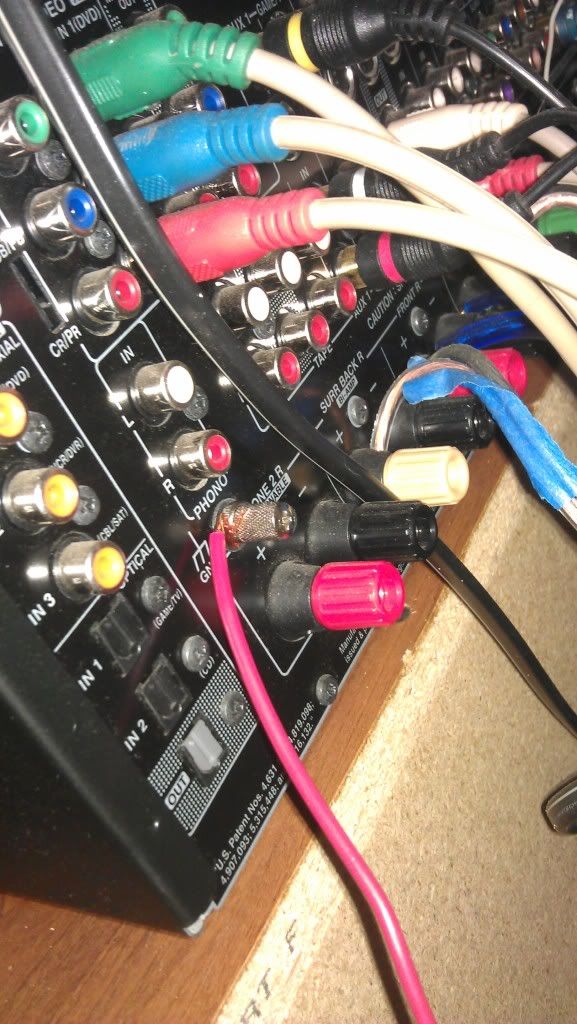

I do have a major hum issue, that I made much better (but still audible). By running a wire from chassis ground on my onkyo.
To the shield side of my RCA before it runs into the y adapter.
This made a HUGE difference, but it's still annoying at low volumes. what else can I do?

Trying to find the source of the hum is beyond my expertise, but things you should try is to disconnect all other devices from your AVR and the outlets first and see if that eliminates the hum. If it does, then reconnect them one at a time to see which one is introducing the hum. If it doesn't then try plugging the amp into another circuit.
duc135 is offline

Real nice build and your woodworking skills for a first timer are excellent ,they must be due to you being a machinist.. being able to measure and cut at the right place.. You just gave me an idea what to do with two spare Adire Tempests I have...
One thing I will comment on and I hope you dont' mind is the Y connector... it looks flimsy I would get a better quality one...

No offense taking man, I actually ditched it a couple of hours ago. It's in the garbage along with my old RCA cable. I just figured I could buy a new cable and try it out, if it didn't help with the hum issue, I could always return it.
But when I plugged the new cable in, my hum, was GONE unless I turn the gains up on my ep4000 all the way.
So for me, a new shielded RCA fixed my problem.

Your shouldn't get a hum at all even with the gains turned all the way up. It could be the rca/xlr adapter that is adding some noise as well, sometimes these are low quality and not wired up correctly.
