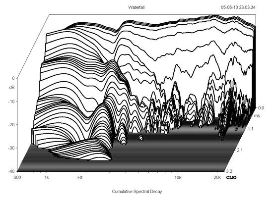

reboxing the speaker into a larger enclosure would increase the extention, and has the possibility to improve the looks, but the aim here is to change the design to a better one.
The woofer begins breakup around 800hz which is already pushing the tweeter. A FR test of the speaker at various output levels will likely show this. That aside, pushing the tweeter that low is going to push the distortion up and at a fairly critical midrange freq.
Baised on this, the first thing Im looking to do is add a mid driver to ease off the distortion in the mid band to low levels.

Looking at lbaccoustics links, the pro audio light paper coned accordion surrounded driver has a beastly motor and spider, a trend I have been noticing as I start to look at these other drivers that have an inferior appearance to me. Maybe this is where my misconceptions began, the fronts of the drivers look old fasioned, light weight, while the back side is beefed up...hence the high efficiency and warm sound?
The pro audio speaker has some very nice features that are not appreciated when you look at them. They go very loud cleanly, and although they have very limited bass and are ugly believe me when I say they are special. That tweeter is massive and by far the heavyest tweeter ive ever held. The waterfall graph of it shows just how good it is-
http://www.troelsgravesen.dk/TW034.htm
have a look at the impulse graph- tight no? These fabric tweeters have very little energy storage.
The bass driver is a paper coned heavyweight monster that surprisingly has quite a stiff cone and lots of headroom. Unsurprisingly to my ears, qts is a mere 0.2 - tight as a badgers arse. I dont get the 'airy' magic that seams to come from pistonic drivers like the excel units, but I get drama and dynamics in spades- but without too much loss of spacious 'out of the room' sound because the cone is still stiff- just damped well.
You mention 'warm sound' - Many paper drivers are indeed warm sounding.... but unfortunately this is actually a bad thing imo. It may sound pleasant, but its the sound of breakup where the cone is deforming in shape as it tries to keep up with the music waveform. This bass driver doesnt sound particularly warm. I can tell its paper- sure, as all cone materials have a signature of some sort ie -they break up in particular patterns. Many paper drivers (particularly full range) break up at all levels because in order to get the bandwidth of the driver so wide, the cone needs to weigh next to nothing therefore its as thin as possible- hence the particularly 'warm' sound.
. I dont particularly want to push any of my drivers anywhere near there limits for this reason (among others). Hopefully you can begin too see why I would consider Jacks design to be close to optimum for me.
