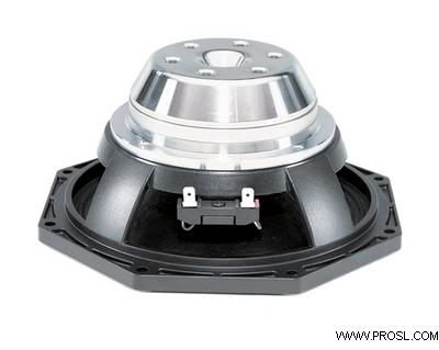

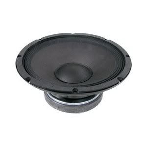

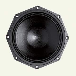

Originally Posted by coctostan View Post
So you want a nice mobile system? There is no need to spend $7500 to do that. It doesn't take much in the way of a subwoofer for starters.
This is what I'd do:
4 MFW-15's in a large sealed box (~13cu ft/driver) with about 100w per driver and a 15hz highpass. I'd imagine in a small space this could get you easily flat to 20hz at ~120db.
A 2-way with a Beyma TPL-150H ($500/ea and 102db sensitive from 1.2khz-20khz) in the kickpanel angled towards the center crossed to a sealed B&C 8NW51. This combo will have sensitivity in the range of 96db and should be capable of over 110db from 250hz-20khz. A 4-channel amp should suffice. Maybe a 4x25w amp. It doesn't need to be fancy and you probably won't use but 5w anyway.
Depending on what you can fit, shove the largest driver you can in your doors to cover below 250hz midbass. Peerless has a good one (http://www.parts-express.com/pe/show...umber=264-1105). Give it about 50w/ch.
For EQ, use 3 MiniDSPs. One for each 3-way and one for the subs.
Doing the math in my head with much rounding, this should be under $3k and will be capable of making you deaf across the entire audible frequency range without breaking a sweat or taxing your alternator. Still crazy, but should be pretty killer. You could do a similar setup in a home theater, bur I do a 2-way with a 12-15" woofer.
I guess I sort of passed this over, when really this is what I was asking for.
Beyma TPL-150H is 10"x10"x6" deep.. tough to get in the kicks but I suppose doable.
B&C 8NW51 Looks amazing. Much more area than the Extremis for starters.
Peerless 835028 10" XLS Shallow Subwoofer. So all this right here would highly outperform what I have now with less power?

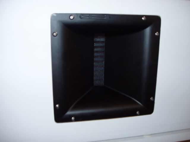

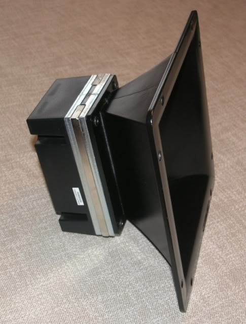

CSS Planar2
Horn loaded planar tweeter
http://creativesound.ca/details.php?model=Planar2

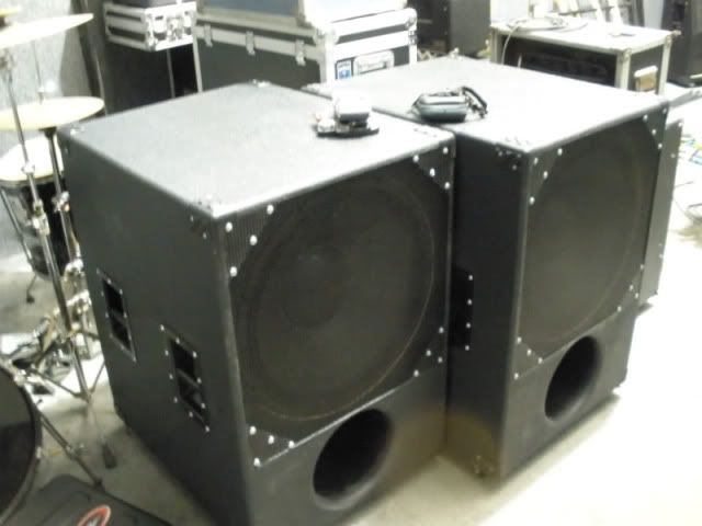

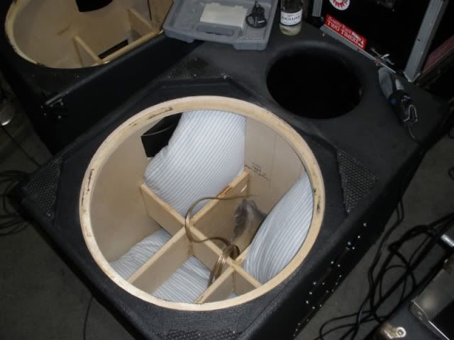

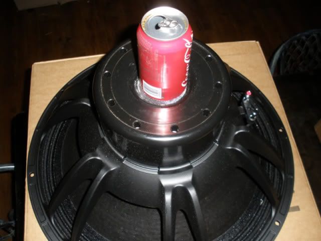

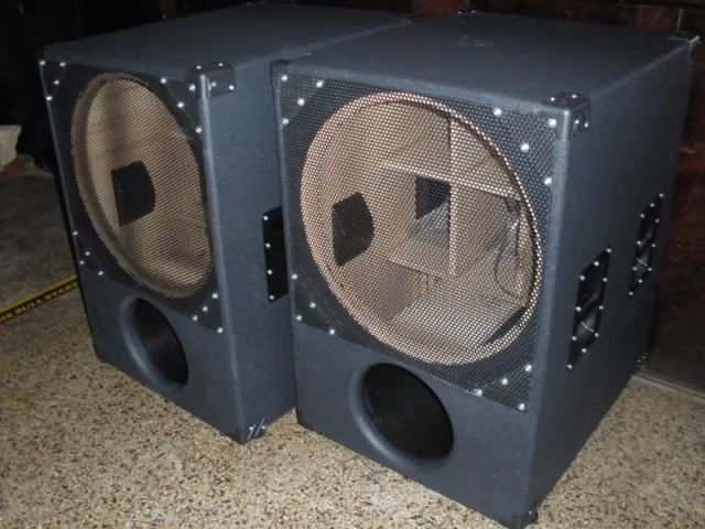

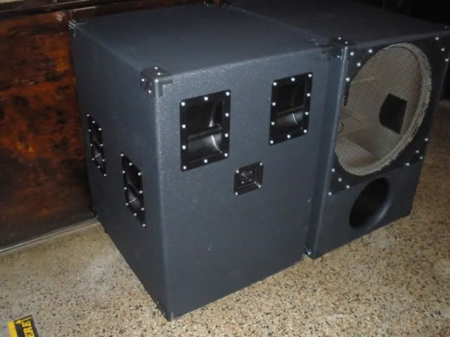

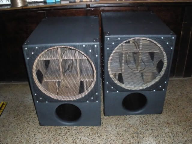

if you could fit 4 of his giant horns in there i think you'd be set for bass. He says they'll do reference level to 15 Hz....outside....at 10 meters. That's NUTS
martiandancer316 is offline
post #100 of 101 Old 07-14-2011, 07:29 PM - Thread Starter
kryptonitewhite's Avatar
Join Date: Aug 2008
Posts: 4,630

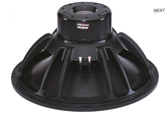

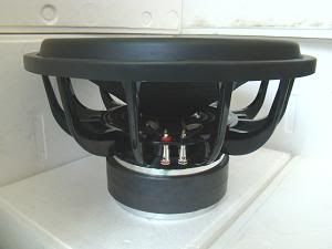

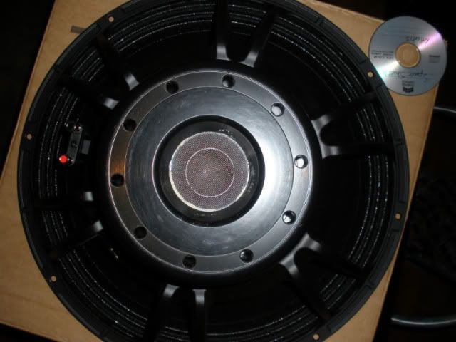

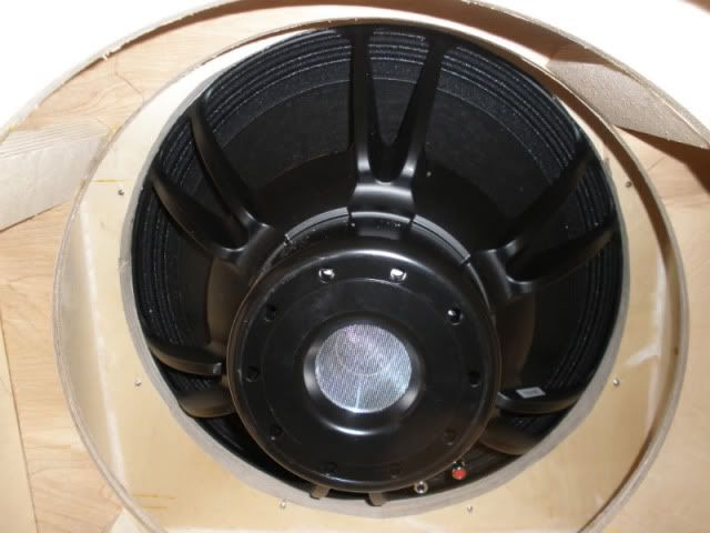

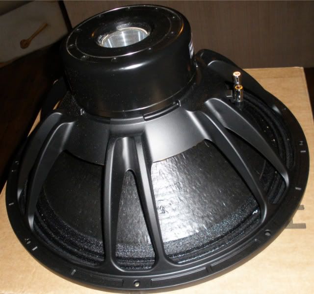

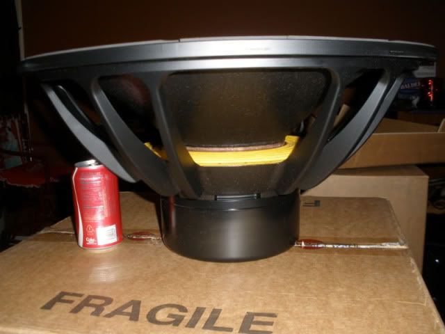

Ive been thinking if 4 could be squeezed into the wall, it is 49" taLL 63" wide IIRC.

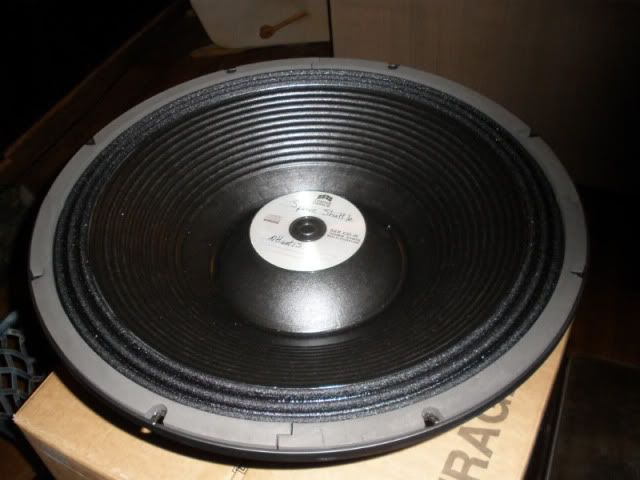

It throws me that the Maelstrom-X has the same Sd but so much more Xmax and Xmech based on Ricci's observations of the B&C having 20mm Xmax and 30mm Xmech.

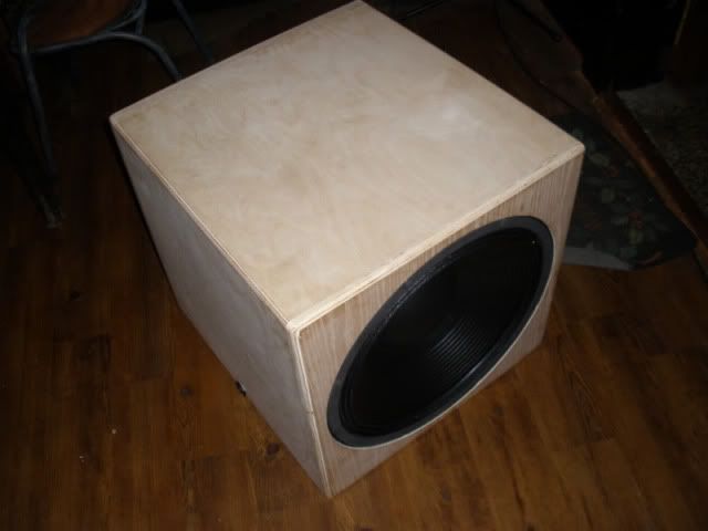

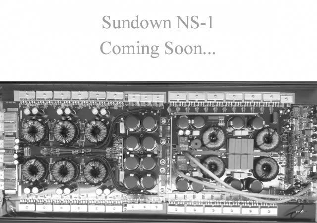

Originally Posted by profundus-sanus View Post
4 slenium st324's= 100$
6 selenium 10pw3's= 300$

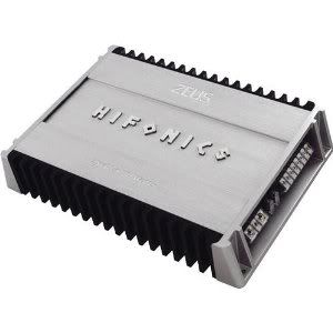

2 hifonics zxi80.4 = 300$
12 obsidian 15's = 1700$
1 sundown ns-1 @ .66 = 1500-2000$(pricing not yet determined)
35 cube ported clam shell tuned in the lower teens = 1000 in materials.
8 deka 9a31's = 1200
100 feet of welding supply.com 2/0 = 350$
350a mechman alt= 700$
that puts you at 7650 and definately what i would do.
