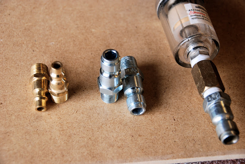

What is an HVLP fitting and how does it differ from a non-HVLP fitting?
How would I know it if I looked at it?
By the way, I use 3/8" fittings, like the ones on the right below.
Some 1/4" fittings are shown on the left for reference.
Originally Posted by Jstslamd View Post
I dial my compressor regulator about 3-4 lbs high and used the cheater valve on the gun just completely dial it in.
Oh, I see. We're actually doing the same thing, just a little bit differently.
You use the valve on the gun to dial it in and I use a gun mounted regulator/gauge.
You have a good point about trying to avoid restricting airflow.
Just out of curiosity, do you use a gauge on your gun, or do you dial it in with a few test sprays?
PassingInterest is offline

The fittings on the right are an HVLP fitting. They are just an older style. As far as dialing in my gun I've been doing this so long I dial in by ear and yes pulling the trigger a few times to confirm that I have an even pattern. I also sometimes leave my cheater valve all of the way open until I need to lay a drop or orientation coat and then I close it up a tiny bit. But leave the air flow open and much as possible is the ticket.

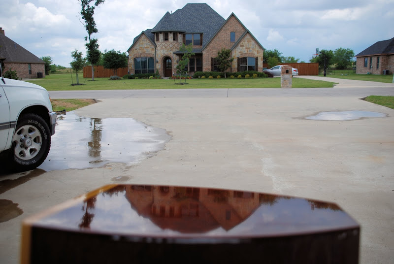

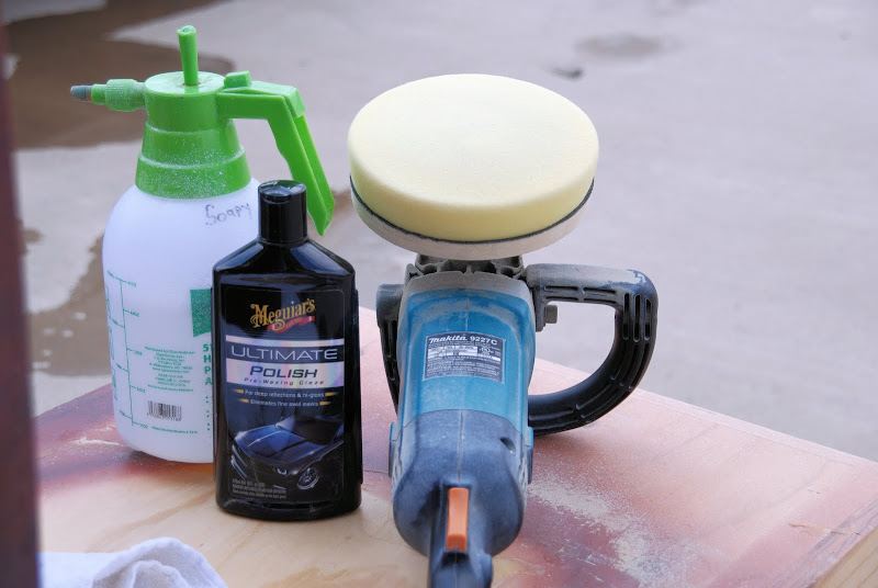

I polished the bottom before I thought to grab the camera, that's why you see some gravity-defying runs in this shot.
I began by dry-sanding with P-400.
Then I used Rubbing Compound.
Then Polish.
The photos came out better than I hoped, considering it is very overcast today.
I machine-applied wax, then hand buffed it.

Damn... Even though it goes without saying, I'm going to say it anyway: Beautiful job! You're obviously very skilled and have done a fantastic job on everything. I also love your attitude toward helping all the rest of us who may not have the skills or knowledge for these things.

TC--Rubbing Compound and Polishing Compound are like liquid sandpaper, with Rubbing Compound being the coarser of the two at about 1200 grit or so, roughly. There are actually many grades of coarseness. An Automotive Finishing Pro like jstslamd could give you a better rundown of the different compounds than I could. Oh, and there are some that break down as you use them, becoming more fine as you go.
