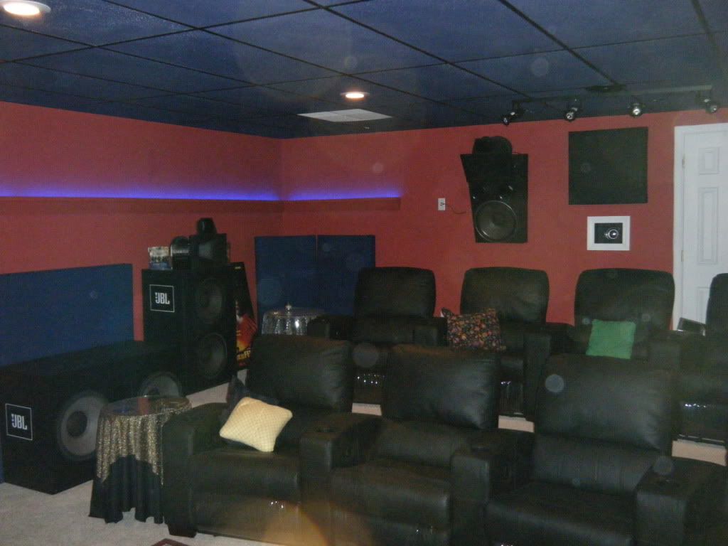

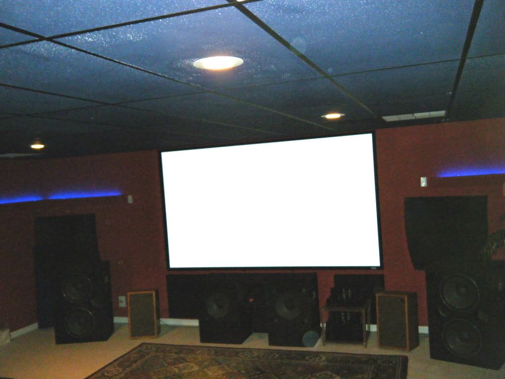

I love seeing new folks running the big JBL Cinema gear. I just wish my cabs looked as nice as yours nichol...all mine are oe flat black.
I've been running their gear for awhile now...I just love the effortless output the big JBL's have.
btw I'm running 4675 mains, 4670 for center and side surrounds(center channel has been modded to fit under my screen). I built a pair of matching rear on-wall surrounds each using a single 2225h 15" woofer and 2445j comp driver/horn which are the same parts used in the 4670's. I've added Selenium ST350 supertweeters to add some sparkle to the big horns.
For subs I running dual 4645b's and a 4642(with 2242 drivers) in oe cabs. From 20hz and up these subs are hard to beat in terms of sound quality and output.
Some pics(sorry for the bad quality)
[IMG][/IMG]
[IMG][/IMG]
For size scale of the front speakers...the screen is a 133" Dalite HP(lit by a JVC RS1).
Wow. That is some serious firepower!!
How do you like the 4675 compared to the 4670 in terms of sound quality?
All my speakers use the same 2445 compression drivers so the difference is really in the horn lenses used. I noticed a bit better imaging and fuller mids from the 75's...the 70's have a bit better high end response...kind of a trade off really. Since adding the super tweeters to each channel I'd love to run the big horns from the 75's all around if I had room.
KenWH is offline
