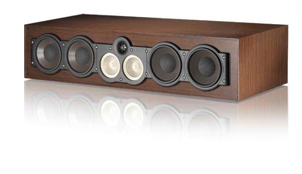

Yeah I was thinking about building a new tv stand with a more robust design, and a built in space for my center channel..
I really had my heart set on..
But they dropped that bad boy when they went to v7.. (series 7).
So what could I build to match the sensitivity, and sound of that monster?
Plus, that mother looks mighty impressive, for that WOW visual.

Check out Audiogon for used or new old stock. Avg price around $500 plus shipping. Adding one of these or similiar would really help with dynamics

so that speaker, the cc-390 would be a major improvement over the klipsch snergy C-1?

Immensely so! The alignment alone will show you a big improvement with dialogue intelligability and the dual mids/dual woofers will yield big gains in dynamics and bass response considering that 70% or better of todays film content is mixed to the CC.

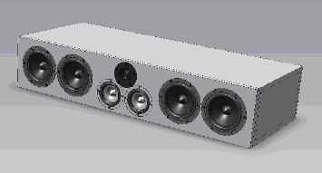

Not sure about sensitivity, but the overall look is similar:
http://clearwaveloudspeaker.com/Dynamic/4CC.html

similar? damn looks like a copy to me, other than the sensitivity as you mentioned..
vs
Which is why I went klipsch in the first place..
What else guys?
Nice find max....
88db/2.83v/m. Hmm. And even that looks optimistic based on the FR. I'm shocked that many drivers can't muster up more than that.
There are a few centers on the DIY scene that have that type of configuration. Maybe not 4 woofers. But stacked TM with flanked woofers is common enough.
It looks like it should do more than 88dB....but I guess not.
100W will only net 108dB at 1m. You'd need around 300W to even get near reference at 4m, as long as the drivers could take it...

the paradigm cc-390 sensitivity is listed at.. 97db.
the clearwave clone is, listed at 88db.
But I am considering buying the rc-62 if I cannot find the paradigm...
Then once I get enough money for the geddes set up, (or the pi, still not one hundred percent which) I will sell my whole front soundstage..
@beast did you build your jtr's? checked out the website and they look nice, but didn't see any DIY plans, or links..
Nope, i got them from Jeff already built. He has dont a lot of work and due diligence on the xover portion of the speaker and the value really shows through. They are spectacular. AFAIK there are no DIY plans available from Jeff.

I plan on staying away from the clone..
If I don't go DIY, then I will go with a design of similar sensativitys as my mains..
Paradigm monitor 11v6. is said to be at 97db.
So that means a high efficient center is a must to be able to keep up..

That RC62 looks nice, but 98dB with 2.83V in. Depending on impedance, that can be much more than a watt. Under impedance it says "8ohm compatible". Not sure if some specmanship is going on there....and they do not spec if it is a 2pi (groundplane) efficiency spec.
Also, for Wayne Parham's speakers, please do pay attention that his specs delineate that they reach the dB sensitivity mark with 2.83V in quarter space, or wall-loaded (except for the corner horns, which are of course corner loaded, and the 12pi sub which is a groundplane spec). This is different than a 4pi (freespace) specification.
Granted, most will use Wayne's speakers in a 1pi environment, and 0.5pi for his cornerhorns, and they will see this efficiency.
Odds are Jed at Clearwave may spec his for 4pi space, netting the 88dB rating, which may be bumped up inside a room. But the best place to ask is over at his forum.
97db from a dome is really questionable IMO. I find a lot of commercial designs skew this spec. And I'm a paradigm fan

I think they are referring to "in room", not outside.
But the selling point of the monitor line (especially v6) was high sensitivity..
But I am with you, I think I have seen the measured spec (third party) placed around 94db.
Which is still high, but not quite as high those horns...
