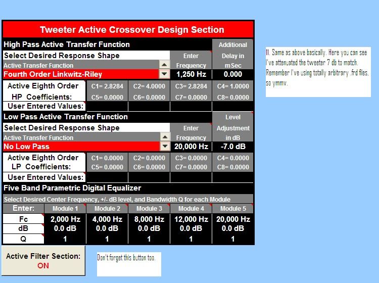

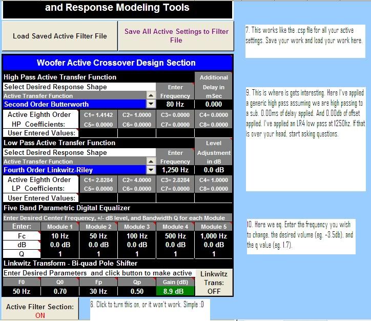

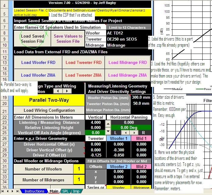

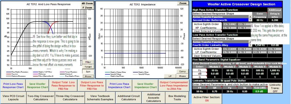

Ah, thanks again. See all these things we learn. Hopefully someone can learn from this:
Ok, here we go.
Start up PCD and follow these instructions.
PS. I'm trying to use the avsforum image management system. Not sure I got it right.

Ah shoot. I can't attached the .csp and .ftr.
If you want them, pm me. Or you can just follow the steps and create your own.

Those look terrible. Photobucket is just plain easier.
These might not last forever though.
