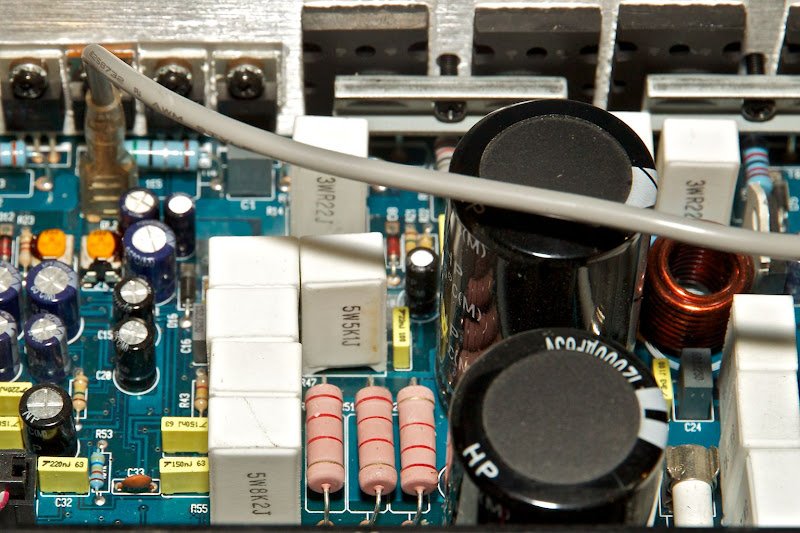

Sept-24-2011 I posted in this thread, My EP4000 is getting hot very quick , but my issue seems different so making a new thread.
When it's hot, it's HOT, my amp I mean.
My EP2500 still works, but runs too hot as posted in the above AVS link.
I've been using it for only 2 hours max at a time, then off with the HT.
I finally had time to take the EP2500 out of the rack this morning, take the cover off, and inspect it.
Everything looked "ok", nothing looked "burned" brown/bubbled, etc.
Plugged it in the wall, turned on, nothing hooked to it at all.
10-12 minutes later, look at these temps, taken with handy IR thermometer, and felt with my fingers.
What are those white ceramic (I think) things that are getting so hot so fast, w/o any signal?? either they are at/near room temp 70's, or cooking HOT.
Any idea/suggestions to trouble shoot this??
All the other components feel just "normal".
I will cross-post this at my other forum, IB Cult, as a lot of guys there also use this amp.
Those are resistors

FYI:
The fan mod was the 1/2 speed fan for lower db, and direction reversed from stock.
>>I just flipped the fan so now flow direction is stock.
>>Fan goes on instantly when turned on
a) Waited 4 minutes, and everything was getting quite hot.
b) After 30 minutes of "idling", the components are all at their same "HOT" temps, but the alum heat sink is dramatically cooler (top) than before and the exit air coming out the front is not hot at all.
>>In hindsight, looks like from this issue I can clearly see Behringer engineered that heat sink/components/air flow as a system to efficiently dissipate heat instead of letting it build up, and airflow of the sink definitely is part of the engineering.
Picts of white ceramic components
70 deg f components
180 deg f components
140 deg f components
[update 5pm]
2 full hours later its stabilized, exhaust is cool, those specific components are HOT, but the alum heat sink is just warm, 90's, and only in certain areas.
I'm putting the EP2500 back into the HT.
Would recommend only the low db fan, and keep stock airflow direction.

The fact that those resistors are in ceramic cases would tell me they are designed to survive at high temp. So...if the amp is working fine, I wouldn't worry about it.

the EP2500 idle current is 0.4amps w/o any signal.
When you say 0.4 amps it seems innocuous enough. But put your hand on a 40w incandescent light bulb and you'll get a better idea of why you shouldn't be reducing fan capacity or reversing airflow.
They're rated at only 3 and 5 watts, so it's not going to take that high a temperature to cook them.

Not at full reference level, about -12db, still gave the amp a decent workout.
Good news: working fine and running just warm, not hot!!
I think the mystery is sorta solved - and definitely advise people do NOT mess with airflow direction unless you know the "whys".
For my knowledge: why does the amp at "idle" take 0.4 amps? Just to keep the capacitors fully charged??

Amps are biased slightly (current running through the outputs) to reduce/eliminate crossover distortion. That is not crossover like a speaker, but crossover from switching polarity in a sine (signal) wave. True class A amps (not these!) are fully biased, and thus have huge mass, and not a (relatively) large amount of total output power.

Awhile back I reversed the fan on my ep2500 as well. It seems logical that drawing the air through the filter and out the back would work best but instead it runs hot as hell. I even added tape from the fan to the shroud to ensure the best draw. So I put mine back to the original direction and slowed it with a zener diode. Runs quiet enough and never more than vaguely warm even when blasting the IB at 120db+.
the fact that the fan is trying to push air which is less dense (already heated) might explain part of it.
This discussion on idle power consumption and heat, hits on why I am not as much of a fan of these amps compared many on here and other forums. But lets face it...considering the price and power output, there has to be a compromise somewhere, right?
In the winter, the heat isn't such a bad thing. In the summer, you are paying for the electricity to make that heat, and then paying again for your A/C system to remove the same heat.

Those look like ballast resistors for the outputs.
Are you sure the thing isn't oscillating, perhaps ultrasonically? That would heat it up quick...

I have a new EPX 4000 myself and fortunately I have my rack behind a door so the fan noise was not objectionable. I was going to look at using a NTC thermistor inline with the fan(s) such that when the temperatures inside the amp was low (e.g. not working too hard and thus SPL output is low) the fan would run slower (less noisy). As the temperature increased, the fan would run faster. i.e. the NTC thermistor has lower resistance at higher temperatures.
Never thought too much more about it just an idea......
BTW, just a word of caution opening up those amps.... I noticed in the picture they contain several 12,000 uF capacitors that can stay charged up long after you pull the plug and give you a nasty shock (or worse). Be careful poking around with stuff inside there....
