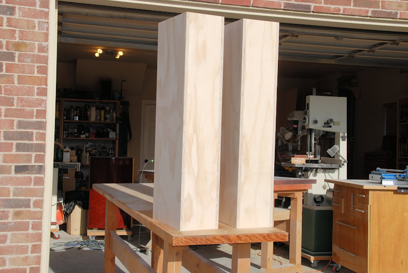

Cleanup.

smokarz--You have a good eye, man. This is indeed Aruco. It is a very good value in plywood.
May I ask where did you find the Aruco around here and how much did you pay? I've looked at my local HD and Lowes and haven't found any around here before.
Sorry about the typo--it's actually Arauco.
I got it at the Home Depot in Terrell, Texas at $24.97 for a 4x8 23/32 sheet.

Originally Posted by Dusty Shopfloor View Post
Anyone want to recommend a finish for these?
I am undecided at this point.
Do you care if the plywood edges are visible? Is laminate or veneer an option?

NateTTU--Yes, I am PI. Blame my off-beat sense of humor for the confusion.
I'll let you guys know when will be a good time to come and hear the Stentorians.
And, I'd be glad to share any information I have on building curved cabinets.
BeerParty--I don't mind if plywood edges show, as long as they look good and I think these will. Laminate is not an option and neither is veneer.
