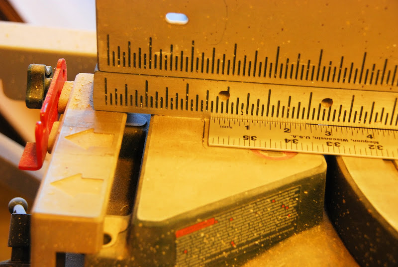

I am building according to Curt's PA Column option.
I need 2 Tops and 2 Bottoms which run the full 15" front-to-back.
Set a stop (red tab on the left.
The cut looks good. The lighting is poor, so I get a lot of yellow. I don't feel like correcting for it.

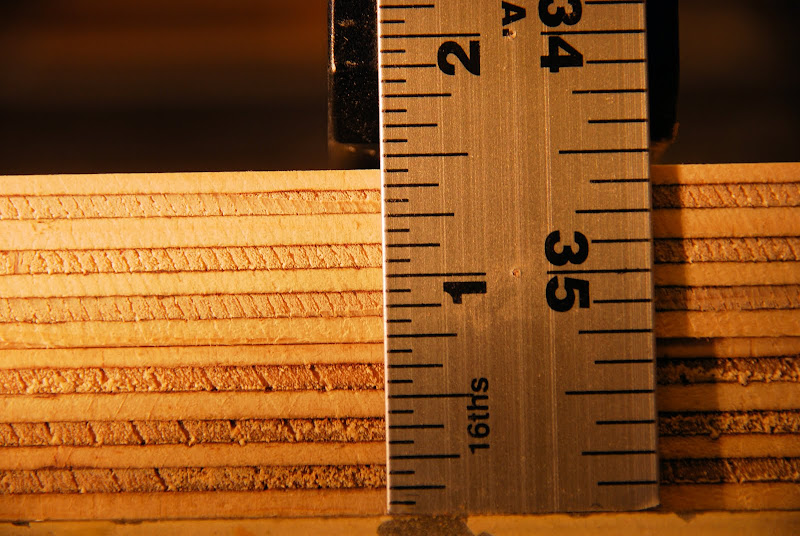

Next, I need 4 internal shelves. Each mid-woofer pair is in its own sealed chamber. Since these are internal, I need to subtract out 1.5" for the thickness of the front and back (3/4" + 3/4"). Right?
Let's double-check, just to make sure.
Okay, the thickness is 1/16" short of 1.5". So, we'll compensate for that when we set our stop.
Looks good.
I need 4 internal shelves at this setting. So far everything has been 3/4" (approx) plywood. I'll use 1/2" plywood scraps for bracing. I need 4 braces cut at this same setting.

This is where a cross-cut sled comes in handy, since the 4 sides are too wide to cut on my miter saw.
Dusty Shopfloor is offline

Here's a quick, easy way to do conversions, without leaving your shop.
