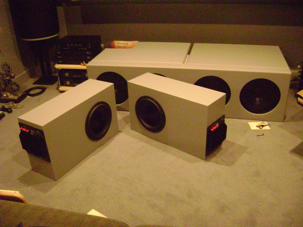

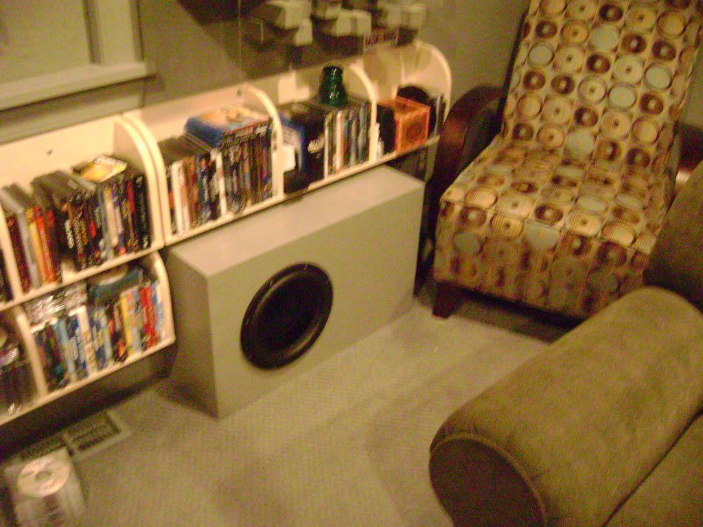

here is the new location for sub #2. Here are the two subs.....

Well, the new system is up and running after some issues. First issue was the massive hum out of the main subwoofer system once i hooked up the MiniDSP.
After doing some postings and reading i ended up doing a chassis ground from the Mini to the outlet it was plugged into. That was a perfect fix, totally silent !!!
The AUX subs were a different story. Only way i could get them to quiet down was ground isolators from Ratshack. They are not free from the hum as the mains, but unaudible from the LP...
The fit and finish of the new subs makes them look like they have been in the room for ever
