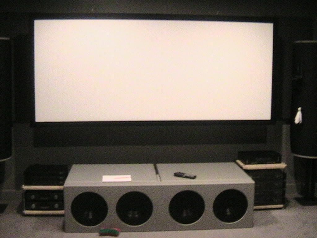

This is my thread about multi sub position to cancel room modes at the listening position (LP).
After experimenting with some BIC subs i had on hand i discovered the Welti/Devantier nailed it to the wall !!!!
I ended up building two subs using Dayton drivers and amps to help "Tune" the LP.
The subs are built, just waiting for the MiniDSP to arrive....
****** Warning ******* If you use a modified multisub system like I did, make sure the AUX subs match the main subs output ability, if not they will limit the systems total output capabilities, like my originals did, I'm now working on the upgraded versions......

So, i can use my quad 15's, as one system as it is. Then the idea is to augment the mains with subs on the side and back wall. Wait, more subs and more amps..hahahahahaha. More days in the garage with my table saw...with mobile casters to aid in mobility....There is a Santa Claus.
Will the new subs need to be sealed like my mains to blend better, and is it neccesary to extend their response, like my mains...
More subs Bahahahah.....
I flank my mains with the dual subs I have now, have measured the results and the improvements made are significant, especially with respect to dealing with the main's floor bounce nulls. I plan to add two more following the Geddes or Romeyn method while retaining the flanks.
A good discussion describing the positive effects of flanking and multiple subs. http://www.diyaudio.com/forums/subwo...ubwoofers.html
