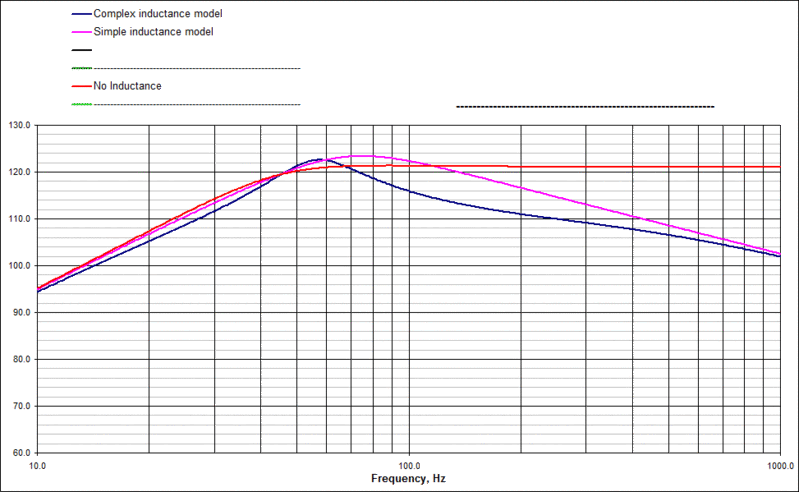

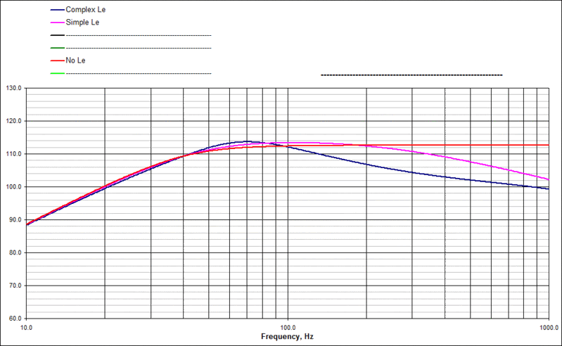

For those that might be interested in the side conversation Josh and I are currently having, I made an example model of how inductance (Le) can change the response of a particular sub driver in a sealed box. The numbers (save for Le) are constant. Nothing is changed except that one model has no inductance, one has a simple model (how I've almost always done my sims) and the last includes a complex model that is supposed to be more realistic.
Levels were kept the same, hopefully not too confusing to look at but this is how much the response changes just from this one lil spec.
EDIT: Sorry, just to clear it up. This is Ricci's tested Fi Q18d2 from the previous page using the T/S numbers extracted from his woofer tester device. This was a good example to use as there was some real world Le numbers to use for this.
Amazing.

Originally Posted by Ricci View Post
Well your Unibox sim seems to be really close to the WT2 sim and the measurement so I'd say that it is factual. Unfortunately I'm not really digging it to be honest. Sensitivity is really low everywhere other than the peak, the response is all kinds of peaky being 8dB down by 100Hz already and it looks like in order to be used in a small enclosure it is going to take a serious powerplant to make use of the displacement capabilities for signal peaks. I hope the Xcon or SSD is different.
Neither am I. Quite a bit of these lower Q subs have the same problem and without knowing the actual Le (most drivers, especially Fi) it's hard to tell for sure. Though I have noticed quite a drop on the low bass side of the peak. I don't believe the Xcon or SSD are very different but I don't have 'real' Le figures from either one of those to say for sure.
If anyone is curious. I can throw out some other models to compare relative Le from one driver to another.
Ready to take some serious flames here but I have always believed and still say inductance IS important even for a sub driver. Just my opinion.

Note that sensitivity drops almost everywhere in the blue curve above including >2dB at 30Hz and drastically at 90Hz and beyond.

The TCSounds LMS-U version:
Even the king of all sub drivers is affected (well, obviously) from Le but notice the difference compared to the Fi Q18d2.
That's what a $1,000 driver ought to model like, me thinks. At least you get what you paid for.

Here is a very simple simulation of the 1w spl of the LMS, 21SW152 and an SSD18 D2 all in a 4cu ft sealed enclosure. Below 30Hz the LMS is the most sensitive by almost 2dB over the others. The SSD and 21 are almost identical.
Attachment 234417

Sure. Thanks for the link, btw. Needed to add the 1243d to my database anyway.
Model in 2cuft sealed cab. Not bad.
Scott Simonian is offline
