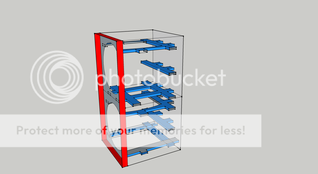

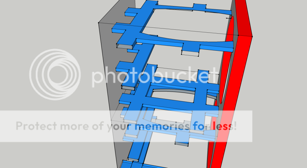

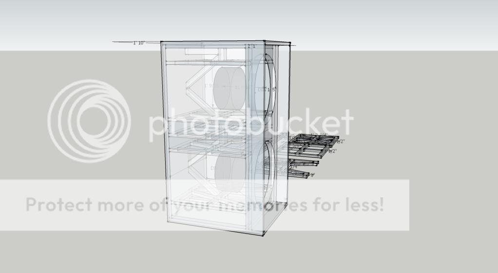

In the planning stages for my dual LMS Ultra.
A few questions about wood, glue, bracing and a proposed faceplate:
Wood: Baltic Birch, Arauco, MDF Which one to use?
Glue: Titebond, PL400, PL Premium Whats best, dependent on wood???
Bracing: This is my first attempt at designing some sub braces, need some critic, too much, not enough, not properly done???
Faceplate: I have an idea about constructing a faceplate made out of fiberglass and/or combination of wood and fiberglass to cover up the face of the box leaving only the cone and surround exposed (flush mount look). Much like the car audio guys do for show.
Question would a faceplate vibrate and be a bad idea?????
Are in red showcases roughly 2" lip were proposed faceplate would attach too sub box.
Box Dimensions: 22 wide, 44 Tall, 22 Deep
Rough Sketch, just an idea were Iam going

faceplate: no, unless you're running dual opposed, it will not be happy. Just flush mount if you want that look.
wood: go with a ply, either BB or arauco is fine
glue: depends some on your woodworking equipment and skills. If you can create tight/flush cuts, you can use titebond just fine. Otherwise, you should use PL. I used PL anyway just because I like overkill, though it is messy and harder to work with.
bracing: little ridiculous, and the flat panel facing the subs may cause reflections. Are you sure the motor will fit ok in that setup?
I agree on the holes in the braces
Reflections not an issue unless he's going to run above a couple hundred Hz

Could I get someone to help me design proper bracing to ensure a super stiff cabinet, weight is not an issue.
3-4" wide strips of plywood from the main panel scrap placed every 6-8" from one panel to its opposite panel. Window bracing like what you show is a waste unless you are CNC'ing everything and want to expedite assembly.
NotNYT's bracing is a compromise between the strips and wasteful window bracing.
I think people put way too much thought into making some sort of super structure out of their bracing. This isn't a suspension bridge.
On the other stuff, I'd take NotNYT's advice. You are basically replicating his project. I'm sure you could do a fancy "faceplate" but I'm not sure it would be worth the effort. I'd just do a double thick baffle and recess the drivers. Roundover or chamfer the front edges and finish it.
Your braces are pretty much like those below left, which puts most of the material where it's least needed, in the cab corners. Below right makes the best use of material. A distance between connection points of 8 inches is OK with 3/4 inch panels, 6 inches is fine with 1/2 inch panels. There's no need for or benefit from making them one piece.
I'd also make two cabs rather than one. You can't control room modes by splitting a single cab.

+1 to bill, if you're only using two woofers, I'd split them.

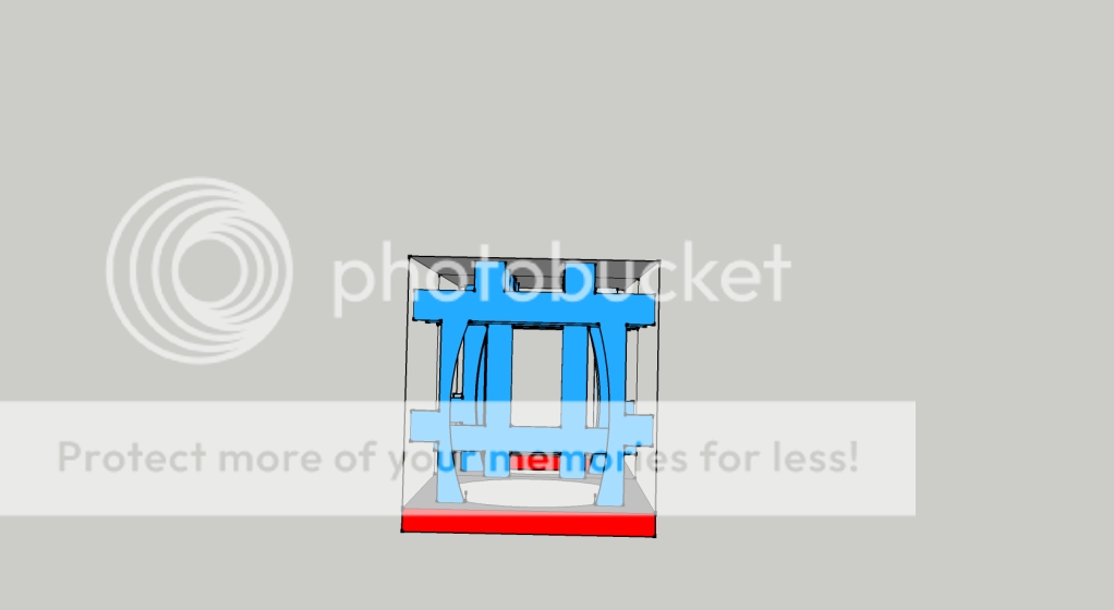

^^^^I dont have any experience with fiberglass/resin. A local car audio shop would have to pitch in for that aspect of the build.
The "tic tac toe" bracing I can do, lay all the braces horizontal? or both vertical and horizontal?

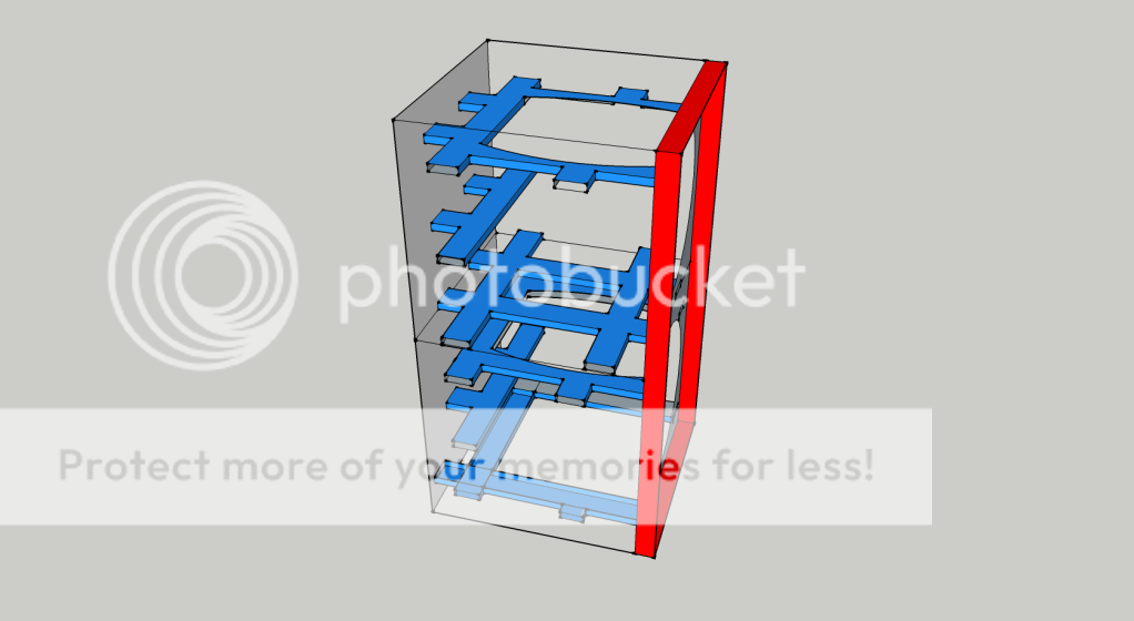

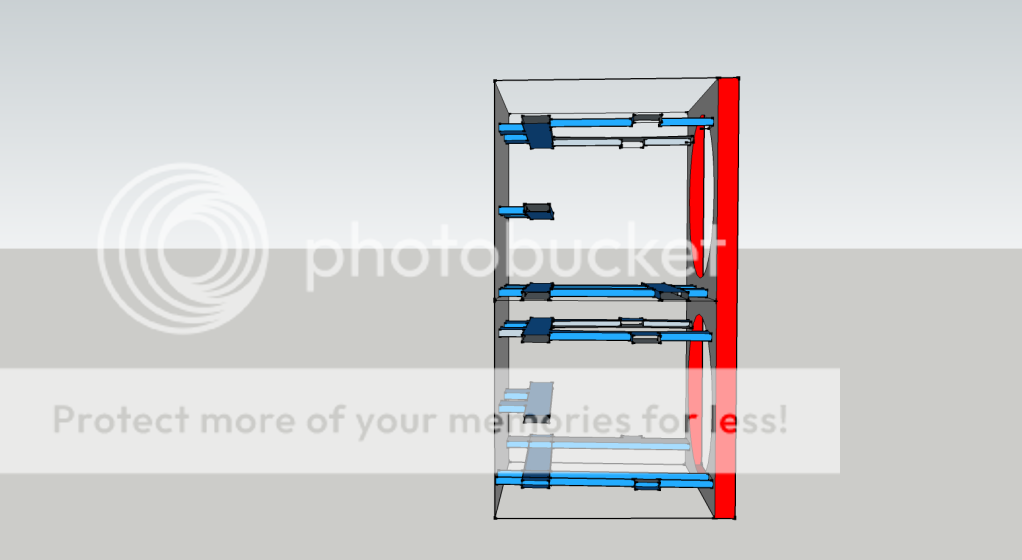

Iam I on the right track, better...worse.....vertical bracing???

You still have contact points closer to the corners, which don't need bracing at all, than to the center of the box, where it's needed the most. Top to bottom bracing is just as important as side to side.

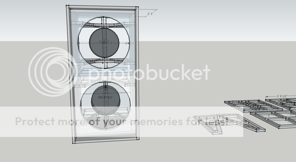

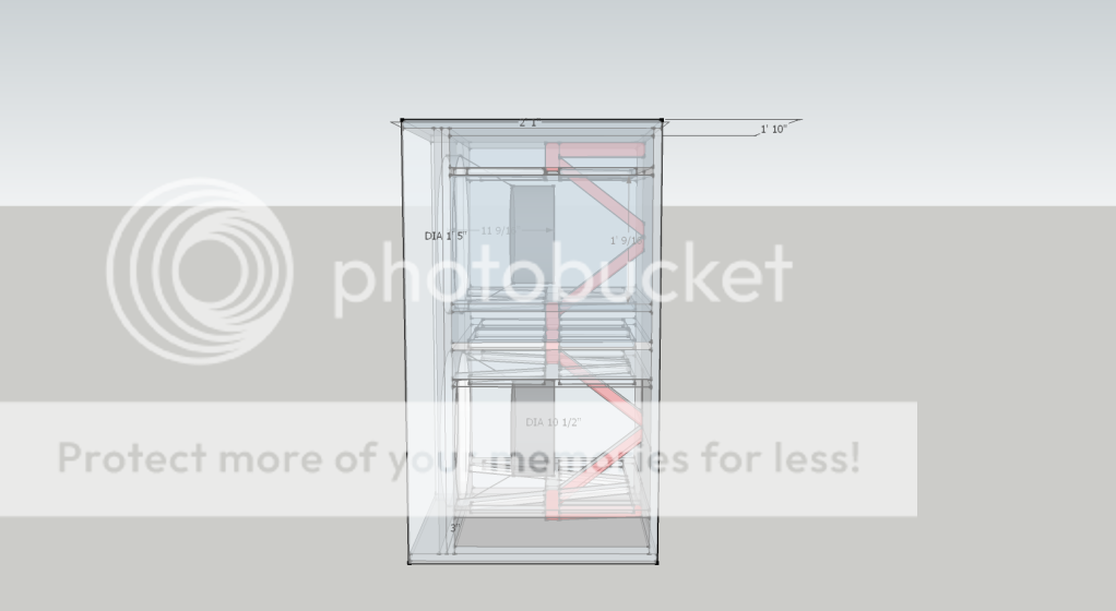

Iam having a bit of trouble figuring out the vertical bracing for my boxes. These drivers are big and dont allow much room behind them for vertical bracing, unless I offset the bracing further back which puts the brace closer to the back wall. According to Bill I need these more towards the center "middle" of the box.
Also I have been told the vertical brace sitting behind the driver can cause reflections.....so how much bracing can I have before this becomes a problem.
bodhisafa is offline
post #18 of 121 Old 01-22-2012, 10:04 AM
Bill Fitzmaurice's Avatar
Location: New Hampshire
Posts: 15,491
Liked: 5687
Make them V shaped.
Up to 1/4 wavelength across.
Bill Fitzmaurice is offline

This is why I used double plates for the top and bottom and no vertical bracing in mine. You can use some heavy dowels, but they'll end up so close to the corner it wont really help you any.
Some 2-3" strips of ply between the horizontal bracing on the back/sides will work fine. Some may say the bracing in my cabs is overkill, but works quite fine for me as the cabs are very solid/inert.
EDIT: as Bill said, you can go diagonal as well, from the middle of the top at a 45' angle or so to the back, and that should clear the motor structure.

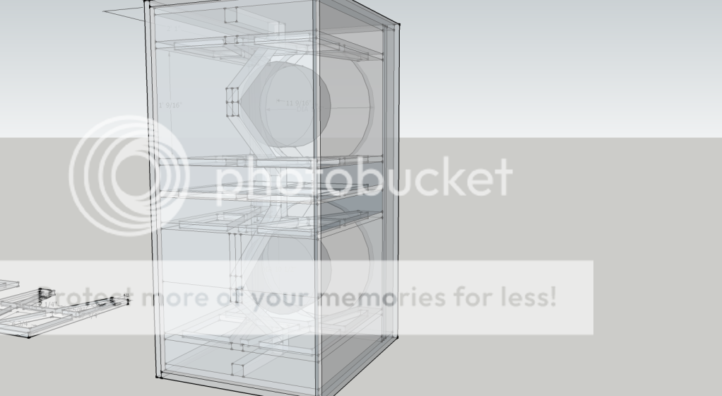

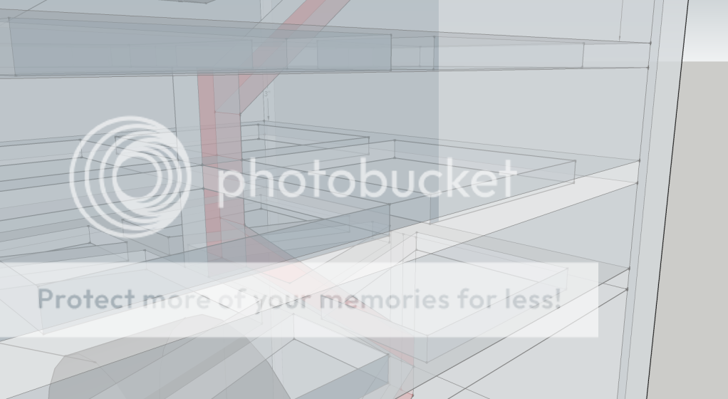

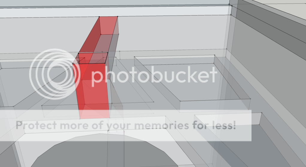

Ok gentlemen, this is what I have so far. Implementing Notnyts bracing (really the only thing that fits given size constraints). Box is 44" tall 22" wide and 22" deep. Still contemplating faceplate idea, that would add another 3" to the front as shown in model. All bracing is 1.5" wide, 3/4" thick wood.
Vertical bracing in RED, using dowel square rods or similiar product.
The middle window bracing
The V goes in between the A cutout
post #21 of 121 Old 01-22-2012, 04:15 PM
Posts: 15,491
Liked: 5687
Looks good. You've still got a lot of transverse bracing on the panels, which does very little, while adding weight and build complexity. If the extra weight and work isn't a concern go for it. If you do keep them don't cut the braces whole from plywood, cobble them together in place in the cab from plywood strips.
