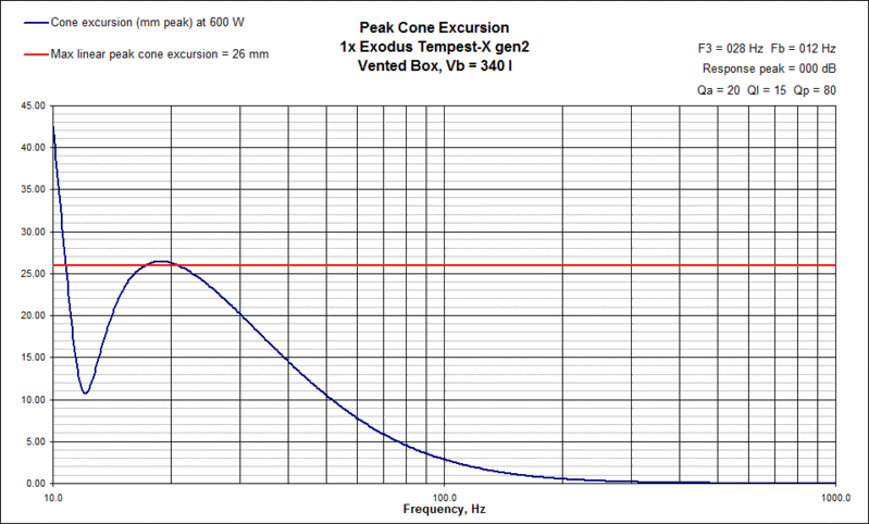

An LLT isn't really any harder to design than any other of the popular alignments. It's just a larger than usual vented system.
First of all... which Tempest? The older style from Adire or the newer Exodus Tempest-X? You mention that you have two drivers. Did you want them each in their own enclosure or separate? How large of diameter and height are we looking at here?
Fill me in on this stuff and if you think you've got the chops, you could start building soon and be done for the weekend.
Thanks scott! I have a pair of tempest x-2's (the last two I think Kevin had) so they are the most recent exodus line. each in the own enclosure would be the deal, and I guess diameter would be whatever size tube I could get my hands on, I dont know where to find tubes like that. I have at the most, 7 feet of height to play with and size doesnt matter (contrary to popular belief)

Also, what kind of extension are you seeking? What kind of amp will you use?
Call up a local contractor of wood and concrete. See if they can help you. I called a general building contracting company back when I needed 8" sonotube for the ports in my current LLT's.
I'll start doodling with some sims, you find out where you can get some sonotube.
Got a 12 foot 18 or 24 inch internal diameter tube that I can pick up before 4:30. cutting directly in half would yield two 6 foot sections I could utilize, thus only having to buy a single tube, i can cut to length once you have a good model up

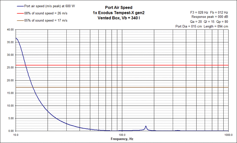

Kevin suggested a 340L (12 cuft) 12hz tuning on the LLT he outlined in his white papers for the tempest x-2
alright so I need to just get some pegs for the bottom and some 6 inch pvc for the port and I should be good to go.
EDIT: that 12 hz tuning should get me flat to 10hz in room @ 115db

That's a good start and pretty much what I was simming with. Get which ever one you want to use but that 24" one will have the most volume per foot of height. Obviously. I'd go with that size cuz a 6' 18"dia sonotube will barely get to 300liters of net airspace. A 24"dia tube could get up to 500liters at 6' tall.
What kind of amp are you going to use with these?
This is what that models like @ 600w a piece.
with the 18 inch tube the full 6 foot section would only yield 10 cuft, I wish that would work, if it does id rather do that. if not, ill go with the 24 inch diam.
Ill be powering with my epx4000 but can downsize to the crown xls2000 I have on standby if need-be, although the epx should be a perfect fit for two cabs.

OOO thanks for the sims!! would going to that 300L sonotube bring the corner up significantly? I want the lowest tune possible but still seems we go over xmax above 10hz and barely over near 20. Makes me a little nervous but the 20hz is so little over it should be ok right?

I wouldn't shink these anymore than the sim'd 340liter, imo. Wouldn't be much of an LLT. My vote goes for the 24" diameter tube if you can fit it.
Yeah, I sim'd with an ep4k equivalent 600w per channel so your epx would be perfect. You would be okay. That sim shows not even a full millimeter over Xmax. More like .5mm over. Lol, you'll be fine.

You're looking at a full length, three foot long tube for the port. Start there and if need be you can cut it down. I had to do the same with mine... but I never cut them down. Kept the low, low tune.
While you're there, get that or use the PVC pipe. Get the 24" tube and have them cut it down to anything between 4-5ft in length. I'd swing towards to the higher end of that range but it's not completely necessary.

Gonna be a tight fit that port in a 4ft tube.
well as close as I can get then I am 100% ok with going to 5 foot tubes, Ill have the supplies to do so and the space is fine.

Just makes room for the port without butting up against the driver on the other side. Better to have too much room than not enough in a ported alignment. The extra excursion is minimal. Like, one more millimeter used up. You'll be good.
