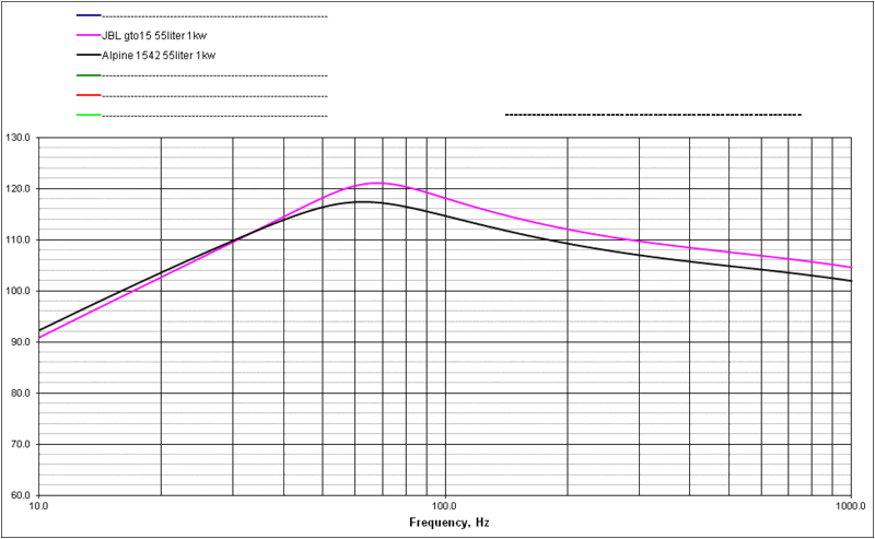

Hmmm... these model very well. At $200 a pop, sure would be hard to resist. I had to stop myself from ordering four of them on Amazon just now.

These drivers are pretty different but both good when used properly, I would think. Kept the parameters the same for pure comparison.... plus... I'm tired.

Yeah... I'm really trying to not order the 15's right now. Per my own sim's, quad 15's in a sealed enclosure ~210liters is within a decibel of my own models for the sealed cab I'm going to build for my RLp's. Soooo close.
