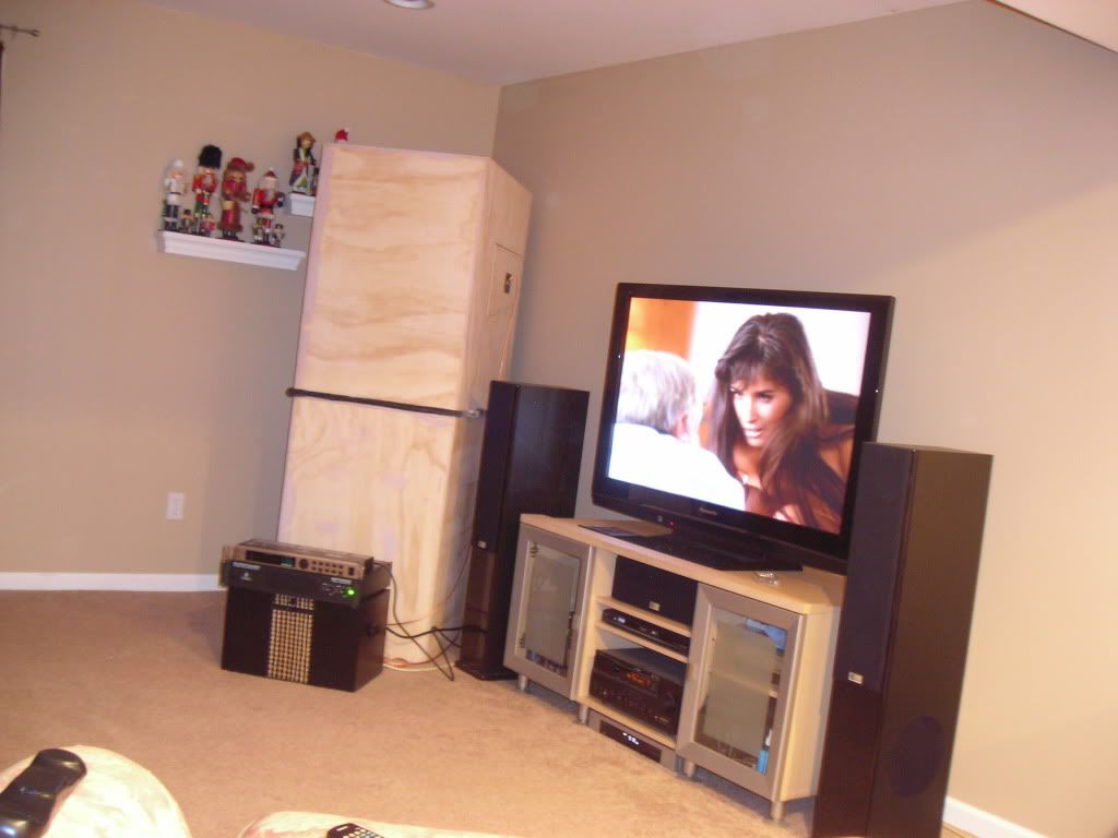

These are just a few pictures of the build so far... I'm hoping to make a lot more progress this weekend now that I will have a driver. As far as finishes, I really like the look of the some of the piano black THTs. Is it much more difficult to finish it in piano black vs matte black?

Well I've made some progress on the build and am going to try and embed some photos.
Cutting the hole for the driver in panel 3.
I test fit the driver and everything went well but the hurricane nuts I'm using overlap the plywood a little bit. It looks like the driver would never make contact with them but I don't know whether I should grind them down or not.
Glued panel one into place. This is all I've done for now and will be making more progress next weekend.
Some excess PL. I've seen some builds where it's oozing out of the cracks... Am I going too light on the PL?
Testing out a new brad nailer to hold things in place . Seems to be working really well. We had all of the internal panels drawn out on the side panel and decided to drill small holes in the middle of the 1/2 inch plywood layout of the side panels and connect the dots on the opposite side so we would know exactly where to brad. If that sentence makes no sense let me know and I can try to explain further
Shouldn't be a problem as long as the driver surround doesn't make contact.
I'd think i
Mine was about the same I'd say, didn't have any problems, no leaks - the stuff expands to fill cracks. Before you attach the last side, double check over all the joints and if any look suspect, slather on a bit more PL before you put the last side on.
One thing I just thought about was the fact that I didn't use my big clamps on the end of panel one to hold it to the side panel. Will the PL expanding be a problem and cause leaks? It it too late to clamp or will things be alright and I should just clamp more in the future?
Was the panel also held in place with screws or brads? If so, I'd think you're OK. Inspect the joint visually to see there's PL squeeze out, if in doubt add a fillet of PL along the joint with a disposable glove or paper towel covered finger.
There may be inadequate humidity, which is common in winter. After fastening the panel spritz the joint with water.

dang, who is the chick on the screen dbl?
