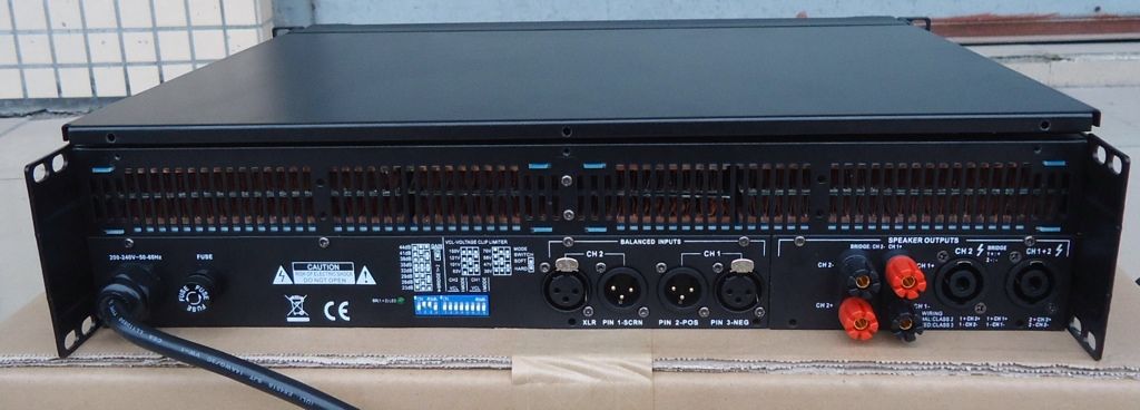

In the mean time, can you post a pic (if it's not too much trouble) of the back of your current clone? I know it's a hell of a good product, but to bide my time I'd like to study it vs. the original.

Here ya go bro!
I originally wasn't planning on adding the next pair till the end of summer, but we'll see how it goes.
Cabs should be here end of next week.

^^ Sorry but where does the receiver connection go?

Into the balanced XLR inputs.
If your AVR doesnt have XLR outputs you'll need an RCA to XLR adapter.

Hey, am I seeing the pic right? Is this a 220V(240V) version?
I saw in not's original post about the clone that it can be specified between 110V or 220V, but I don't have 220 ran to my theater. If it's 220 then why did you specifiy that and what benifit do you see?
I ask because in our next home we have built I will work with my contractors to build a dedicated theater space from the ground up. Just wondering if I should plan for some 220V runs for some heavy duty electrical loads vs using the standard 110V (or "120V"--whatever).

The main benefit of running 220 vs 110 is lower amperage through the power wire and less load on the breaker. Double the voltage, halve the amperage.
Some pro audio gear can run 110-240v. Having 220v available in the HT means you have the option of running that gear at the more efficient higher voltage. I'm no electrician but I've had some experience with 220v gear.
I lived in Europe for awhile and having a water heater and electric stove that plugged into a normal wall outlet with a skinny cord was pretty awesome. We ran a dishwasher, electric kettle and oven off the same breaker. Try that with 110v.
I play bass and I did a few jams while living overseas. A whole FOH amp rack for a 500-person club barely got warm running all night. 220v is the way to go.
That said, I don't know how difficult it would be to source 220v power amps here in the states. I see that this "clone amp" is 220v but I don't know about getting 220v versions from Crown, QSC etc.
Side note: Can someone give me info on that clone amp pictured below? Linkage would be great. Thanks.

My clone is the 110v version. It's running by itself on its own 20amp line with zero problems. I havent tripped a breaker yet, even while running some high SPL low FR sine sweeps. I do plan on having another 20amp line installed when i order the 2nd amp though.
My cabs have some heavy duty binding posts installed. I use banana plugs on both the amp and subwoofer ends. The speaker wire im using is your standard 10ga from Blue Jeans Cable.

Dont give it a 2 ohm workout then :/ The clones are very unstable below 2.3 ohms and youll have a dead amp on your hands pretty quickly. I think after shipping I paid $825 or so for my 14k, so it is still a HECK of a deal.

Do you think the FP14K is stable at 2 ohm? Has anyone tested it? Technically you could wire the VC's of two subs in parallel (1 ohm per sub) then series them together for a 2 ohm load... You would get full utilization of your amp that way, but at the same time it would definitely be working harder. Obviously it would be a bit easier (and cleaner) if you had a setup like not's with two subs per cabinet vs having to do the series wiring externally to the box. You did say you were stacking them though, correct?
I guess when it's all said and done the clone is under $800, so it would be optimal to drop coin to pick up another one. Then again, that $800 might mean the difference between you affording your extra pair of Ultras early summer vs. late summer!
Seems like everything I've researched the Ultras will tap out before the amp. I'd like to hear from someone that gave the amp a through workout. If not you, then I guess I'll have to pioneer the effort when I get mine... =)
3,500 watts per sub (compared to 4400) should still be more than adequate to push the Ultra based on the published specs.
I think Notnyt said the amps will fully drive the LMS at low frequencies without clipping but they are on the verge of clipping in higher frequencies, but he also said it's uncomfortable to be in the room when doing so. I've also seen on his YouTube page that the FP specs out extremely close to (maybe the same as) the real McCoy.
pwz414 is offline
Ok, thanks for weighing in beast.
Agreed! I'm totally fine with it not being 2 ohm stable. That and lack of network capability (firmware updates, etc...) are small compromises to make for a product with comparable power output of the original at roughly 14% of the MSRP!

Like Beast said, 2ohms is a no no.
