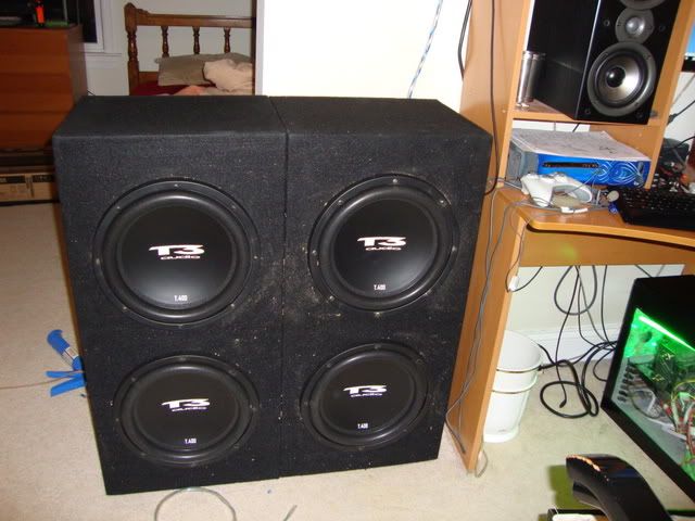

Well I just decided to make my 5.1 theater system bass worthy. I already have a set of Polk Monitor 40s as fronts a nice CS2 center and Monitor 30s as surround. I sold my Klipsch sub 12 to release funds for a nice sub. Ordered the following:
4x T3 Audio T.400 12s (400w rms each)
Behringer EP4000 amp (2400w rms @ 4 ohms) (Not in yet)
MDF (lol) (Box will be sealed 1.5 Cu.Ft per sub)
Here is my set-up as-is:
The subs:
Random AQ amp because my BTL is being reconed
Will update when I get my amp and get started building the enclosure

Too late :P I already ordered the MDF, and I plan on building a tall tower with each sub separately chambered 1.5 cubic feet per sub. I have a quick question, when I look at the manufacturer recommended specs it says the recommended sealed volume is 1 cubic foot. How will having 50% more volume affect the sound? Idk if this will help but here are the available t/s parameters:
*Power handling: 400 watts RMS/800 watts peak *VCdia: 2" *Le: 2.35 mH *Impedance: 4 ohms *Re: 4.25 ohms *Frequency response: 30-1,000 Hz *Fs: 33 Hz *SPL: 88.10 dB 1W/1m *Vas: 1.58 cu. ft. *Qms: 8.52 *Qes: 0.84 *Qts: 0.76 *Xmax: 16.5 mm *Dimensions: Outside diameter: 12.70 in

Also do you guys think these will get low (as in 22-25hz)? I tried to pick the speakers with the highest xmax within my very small budget.
4 of these in a sealed cab will do just over 110db down to 20hz with less than 100 watts. And thats without any room gain. Should be decent.

Well I was trying to enjoy my install when I was interrupted by cops... I guess that's a good sign.
...Haven't gotten a chance to clean the sawdust off yet

Looks great! how do they sound? im really close to pullin the trigger on a few of these.

The sound qualities way better than I expected from car audio subs but then again I may be easily impressed because I am used to car audio SPL subs. Honestly sounds amazing.
