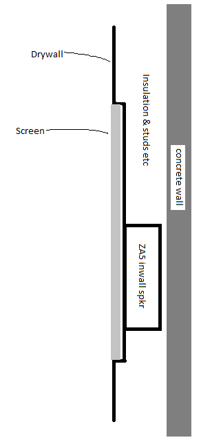

post #6 of 6 Old 04-04-2012, 09:14 AM - Thread Starter
DevonS's Avatar
Location: Regina, SK, Canada
Posts: 593
I completed a spandex AT-ish screen on the weekend, and I gotta say the image is quite impressive. With that out of the way, and the fact that the screen weighs next to nothing, I may tear out the wall and "git 'er done" over the summer. Still planning on using the Zaph ZA5.3 kit.
Now, here's my plan with questions:
I want to flush mount the screen so essentially the screen area will be recessed by about 3/4 inch to make it flush with the rest of the wall. The screen "hole" will be 103" X 58" (118" diagonal) and the speakers will be mounted within/behind this recess.
1) Will this cause any significant baffle-step-somethin's or freqency-null-and-void dealio's? See below for proposed picture.
2) I'm currently running an Onkyo 605 receiver. I'm assuming this receiver should be able to drive these without blowing up, but I know nothing about electrical engineering. Anyone have any additional info?
Looks like this:
