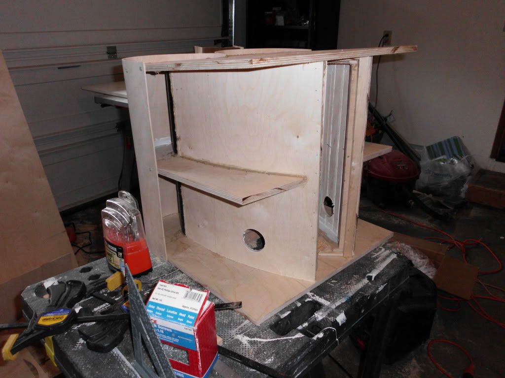

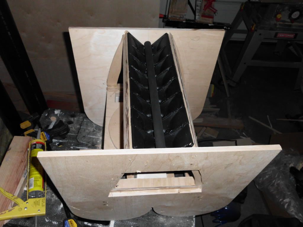

After ripping the 1/2" Baltic Birch down to rough sized pieces, I started on the throat horn. This is the divider. Not sure if you can see, but I had to round over the end.

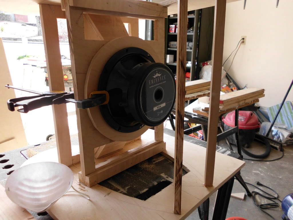

Here I'm beginning the assembly of the throat horn. you need a specific angle on it so the 2x4 you see there has the angle trimmed in one side. Makes it easier to clamp everything together properly.
Here's the throat horn pretty much assembled. If you look close you can see the divider from the first pic in the center.

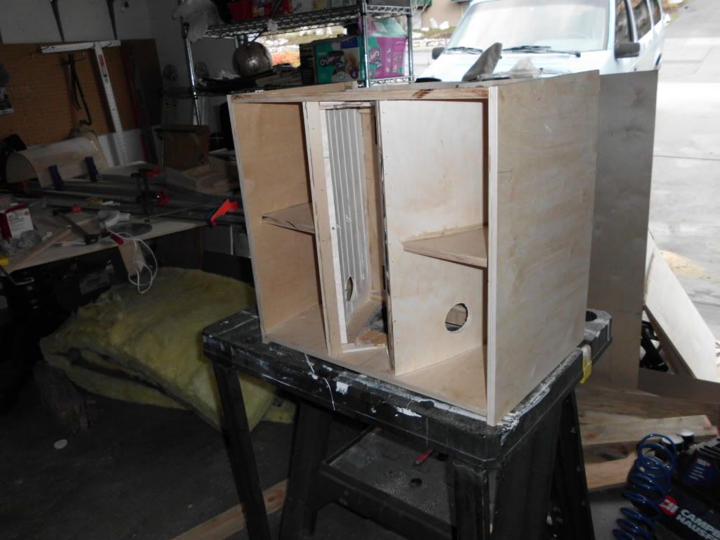

Here it's attached to the woofer baffle and the vents are cut
Another view , with some bracing added for later use.

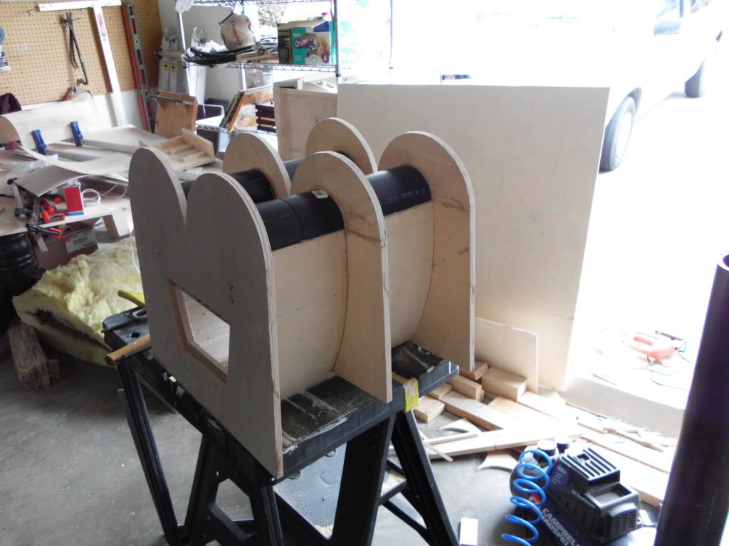

Working on cutting out the semi-circles on a top/bottom piece. This would have been quicker and easier if I'd had a larger circle jig for my router, but the jigsaw made pretty fast work of it.
Attaching the two together. Already cut the driver access in the top. Or is it the bottom?
Top and bottom are both attached now. Starting to take shape!
I have more pics, but I need to upload them from my camera. More to come tomorrow!

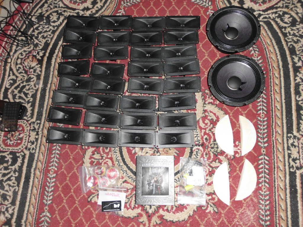

After pricing the components individually, I decided to order two kits from speakerhardware.com. The cost was about the same or less, and it saved me the trouble of ordering from multiple sites. They even caught a mistake I made (I ordered extra parts not realizing they came included with the kit,) and contacted me to double check. Saved me some dough, for which I'm grateful. Game of Thrones was not included, but I figured everyone likes a size reference, no?

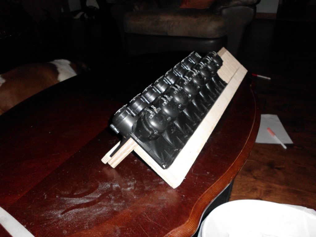

Marking the holes
Gluing up some melded tweeter arrays. The jig really did make it fairly easy.
Tryin' it on for size. Tip-Read the plans. Thoroughly. Then read them again. I definitely could've saved myself some trouble had I been more careful reading the plans. I had to take a chisel to remove some wood so the array would fit. My fault

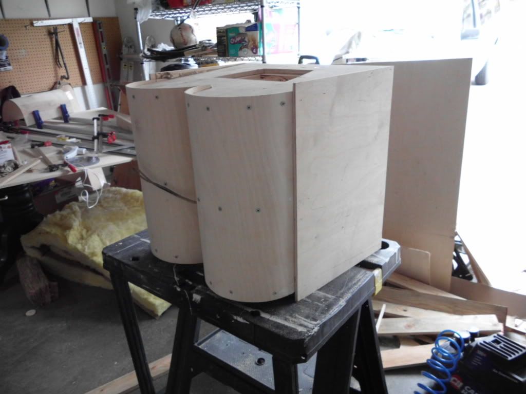

I ended up buying ten feet of 4" pipe because the pre-cut pieces at HD were $11 for two feet. I payed $20 for 10'. Cut them in sections, then cut them lengthwise, then stuck em on there.

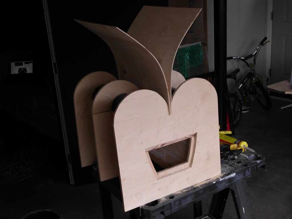

It's got wings! No, I'm just making the butt cheeks You'll see....
Side braces installed and vents cut.
Sides are on. Starting to feel like I'm getting close!
Nice Butt, eh? Told you you'd get a chance to see it.

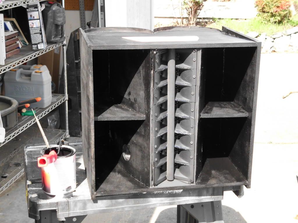

First coat of Rustolium truck bed liner. Hint- Never use this stuff. The smell was so strong, I was getting a little sick from the fumes. And this is outdoors, in my driveway. Then I put it in the garage and went to work. I got home and the whole house smells of the crap. Strongly. Looks like my new baby is going to be spending the night out in the kids' playhouse to air out some....
On the plus side, the finish looks nice I'll snap a pic of it after the fumes die down a bit.
One down.....

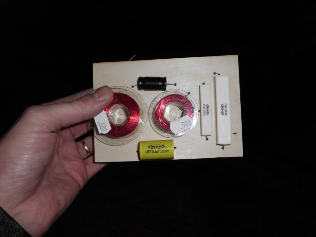

On your crossover board--stand one of your coils up on its edge. You will get a lot of cross-talk between the two if you leave them as they are.

On the next one, can you show more pics of what you do with the tweets? I had no idea that they were set up that way.

PI, thanks for the heads up on the inductors, I'll pull er apart and see if I can pry the hot glue loose.
In the plans, he recommends cutting the cheeks from 1/8" ply and then coiling them and tying them up for a few days. I bent them into a half circle and used some clamps to hold them there. That's how they came to have the pre curved shape you see in the pic
Edit: Another tip- the lumberyard I bought from was out of 1/8" ply, but I noticed that the cover sheet they had protecting the 1/2" BB was in good shape and very flexible. And about 1/8" thick. They just gave it to me. Saved me $18 bucks

Sadly, I already cut all the tweets for the next one with the last batch. I used a jig to cut them, but I feel like I still could have been a bit more accurate with the cuts. I'll be sure to take some pics when I do cut some more, though.
Here's a tip. Pay attention when you cut the piezo's. Not only for safety's sake, but also to keep from cutting too many. I set four aside so I would know not to trim both top and bottom. Bottom two and top two need to be trimmed on one side only so they fit correctly. What I didn't think about, was that I was cutting enough for two DR200's, not one. Oops....should have set eight aside

Duratex is not toxic. It's a water based costing that doesn't give off much for fumes. It's also very durable like truck coating. To minimize the duratex used I always cost the enclosure with flat black paint first and then use the duratex to give the texture.
Good to know. I think next time it'll just be black latex paint. They'll be behind my screen anyway, so no one will see them. I just wanted to try something new.
Ah well, you win some, you lose some.

I recommend DuraTex because it's hands down the best product available that doesn't require professional application. IMO DIY truck bed liner should be left on truck beds. It's just the wrong tool for the job.

Duratex is a great coating to use. Everything others had said is true. Very very little odor. And a little goes a looooong way.
