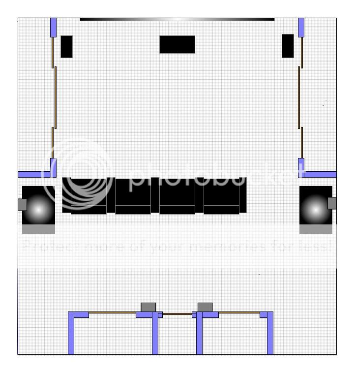

Here's the room layout using iDraw for iPad.It's to scale. A square equals one inch.

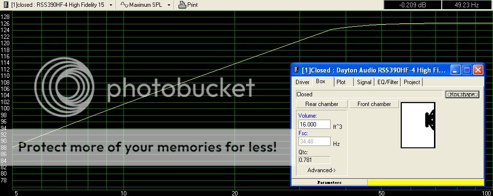

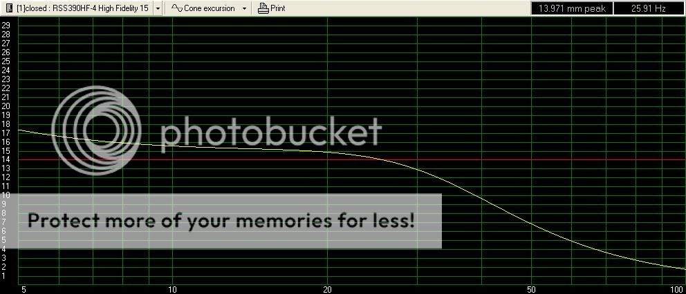

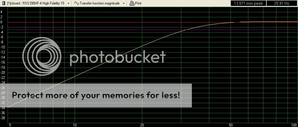

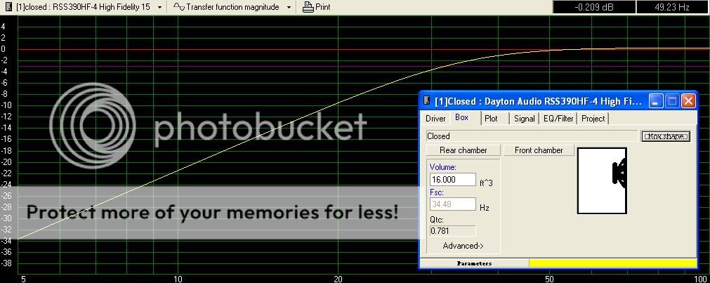

Here's the Winisd file.
coolrda is offline

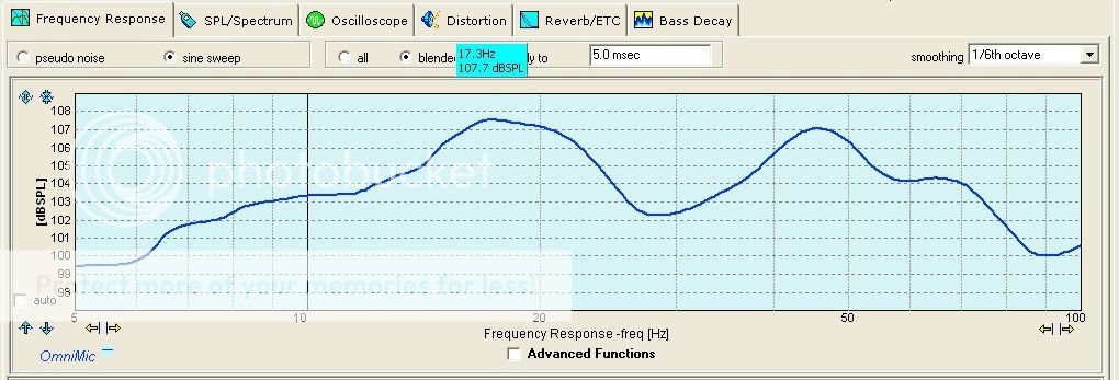

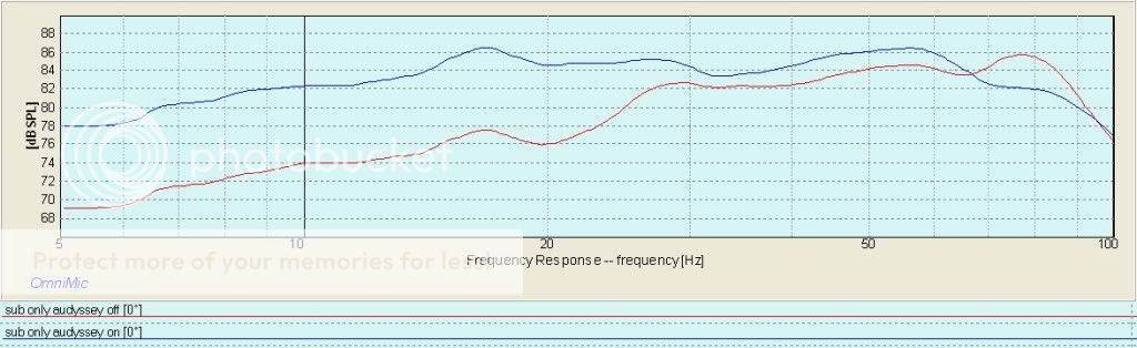

Here's the LP response which is from the middle of the room seat.
coolrda is offline

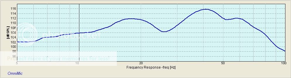

Here's sweeps with all speakers and the subs set at same level as mains. The +5db sweep though clean, was very loud. At this point to go higher to test the limits of the amp/sub combo I will have to raise the sub gain up 10db's or so. The mains were still going strong though. I measured room gain by comparing the Winisd graph against actual in room via the OmniMic and RG starts at +1db@20hz and increases at 10db per octave. It's +11db@10hz and +21db@5hz. Room gain is more than I expected, but I wish it started an octave higher. This is with Audyssey in which it looks like it provides a shelf filter below 20hz.
It looks like Audyssey is boosting your low end 20hz and below by a decent amount. Do you notice any issues when playing back strong ULF movies such as War of the World or How to Train your dragon at or approaching near reference levels?
Bunga99 is offline

Heres a larger OM graph of 5-100hz FR. Will run it up with this test to see what these subs will do. I know I'm taking a hit by not corner loading but as stated above extension and as close to flat response is what I prefer over shear SPL. I'm flat +-2db from 10-80hz and +-4db from 5- 100hz, thanks too a sealed room and a surprising amount of room gain. Shocking actually. At 5hz with the +20db gain its like going from a 100 watt to a 10000 watt amp. And that gain is before any EQing thus it's free db's.

Originally Posted by Bunga99 View Post
They look amazing!
Great Job! I really like the smooth edges, recessed mounted drivers and the choice of finish you used!
I'm just now getting to that part of sub testing. I'm definitely mindful of over excursion at ULF but I'm only putting 300 watts to each driver. While I used to run my sub 3-5db's hot, I run the new subs flat, probably because of the extended ULF. Even with this the subs have to be set at -10.5 in the preamp to match. So even though XT is shelving the subs by 8-9db's below 20hz , I have some headroom. I played Terminator Salvation at the 38-44 min mark while I was playing around with my Omnimic the other night. I had the system set at -7 just try the subs out. I ran the same 5 mins of the movie through 3X just to make sure the drivers where ok as I had 2 drivers that had issues out of the box. The subs where pushing air. I reset the meter and each time the peak read 122.8db. I will try HTTYD and WOTW shortly and post. I also played Titan AE for a friend and that was strong.

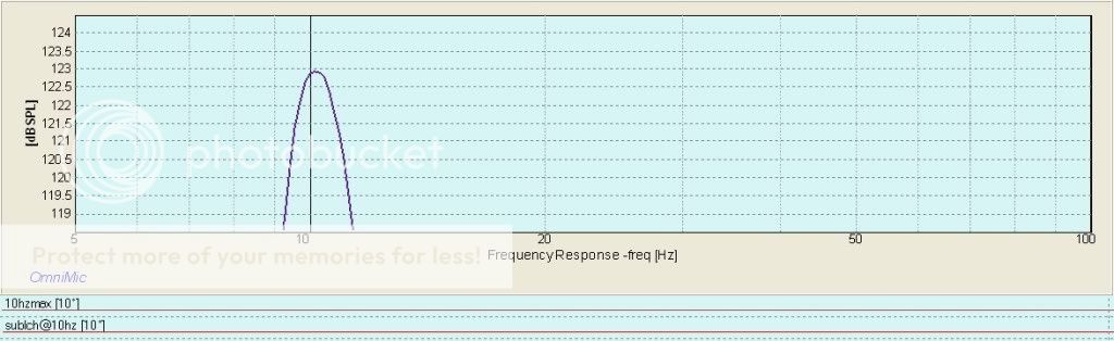

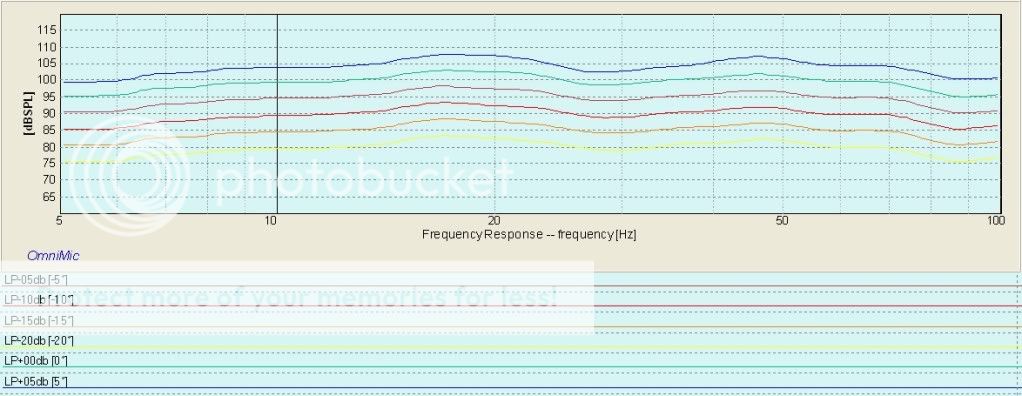

Spent some time this evening running max spl tests. With 315 watts to each driver the amps were the limiting factor as I had no weird sounds coming from the drivers. The first graph when compared to my previous curve shows a gain of 4db's above 15hz, but gain drops at about 15 until at 5hz it's only up 2db's. Drivers never made any metallic noises or sounds but just stopped increasing in volume.
The next second set of graphs are with the +10db LFE ch only. For this test I ran a narrow band continuous 10-second sine wave at 10hz & 17hz. For these tests I turned up the volume until there was no more gain. The 17hz used 1/24 oct smoothing and the 10hz 1/6 oct just to experiment with it.
Tomorrow when I have time I'll start looking at various movie clips. Thanks for the compliments.

"My rooms dimensions are 18ft x 19ft x 8ft."
"I measured room gain by comparing the Winisd graph against actual in room via the OmniMic and RG starts at +1db@20hz and increases at 10db per octave. It's +11db@10hz and +21db@5hz. Room gain is more than I expected, but I wish it started an octave higher."
pressure vessel gain kicks in when the long dimension of the room is less than 1/2 the wavelength at the critical frequency.
long dimension of the room = (H^2 + W^2 + D^2)^0.5 = (8^2 + 19^2 + 18^2)^0.5 = (64+361+324)^0.5 = 749^0.5 = 27.37 ft.
27.37 is the half wavelength, for the full wavelength multiply by 2 = 54.74 ft.
1130(ft./s) / 54.74 ft. = 20.64 (1/s) = 20.64 hz
the theoretical gain is 12db per octave, but that is if you are losing nothing to wall flexing, etc.
so your room is performing pretty much exactly according to theory.
