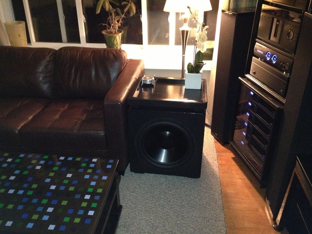

"Give me a nice beefy mounting surface any day."
that looks right at home man!
