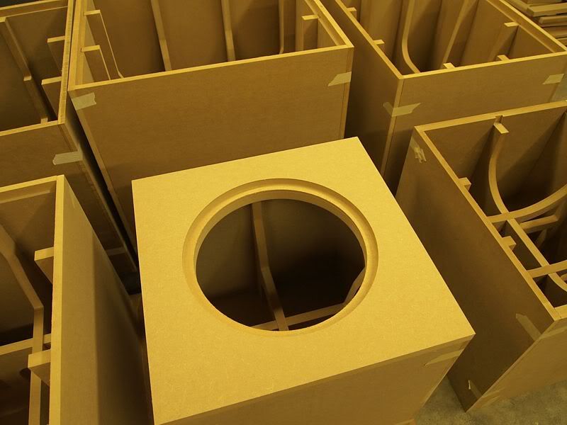

Okay, the new box is on the right. Notice how it was made taller so that the bracing could be shifted closer towards the middle and still leave room for the big magnets. This new design seems to make more sense. The "shelf" for an extra window brace was removed because I'm not sure it's necessary with the new design. Maybe I could put that shelf idea back in the braces so that people have an option to add it if they really wanted to. Let me know what you think.
This photo shows the height difference. Basically the one on the left went from 23x23x20 to the 22x22x22 on the right. The ole switcheroo.

post #131 of 679 Old 05-01-2012, 10:11 PM - Thread Starter
Erich H's Avatar
Location: Cincinnati OH
Posts: 6,954
Mentioned: 136 Post(s)
Tagged: 2 Thread(s)
Quoted: 1406 Post(s)
Liked: 1769
Originally Posted by wth718 View Post
Any chance for a slightly smaller 18 box? Some drivers (lms, uxl) work well in 3.5-4 cubes, depending on the power they're being fed. I know if I get one, that would be the size I need.
There will be a box between 3.5 and 4 cu ft. I figured it would be more used for 15's. I don't have my notebook, so I can't recall the sizes I wrote down. Believe it or not, to get around 3.75 - 4 cu ft would only make the box shrink 1" to a 21" cube versus 22". So it's a very minimal difference and I'd rather just get one or the other made up. I don't care which you guys decide on.
The 22" cube with the double baffle comes in at 4.8 cu ft gross. But after you subtract off bracing, it's closer to 4.5 - 4.6. I'm not sure how much volume those big drivers take up, but I'm guessing the volume the driver sees would be around 4.25?? Any ideas?

I think a 4.5cuft box is just fine. I just ran the sims with an LMS Ultra in 4 and 4.5cuft and the only difference is the smaller 4cuft can handle a whopping 300 watts more but even with the less wattage the spl is virtually the same due to the slight increase in efficiency with the 4.5cuft box. The box Q goes from .597 to .576, essentially the same thing.
If there is going to be an outer baffle than a 21" cube would only have about 1 1/8" on the sides because of the LMS Ultra's 18.52" outside diameter. With a roundover that is cutting it close and you might run into shipping damage as 1 1/8" MDF is not hard to snap. Not like an extra 1/2" each side is a lot but it should be a little more sturdy.
mjaudio is offline
post #135 of 679 Old 05-02-2012, 12:23 AM
mjaudio's Avatar
Location: Fontana, CA
Posts: 2,571
Quoted: 39 Post(s)
Liked: 75
I would have to guess the LMS Ultra takes up about .50ft3, it's gotta be pretty close to that.

If that's the case, then the 22" cube should give about 4.25 cu ft net for the LMS and other big 18" drivers.
If anyone wants to be the guinea pig and try one out, let me know.
Besides the current shape for the other subwoofer boxes, I'll try to get some regular cubes for the 12" and 15" models by the end of the week.

I want to get 2 more prototypes done, then get a price for each one. Reason being that the enclosures that need part of an extra sheet could have the rest of the sheet used for a 10" enclosure. So that will likely change prices and keep them lower. I want to make sure everything is accurate before putting out the numbers.
The 19.5" cube should be done tomorrow. With the double baffle and the same cross braces as the larger 22" cube, it should be right at 3 cu ft net volume.

Okay, here's photos of the first 7 prototypes along with the 2 new ones I said I'd get taped up today. I had to get up on a ladder for this photo.
The first 2 on the top are about 4.25 and 4.5 cu ft net volume. The 3rd one on the top is about 3.5 net. Middle row: First and second were taped up today. 3 cu ft and 2 cu ft net. Next is 2.5 cu ft. The bottom one is 1.25 cu ft net.
I like this following one a lot. Not extremely heavy, but very strong. It's a 3 cu ft cube. Outer dimensions are 19.5" with a double baffle. Taped up in less than 5 minutes.
Here's the 2 cu ft cube. 17.5" with a double baffle:
Here's the double baffle on the 2 cf. THERE WILL BE ROUNDOVERS This one has the driver recessed only .5", so there's a full 1" behind the frame.
I dropped in a Dayton 12" driver to see how it looked.
