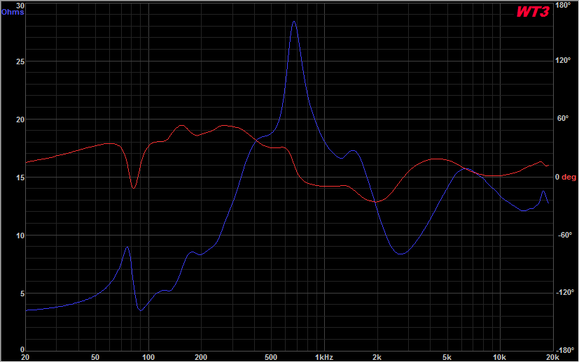

I have been meaning to dig these out for a while and finally did get to them the past month or so. They had been sitting for about two years half pulled apart while I was deciding what I would do with them go active/passive hybrid but finally decided I did not want to go through the hassle of setting them up active with 4 amps channels with an external DSP and preamp every time I do go to listen to them since these are not going to be permanently setup anywhere. So I decided to go in and redesign the full passive crossover.
In case you did not read through the thread the woofers on these were some 10" buyouts from PE that cost $5, the final configuration had them in a 4th order band pass situated towards the back of the enclosure firing into up/down into a sealed chamber in the center that housed the mids and CD. The front chamber was large enough and tuned low enough (105hz) to get the benefit of the acoustic low pass down into the woofer's pass band. You can see some pictures of how it looks back on post #82 : The very low budget DIY synergy horn build
Well I decided to try out a pair of Dayton PA255-8's I had laying around instead as I was afraid of cooking the little 1" VC on those buyout woofers. They worked out a little better then the buyouts so I ordered up another pair for the second speaker and went ahead with the crossover design. I had a tough time getting the drivers to blend well as there is very little if any overlap between the woofers/mids and mids/hf. I also ran into a problem with conventional crossover design causing the impedance to dip severely try the cross the woofers at 250hz to the mids. After a few iterations I finally managed a crossover that is very efficient across the board and utilizes the woofers impedance peak to gain 3dB more output at that range. I believe final sensitivity is roughly 100dB at 80hz with 2.83v input 4pi! The pair of 10" woofers in the band pass configuration should be capable of nearly 130dB above 90hz where they are not excursion limited, about 127dB at 80hz. Average impedance above 250hz is about 12 ohms, minimum of 3.5 ohms at 90hz:
Here is a quick FR measurement I did indoors at about 1.5m, 1/24th octave smoothing:
Dynamics in the midrange and midbass are insane, even off an old low end AVR.
I'll have to get a few photos of the guts and show you guys the crazy crossover, most parts I have ever used in a design. Had to assemble parts of the crossover inside the enclosure because I could not fit a prebuilt board anywhere even if split in three.

Besides the patent issue I feel something like this would be quite difficult to do in flat pack form, one mistake while gluing it up and the rest won't go together. Just gluing the horn together can be quite difficult. I don't even know how many separate pieces my enclosures have, I think it is around 40. Over 110 screws in each as well and that's just for access panels and drivers.
Then you have the crossover, a bit more complex then most regular speaker designs:
Here are a couple shots with the new woofers:

Ok, mtg, I'm impressed. Nice frequency response on those!
So, how come you're not using them for your main system?
BTW, I talked to Erich about selling flatpacks for just a wooden conical horn (without the Synergy ports), that could be used either for single driver or as basis for a Synergy. Suprisingly, he doesn't seem to have any spare time to be taking on anything else!

Thanks Bill,
If I could find a way to use these in my main system they would be used there. Unfortunately I am somewhat limited in the size of the speakers I can use so theses will just have to sit off to the side and get pulled out whenever I want to have a listen to them.
Any chance for a flat phase response on these went out the window when I decided to move the woofers back into the cabinet. Making that a low tuned (105hz) 4th order band pass does some nice things with filtering out harmonic distortion and reducing woofer excursion but it added a lot of delay. I believe there is >1080 degrees of phase shift in the design however it still sounds great to my ears. BTW if anyone is in the Chicagoland area and wants a demo give me a holler.
I am going to try making a DIY budget synergy V3. This one will use all off the shelf drivers while staying very affordable. It will be fairly compact as well, ~16-18" wide and high maybe 13-16" deep. Dual 8" woofers, two 4" mids, 1" CD. Should be capable of 120+ dB, f3 about 80hz, ~98-99dB @ 2.83v. I plan on making it similar to the one above with the 4th order band pass woofers. I need to build a simple horn and do some testing of the mids to figure out if they will cover the required pass band before I go further with it. If everything goes well I try and document the build so that others can replicate it, that is one of the reasons for choosing off the shelf drivers. If they turn out well I'll build three and use them for my LCR.
