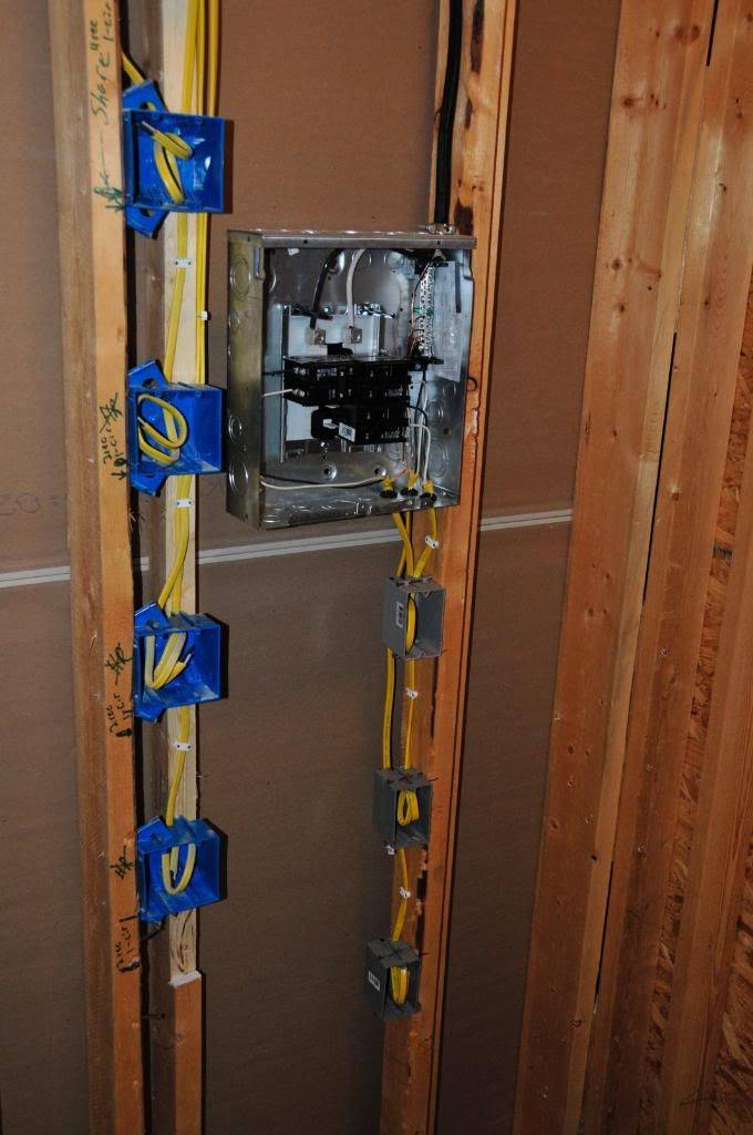

I hope you have a dual-leg 100amp 120v service because 4 of them (2x2) will draw somewhere between 20-60amps per leg RMS and with peaks up to 150amps per leg.
i.e 40-120amps continous and 300amps total peak.
Your power bill will be at least $100 higher per month, I guarantee it.
A 120/20amp circuit breaker trips at 2 channels of 1200watts RMS after about 5 seconds duty.
A 120/30amp circuit breaker trips at 2 channels of 1800watts RMS after about 5 seconds duty.
For 240v double it.
If you're not popping them then you are not exceeding those watts long term PERIOD.
The 2 channels of 4400watts is burst-power folks, not RMS.
The REAL (not cloned) LG14K, PS10K, IT8K/12K etc etc; none of these amps will sustain the long-term RMS values you guys are talking about, they all engage limiters to keep the power transistors from melting.
Even then I'm ALMOST CERTAIN you will give up before 8x21's and 4x14K's will or at least your house or wife will... and you can take that to the bank!

Its 3 220v 10000s for 10 21s in 7cuft cabs. It was 8 until matched medium enclosures with medium power so added the other 2 malx 21s to match.
As far as electrical I am ignorant but paid the power company to run a 400 amp service and had the electricians run #6 to the media closet for 3 20amp 220v lines along with a bunch of 110v dedicated circuits. Heres the closet
As far as the room handling it, everything is glued and screwed, 4 troughs in ceiling on joists, and over 10x the amount of drywall screws. I built it from ground up knowing what was going in it. Handling the pressure isnt a big deal it wont be nearly as loud as vehicles.

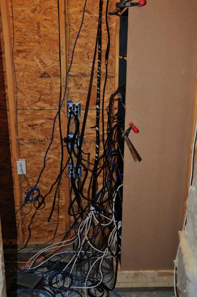

That is awesome!!!!!!!!!!!!! I had to get a second 200A service installed but it's fairly far away from my HT area. Thats is the way to go.
Yeah they screwed up 3 times when I was changing my service. First time they showed up and asked me why they were sent.
Second time my electrician was here to meet them and they approved the wrong meter base.
Third time they werent prepared to pull the new 400 amp line. Only had one truck. Then told me they were gonna disconnect my power if didnt change meter base to the ones they like to use because they were switching over. My neighbors have the same base I had to pay my electrician to install, uninstall and buy the other one.
It was one big fiasco. Oh well, I now have the power I need. It could get hairy when all three AC units are running along with all the pool stuff and theater eek!!!! Lets hope not but possible. I do have 9 dedicated circuits in the closet for the theater tho so I'll always be able to have audio even if have to turn off the AC in the main house lol
I just finished putting the bottom of the 4 sub enclosure on and now have the back and sides to go along with a few more braces.
